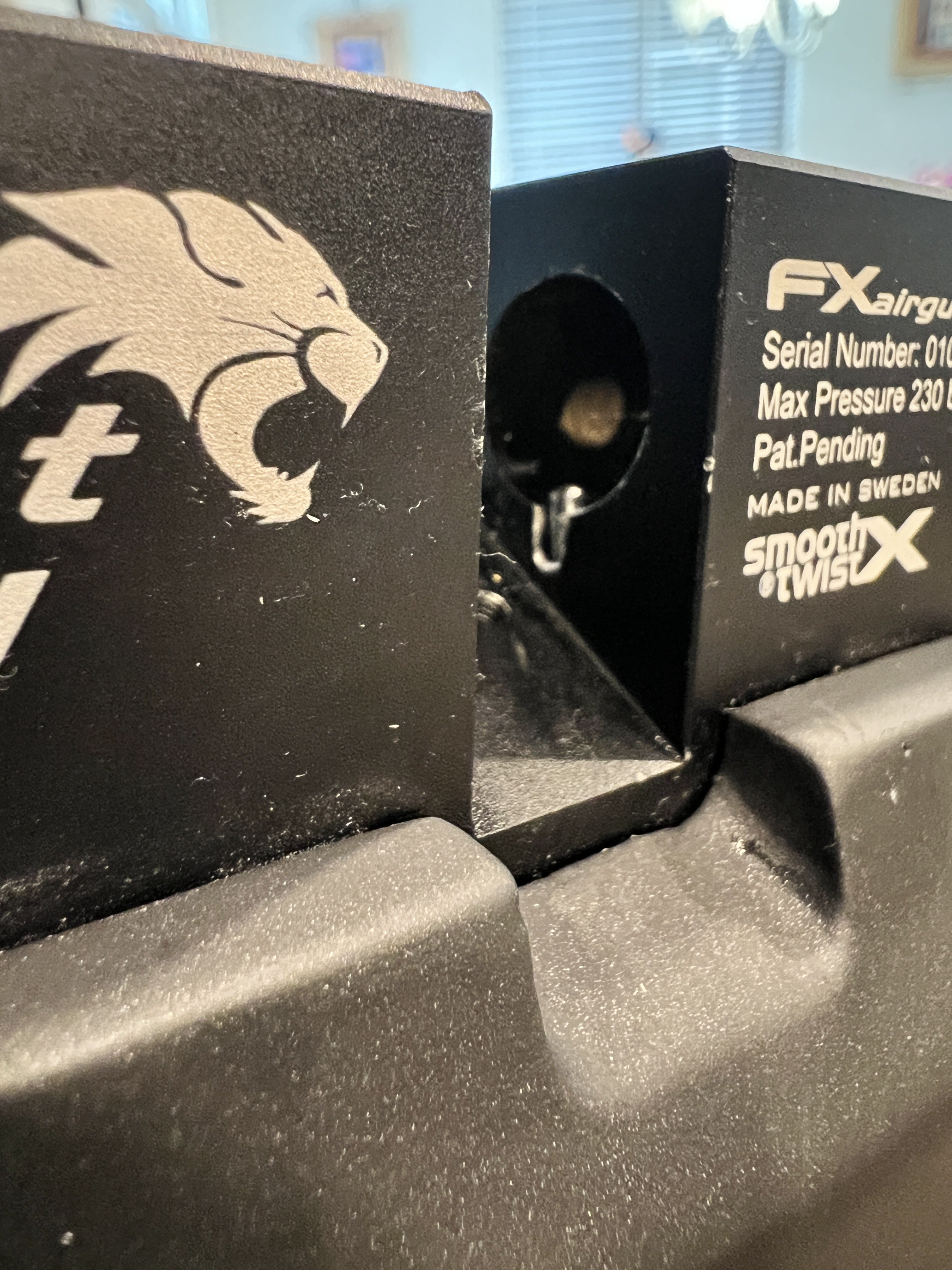

Makes me wonder if the barrel lock grub screws were even first loosened to initially remove the barrel, lol
What’s scary is this may end up on day in the classifieds!
With the damage to the receiver.. Tearing out the indexing Pin....
a single Grub-screw wouldn't stop the barrel movement with that pounding.
But maybe with a little modifications....
I went the route of Ernest Rowe... using 2 Grub-screws to secure the barrel for Tensioning....
But I also cut a groove for the grub-screw to sit in.
Also I can crank the Screws down without the fear of boogering the barrel extension up.
But even with these mods..... I am not sure it would hold up to a 5 lb sledge hammer!!

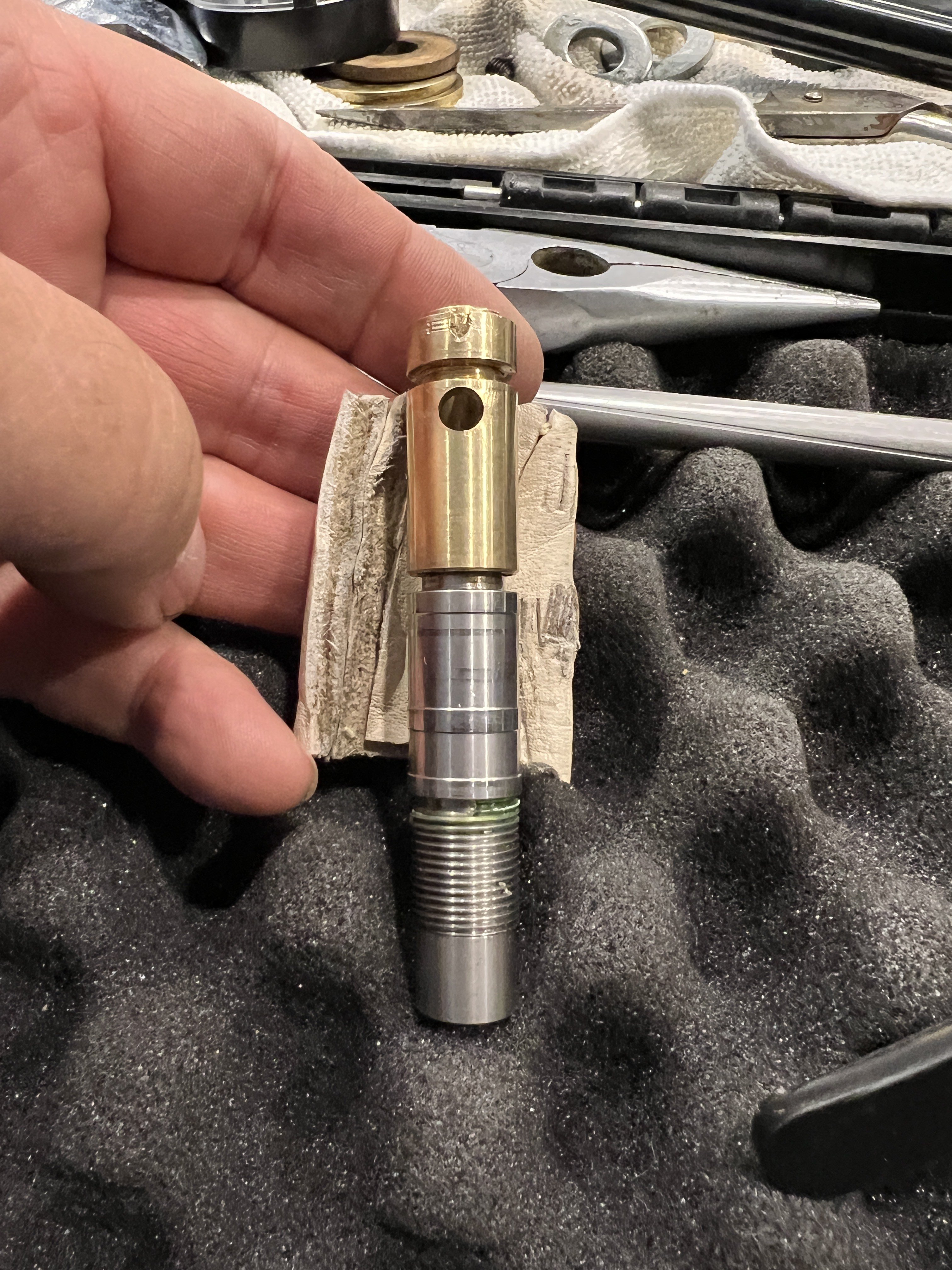

Ok, I have the parts coming. My only concern now is the orientation of the transfer port. I got the pin in its slot but I'm not sure if it is going to stay when I push the barrel through. I thought about trying to JB weld it in place with a toothpick or something but don't want to mess it up. If someone could take a picture of how far the transfer port sticks in the block, I think I can get it to work. Any help on this would be greatly appreciated.
Thanks again, Bob
Reactions: Ignoto
FX does use high strength Loctite..Green..
It will need a little heat!
Using a glove to hold silver barrel extension, apply heat to the brass transfer port.
Once it start to smoke a little.... but it in a vice..
Use a punch in the Round transfer port and turn it off..
The brass transfer port is internally threaded FYI.....
Thank you I did get it off. I called the guys at UA and they said to just use some blue loctite and I should be fine
