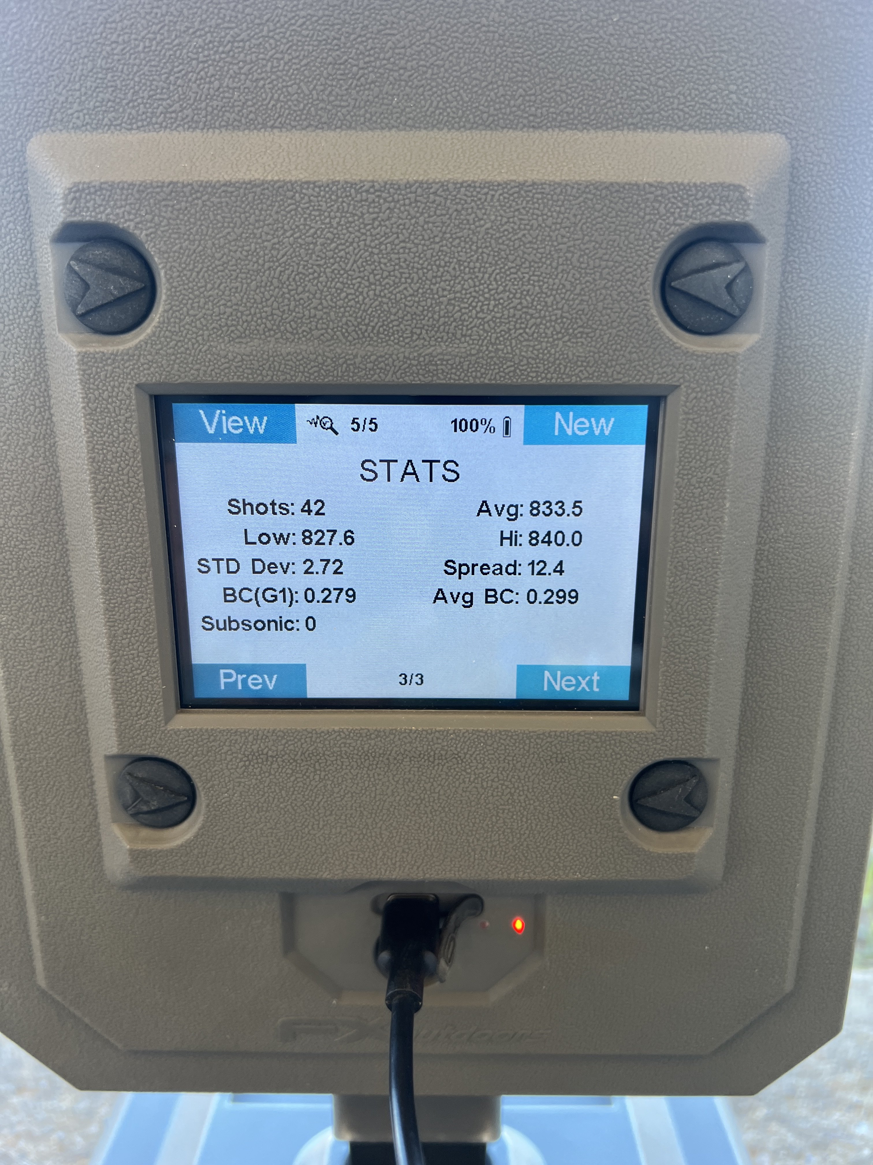

I have a Netvor that I got from Tony at @Talon Tunes and it is very consistent and very accurate truly an awesome BB! I’m shooting Zan 285gr slugs. No pictures of groups at the moment. I am not sure about the Valve as I have not opened it up. But these were my numbers a few weeks ago.

Man life has been absolutely crazy since getting it so I have maybe a 150 rounds through it since getting it from @Talon Tunes. It LOVES Zans 285 grain which is my preferred slugs out the box flying 835 fps for around 6-7 shots on an 300 bar fill. Over 42 shots I got SD of 2.72 and ES of 12 which is awesome for a BB it was really accurate with a BC in the 0.280 G1. The trigger is awesome and I really like it. I had a very minor problem with the pellet prob oring blowing every 15 shots or so that was easily fixed with adjusting how far the prob seats in the bore. Once that was fixed @zx10wall worked his magic with the wealth of AGT knowledge quickly taking the gun apart and bumping up the reg another 10-20 bar. This resulted in a speed increase of 850 fps accuracy was even better than at 835 originally. We were at @AirNGasman house for a EFT event and I took aim at a steel plate he had at 83 yard I hit right where I wanted but it hit that plate so hard it uprooted the stand and threw it back a couple feet. Derrick and I went out to survey the damage and put the target back up. We put a big ol dent in that thing and said yep we’re done for the night. Ron’s still probably hammering that target back out. 😂 we went in to apologize and put the gun away. That was in December just to give you a idea on how long it’s been since I shot it. Went out to check on it just last night and still holding right where I left it air wise. Derrick will have the gun next week and doing some prep for RMAC. He is going to be working some more of his magic on it to squeeze a little more power to get the 285 grains going hopefully 880-890 fps. It really is a awesome gun and can’t wait to shoot it some more.
