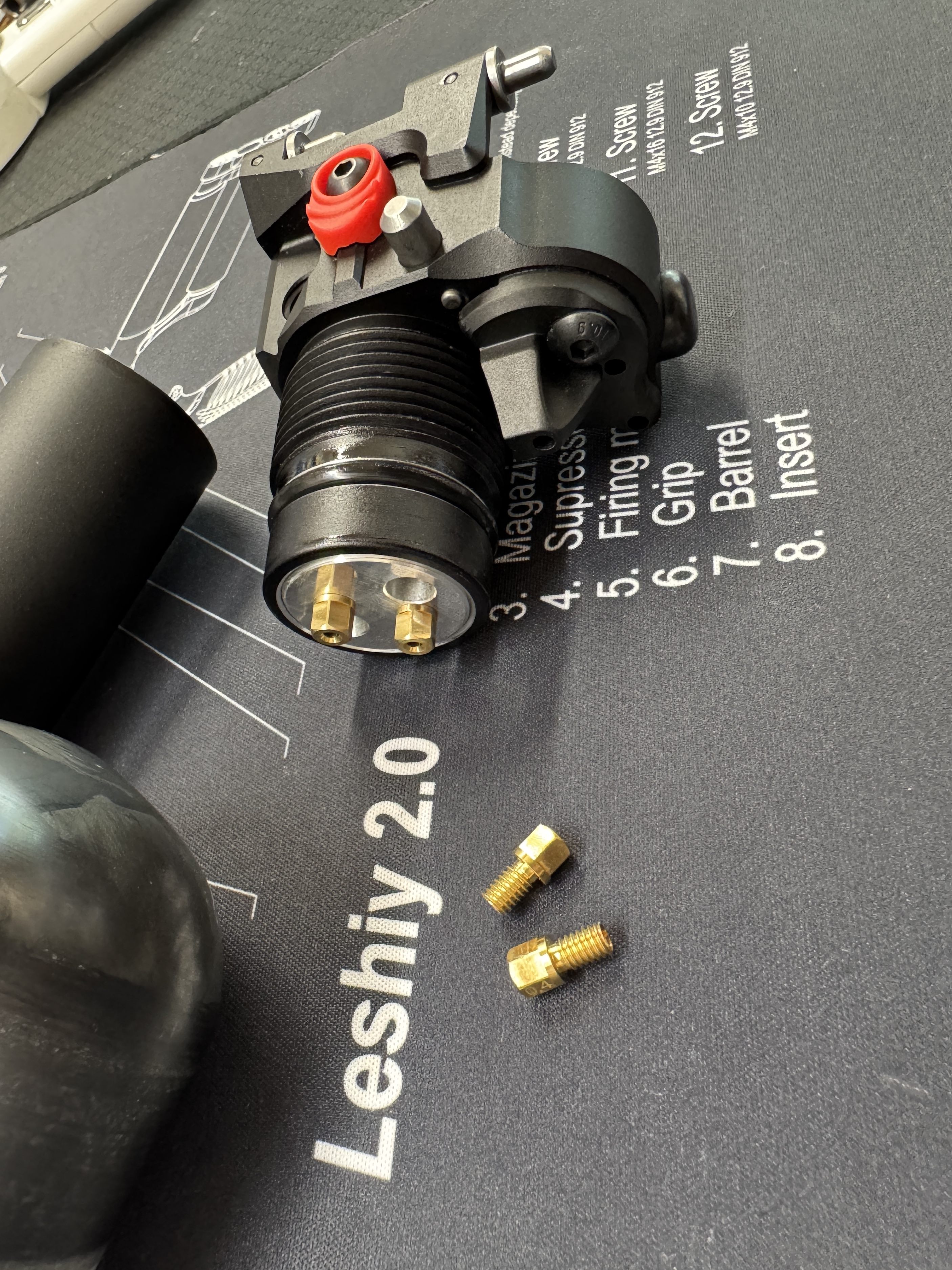

I'm shooting .22 25g Hades Monsters at 865 FPS and the AEA 22g at 900 FPS with great accuracy!
Was contemplating getting the external reg for a while but seeing as my first gen has has zero problems. I’m going to leave it be. I did swap jets just a few days ago and now getting better efficiency, it’s quieter and lost zero FPS even though the jets went up in size.

What caliber, size Jets, reg pressure, and velocity are you running?
25 cal, 350mm barrel, 130 bar regulator, 2 x .8 jets and a 480cc bottle. That gets me 840 FPS shooting 25.4 kings . I’m gonna say 8 mags on the regulator. But that’s just a guess. I also have a 500 mm original smooth twist barrel that adds another 80 to 90 fps although it’s not used much. I would do a full string but with the price of pellets these days, you know the rest. I really need to cast up some ammo soon. Just haven’t been feel motivated as we’re still winter here.
That confirms what I’ve been told. That the L2 was designed as a 30 caliber. Meaning the porting is all 30 caliber. Making the 25 and 30 caliber the most efficient, and 22 caliber the least efficient as the porting needs to be constricted down to 22 caliber. I have to run .4 jets and the reg at 150b to get the same amount of power as your 25.

I decided that the point .4 jets were causing too much low back. I just changed to the .5 jets and I’m shooting the 22 grain pellets at 885 FPS with my reg set at 142. It’s much quieter now.

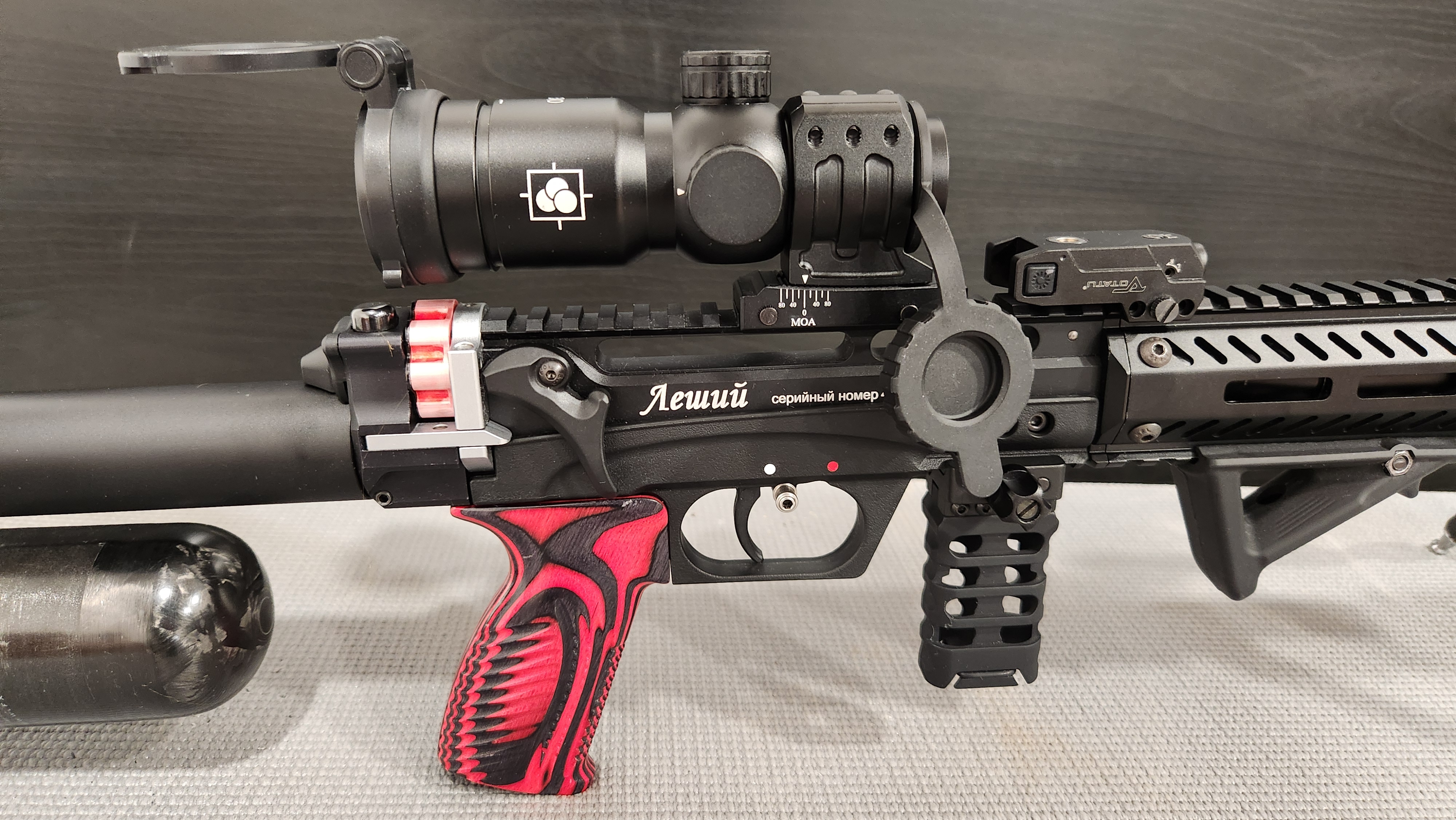

View attachment 554621View attachment 554620

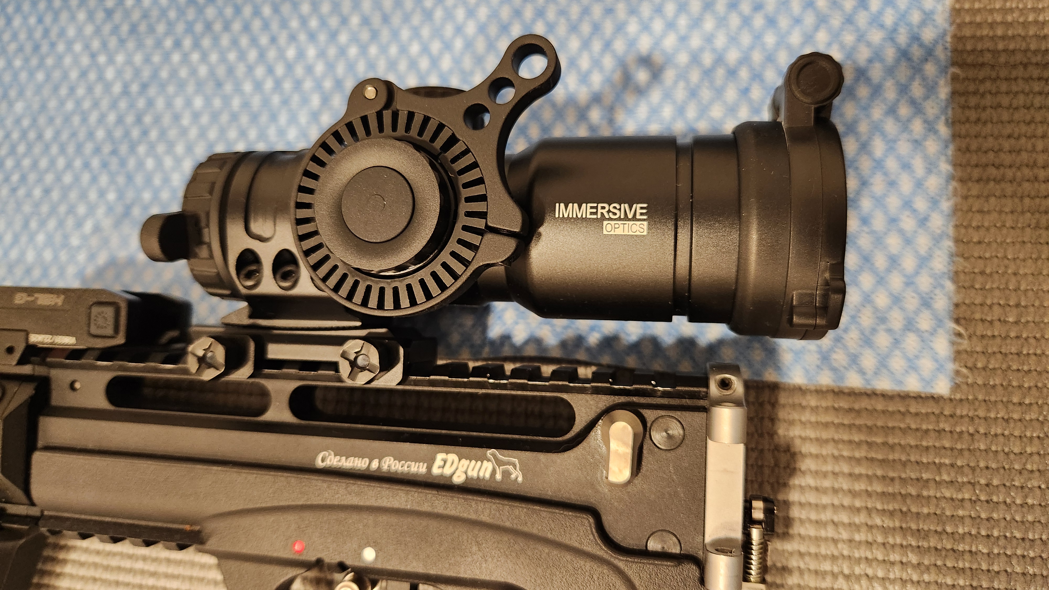

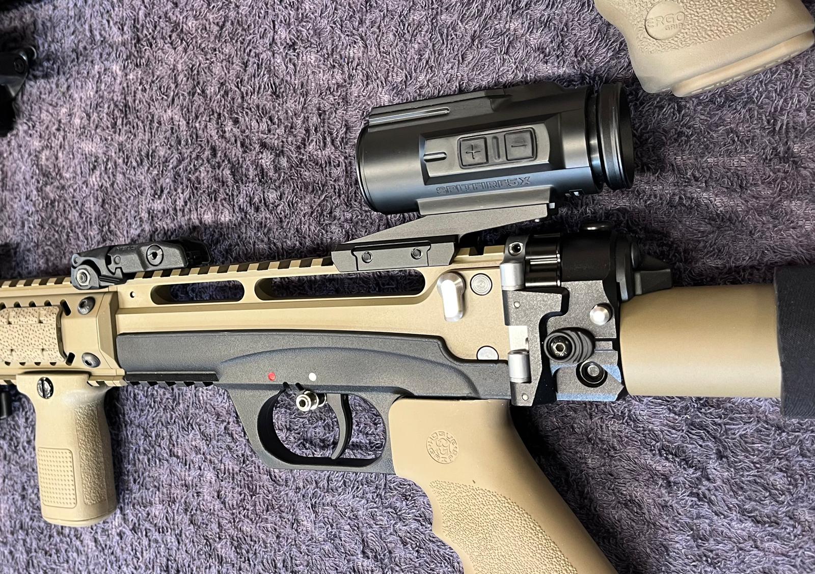

Nice setup! I'm jelly of your Stalker. They were unobtainable by the time I tried to get one. I've run a few different scopes 1-10x, aimpoint and now 3-24x. They're all fun, but this gun really shines (IMO) in light weight configs.
I’m running with a Primary arms 5 x 36 prism. Kinda cobbled together on a QD mount on top of a cantilever. It holds zero just fine even if I take it off. BDC reticle is for .223/.308 PB but with some practice I’ve been able to work with it. Zero at 30 yards I’m good out to 75. Really wanted the Stalker but this is as close as I could find with decent glass and have some eye relief unlike the big magnification prism sights.
Reactions: Michael
The eye relief - I feel the pain I've been there. I tried many frankenstein mounts available on the market.
But have you ever thought about, it is not a problem with the "short" upper rail but with the LOP is way too long? You can get a creek in the neck reaching to eye box.
Back in time I almost bought the shorter air tube from Spain, but the shipping cost to Canada was a deal killer. So I ended up sourcing a re-cut to my local CNC lathe shop. I see the EU prices skyrocketed lately. Not sure, maybe worth to ask Brian at EdgunWest he may have these as well?
I shortened the air tube for 40 mm (was 135mm and now 95mm) and the LOP now is just perfect, Also the scope is mounted much more friendly.
