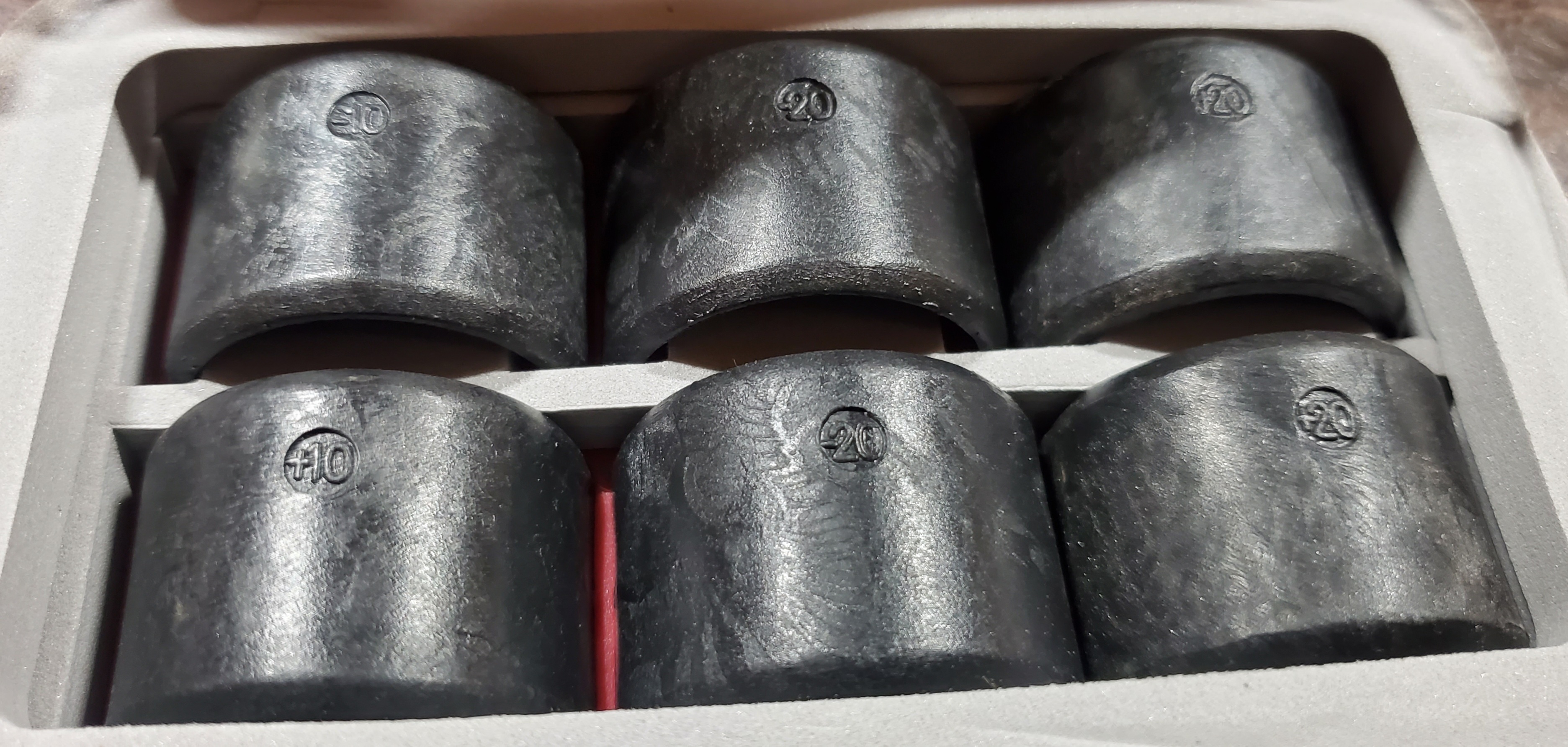

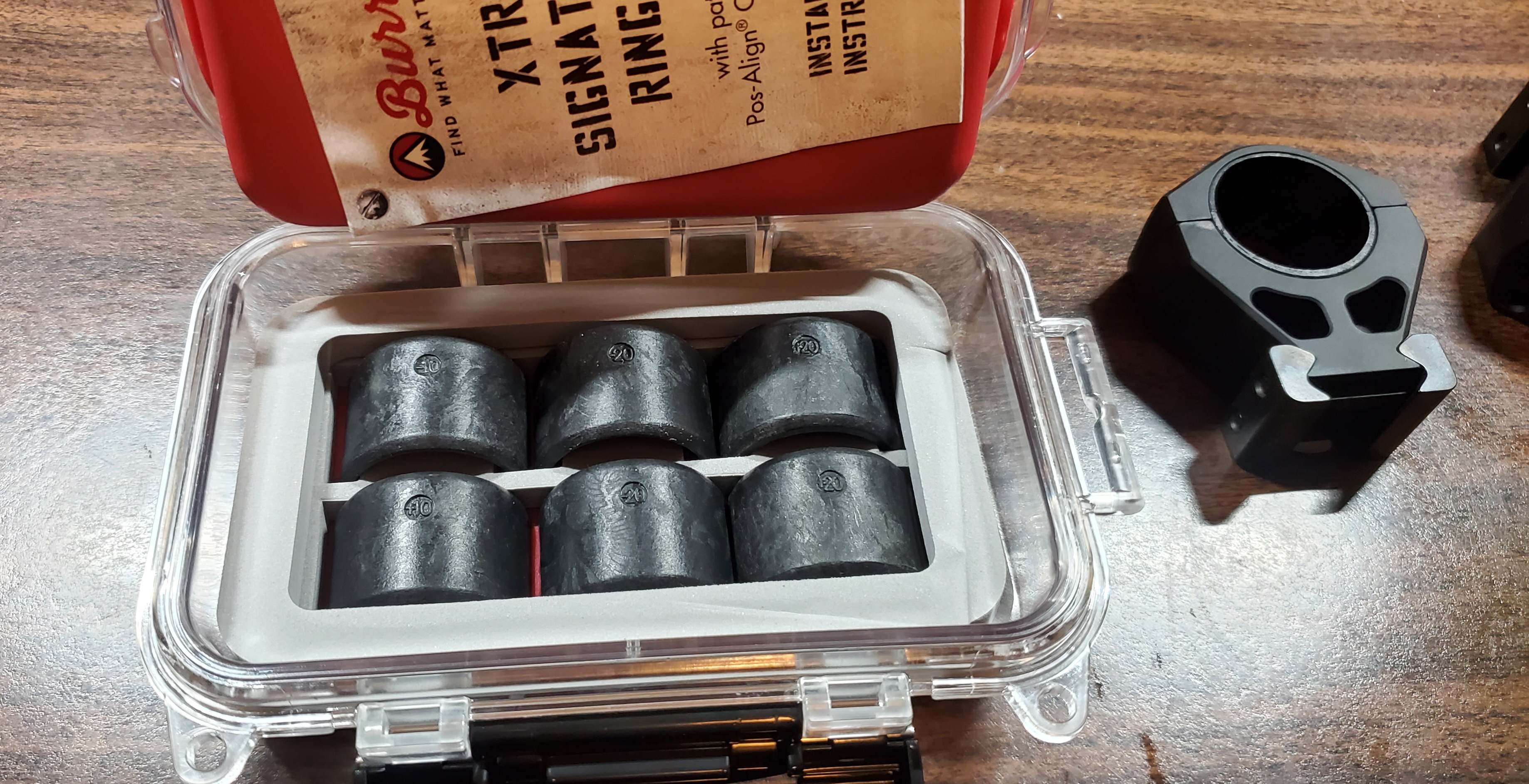

Good buddy who is thinning his herd of shooting gear gave me a couple sets .... When placing the 1.25" 30mm set onto my vintage .25 WAR Flex it became obvious just how special these ring sets are. Being the inserts Float within the top/bottom ( Main ring & cap ) and the kit comes with 4 various MOA off set inserts allowing PLUS or MINUS 10 to 40 MOA angle correction.
It can be in vertical plane ( Elevation ), Horizontal plane ( Windage ) or any combo in an orbital correction pending insert and where & how placed . Genius !!!
For whatever reason the WAR always shot LEFT on a centered scope & some scopes internally went near adjustment limits in correction.
So with these BURRIS XTR's we place the "0" insert in front position and a +20 moa in the rear having ocular being raised from level. Then put a slight CW rotation on rear insert which moves the scopes Objective to the left slightly, Ocular right. Tighten it down reticle level to bore and go and sight back in ... The windage correction while not perfect was very close so left it alone & turret adjusting it in. With 20 moa of elevation of course it was shooting WAY high which was adjusted to the lower 3rd of range on turret. Now we have more vertical we can dial in for long distance work ... winner winner !!

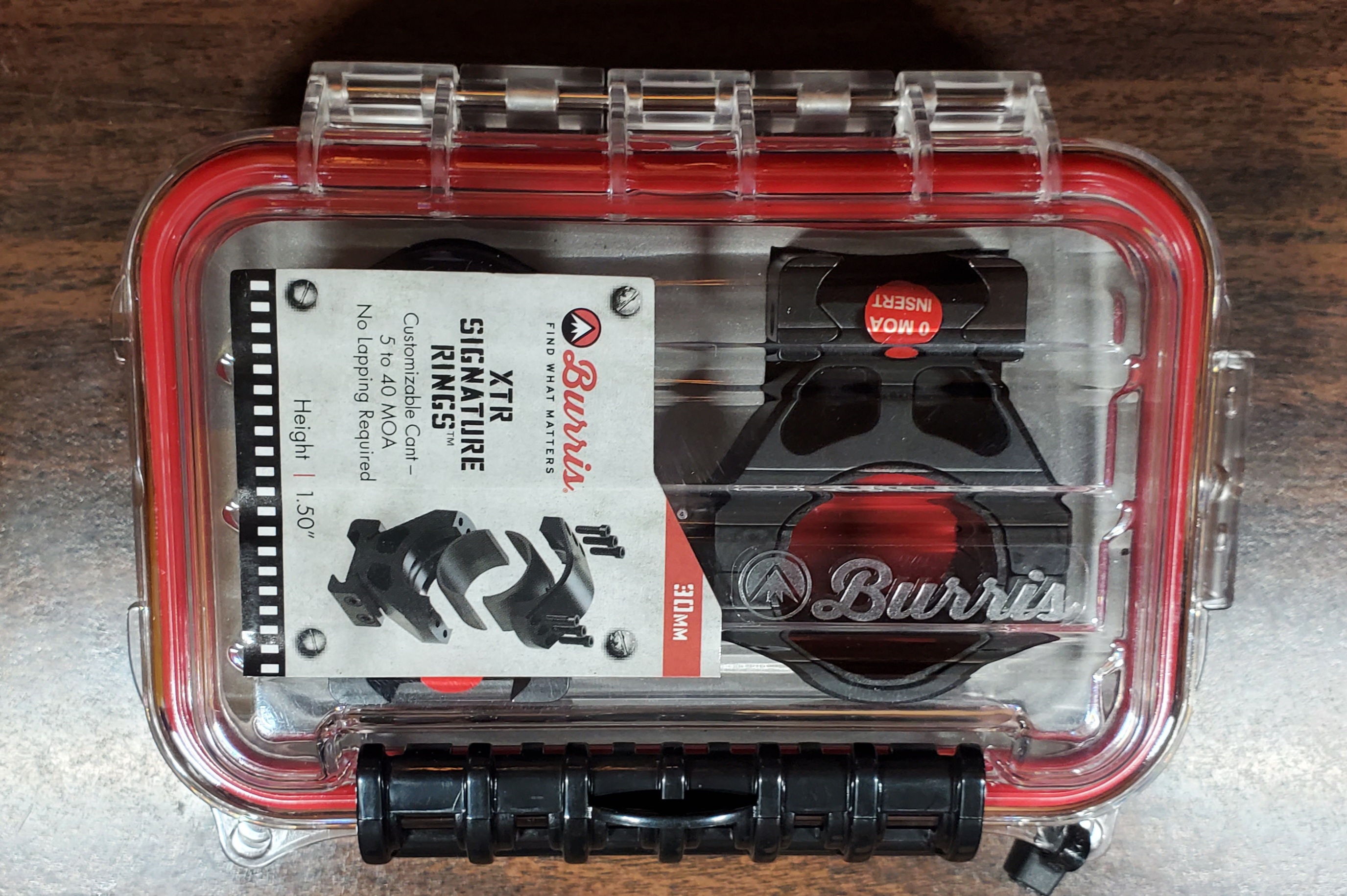

When you purchase a set, the rings come with the various inserts, no extra.
They only come in Picatinny. They also are available in 1", 1.25" and 1.5" heights. 1", 30, and 34mm too. Three screws hold the top and bottom together, very solid.

PIC only and come in pairs w/ inserts all packaged in a plastic plano dry box

They are the best rings around IMO. All scopes are best optically when centered in their adjustment range, the more expensive the better they do off center, but even 5k dollar scopes are affected, cheap scopes can truly suck when even halfway through their adjustment range. On all my new PB rifles, which I stopped buying any more nearly 2 decades ago, I always mounted a scope with the adjustments centered, and fired the rifle. Any that were off by more than what would be 5 or so inches at 100 yards, I went through all sorts of trouble to adjust mounting systems to get it within that distance before zeroing. Then I found the burris signature rings with inserts, joy. They work exactly as advertised and do not mar scope tubes at all. I have one tack driving rifle that something between the barrel/action/mount point is so wrong, a centered scope will be nearly 1 foot off at 25 yards. The schmidt and bender Zernith I have on that rifle gets into the red indicator on adjustment before you could get half the error dialed, and I doubt it would even have enough adjustment to get there anyway. Only Schmidt and Bender I have, I don't know if all scmidts have the indicator like the Zenith does that shows when you get so far out in adjustment it takes optical quality beyond what they deem good, never saw that on any other rifle scope. That coincided with me discovering those burris rings. A little math and you can get remarkably close setting them up to be done first try, and then do normal zeroing. On that particular rifle it took me two tries to get it close enough, I had screwed up the measurement between the center of the rings and used the outside to outside distance of rings instead of the centers.
... the kit comes with 4 various MOA off set inserts allowing PLUS or MINUS 10 to 40 MOA angle correction.
Not exactly true, they give the dimensions of the sets, you have to do the math based on the centers of the rings on your mount. If your mounts are close together, the offsets change the aim more than the exact same offset would be with the mounts further apart.

The numbers on the inserts are thousandths of an inch. Gota do the math to find the true MOA offsets.

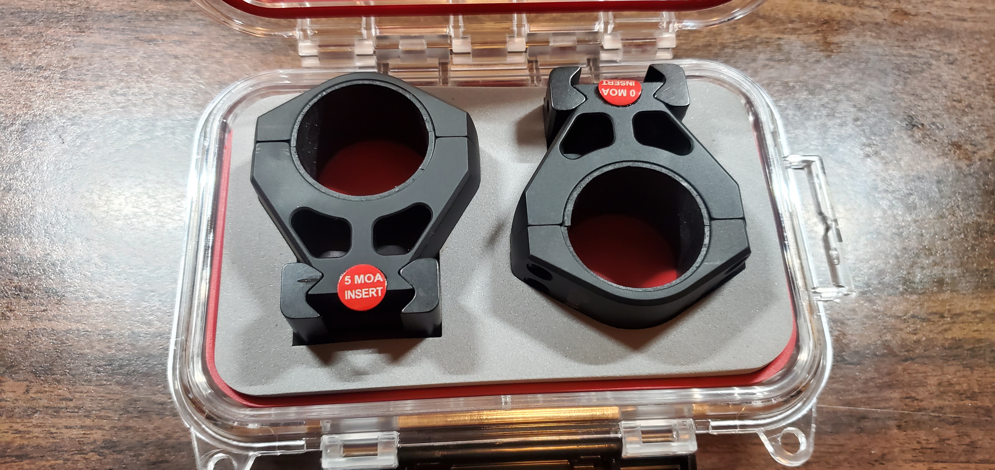

After reading your post I ordered a set of these on amazon (open box) for $45.00.
I found them easy to use and enjoyed a simple 5 MOA. Very happy to try/use something lower than eagle vision Adjustable. Thanks for the tip!
