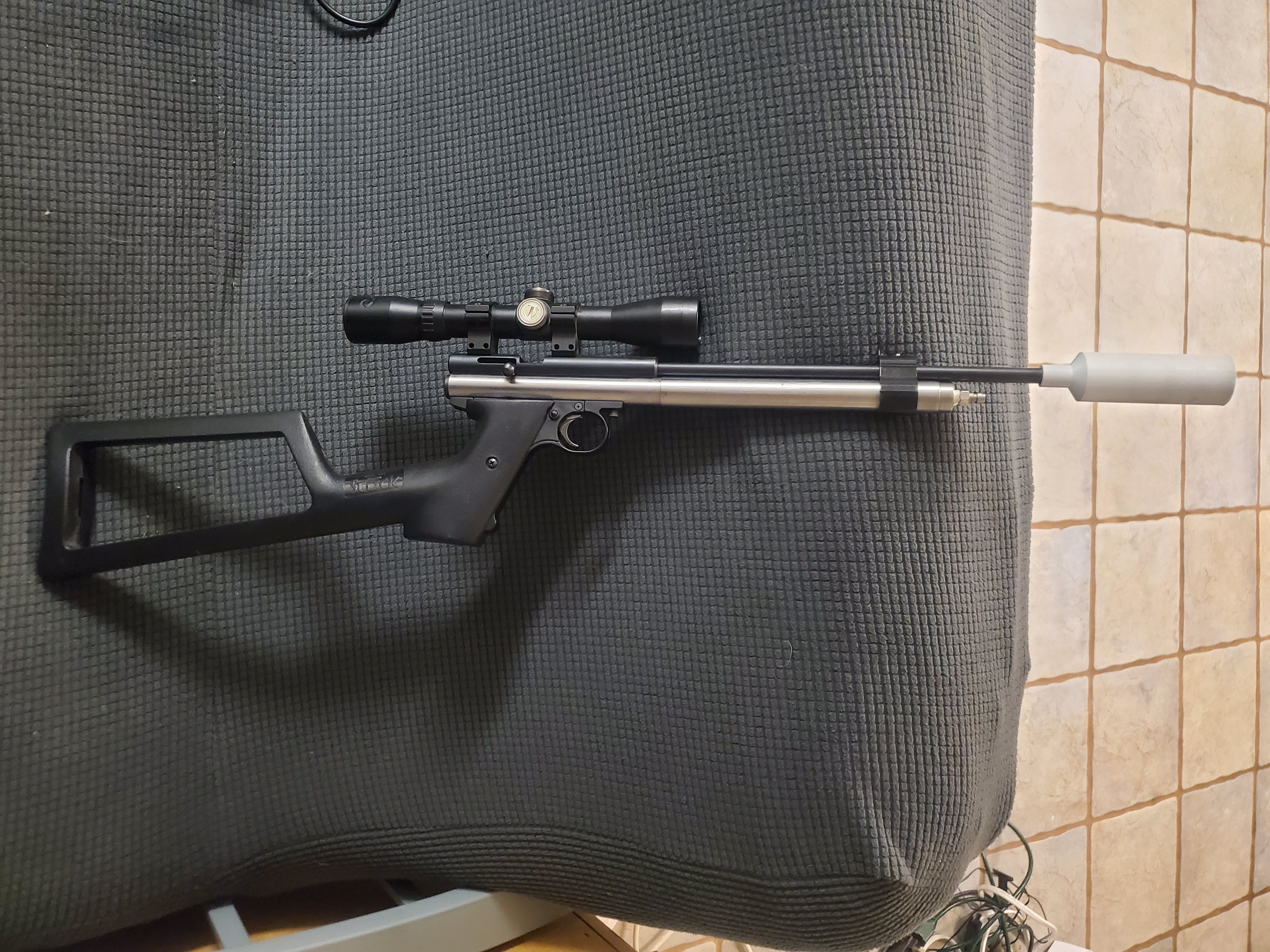

Some of you may remember that I was making and selling these PCP kits to mod your 1377 or 1322. I had sold a bunch on Amazon and ebay but it's hard to make a profit when people will add the cheap Chinese ones to their cart first so I wasn't really able to recoup my time in my list price so I pulled them down.
Anyhow, with the factory valve and an updated valve seal, they will hold way more than 2000psi but thats where I had them rated at because valve lock would occur at anything higher but I just FINALLY got my patent pushed through and now this thing will work just fine with no valve lock at 3500psi using my new patented poppet. I typically keep it at 3250 and I'm pushing 20 grain slugs at 838fps (not bad for 22 caliber.) I don't want to give a descriptor just yet at my patent technology because I plan to sell the valves on ebay. This valve tech will also work on all PCP guns that experience valve lock above their rated pressures so hopefully I'll be able to expand this with other manufacturers in the future.
Pictured is my 1322 with said valve and moderator that I designed and 3d printed (It works really well.)
Power sounds nice, but what's the shot count on that small cylinder?

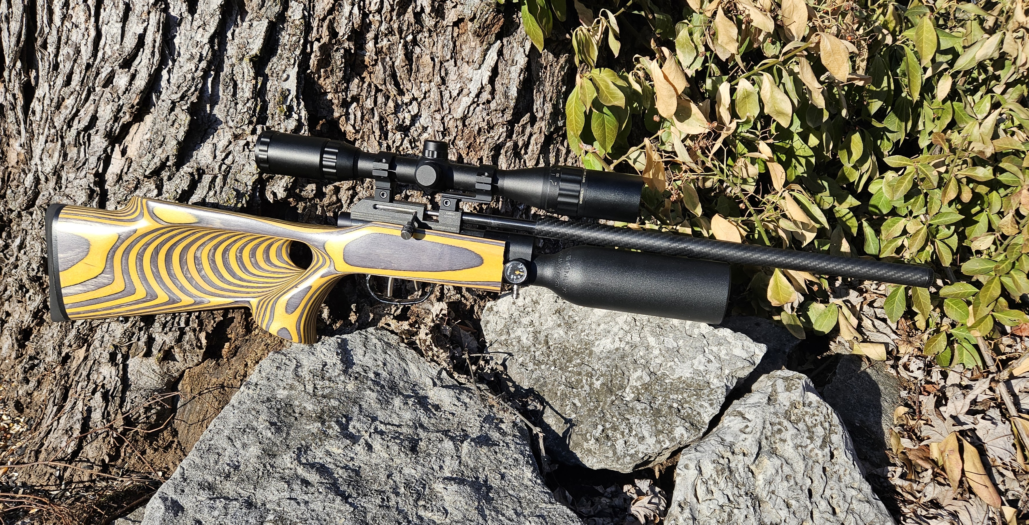

I have 3 of those Chinese drop block builds now, and they have exceeded my expectations. I opted to cut down 2240 tubes and reuse the stock hammer style setup. Just need a carbon sleeve to bring the breech height to the right level.
Even on a 100cc Chinese tube, they get a ton of shots since the fill is up to 4500 psi. I run them 3500 or less usually, since it's hard to get enough spring behind the hammer.

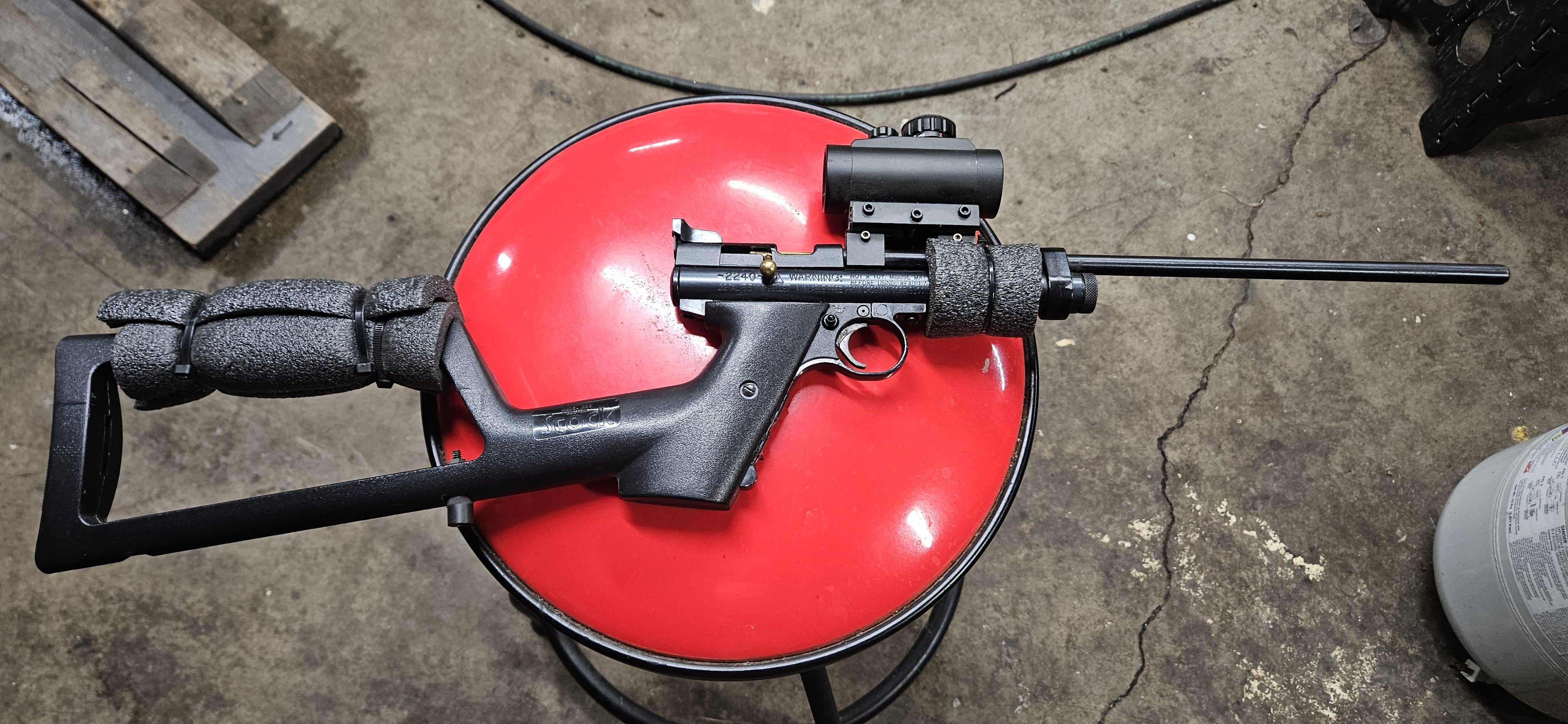

Those beemans are also heavy, no part support, and sound clunky as hell when fired. I've owned a few. The 2028, the chief, chief II plus, and the 1358. All throw away guns. All had accuracy issues as well.
I'll keep building my tinker toys. Here's one with the $60 drop block that I modified to fit the standard tube vs the rear cocking hammer they come with.
Did it cost more than a beeman in the end? Yes, but I'd rather have this than one of those any day.
