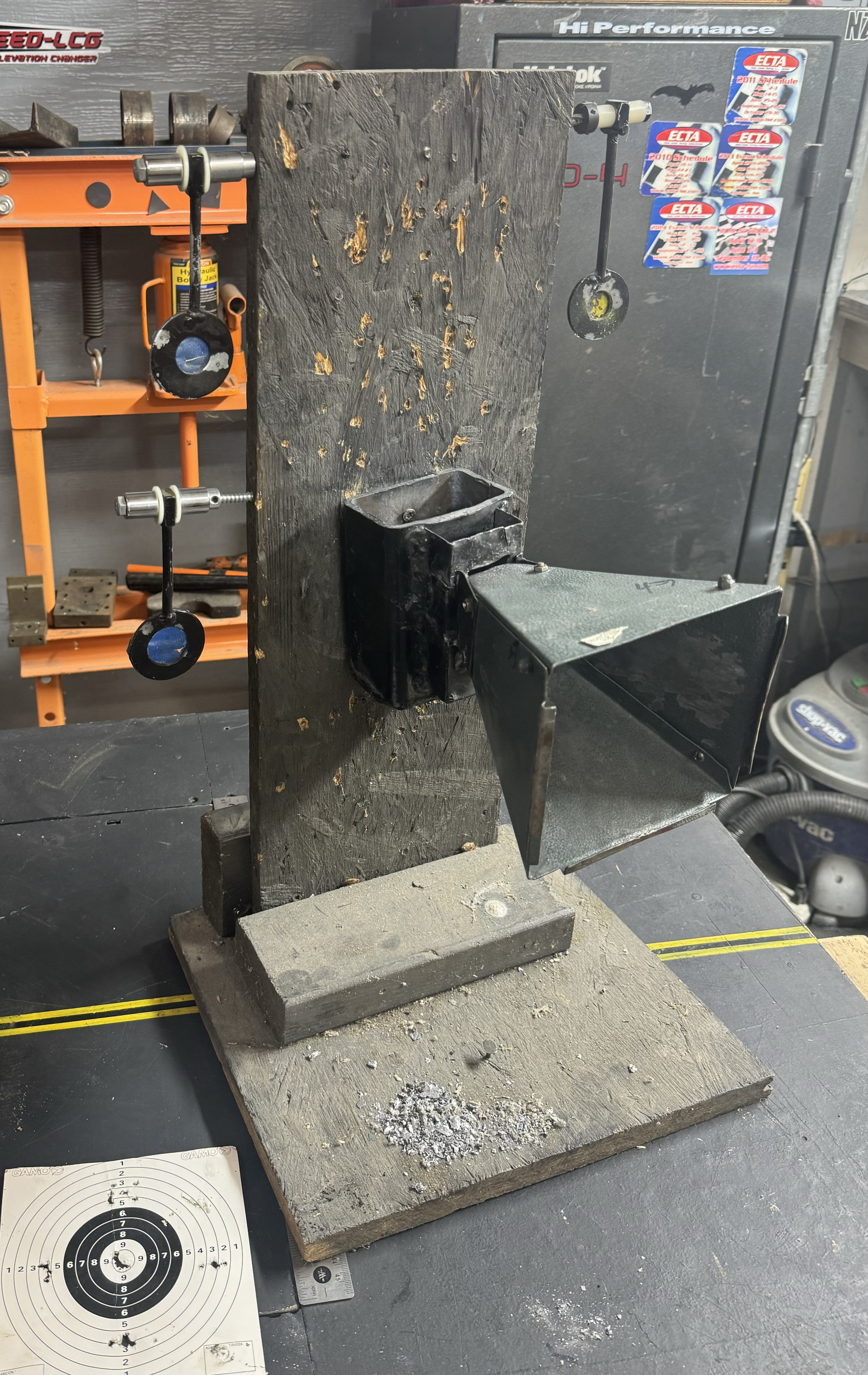

I’ll be in my garage shooting through a door across a patio at the fence. My target trap is a standard metal cone from Gamo reinforced to handle practice .
The Silhouette makes 60 db of sound and my Tx 200 is over 100. But that’s at the gun . The TX makes a thump into my target trap and my Diana 48 is way louder that that. The Silhouette is really silent outside with birds and lawnmowers keeping a steady 40 db drone. It’s totally unnoticeable.

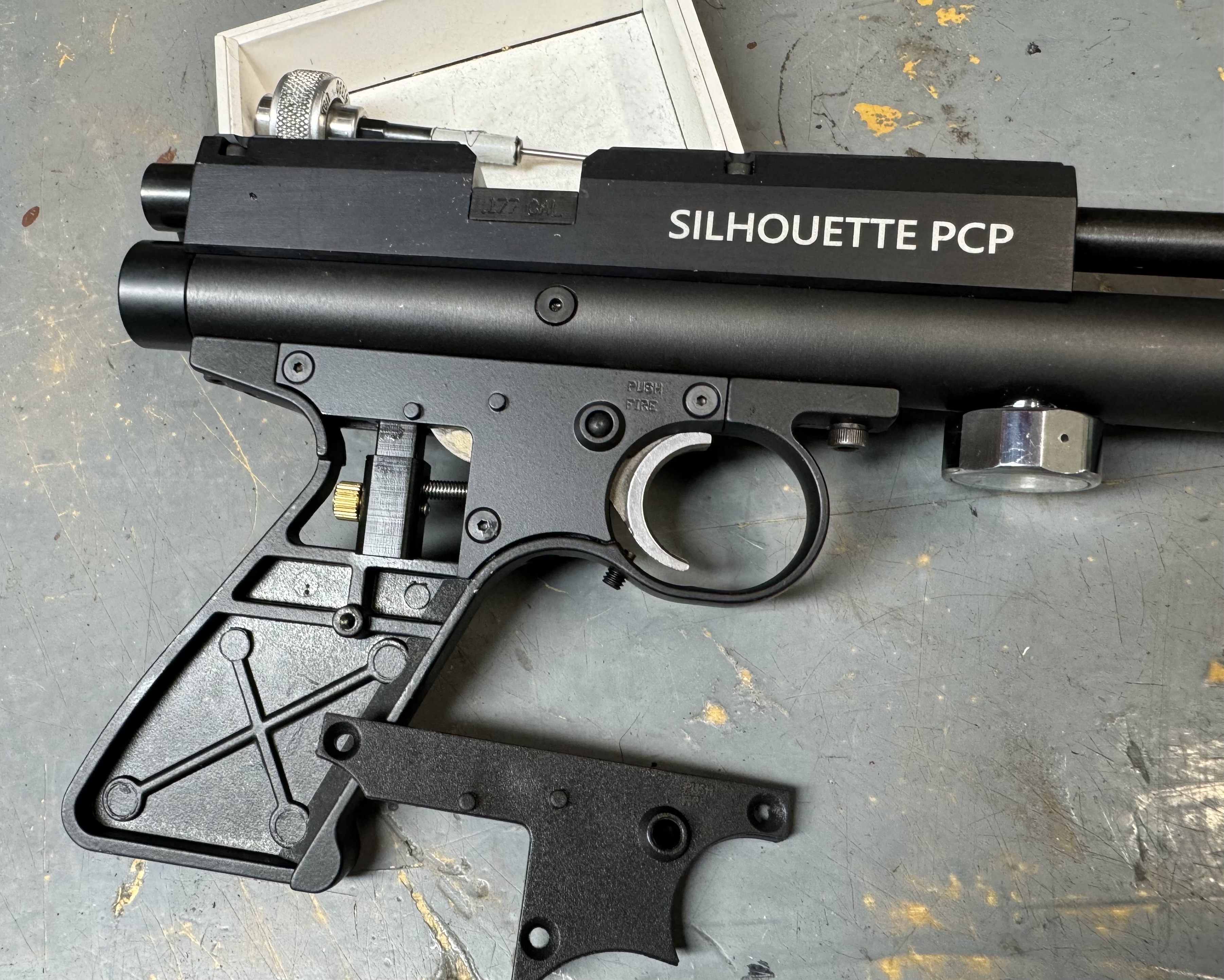

I got the trigger side cover today. I still have to paint it flat black. And bake it .
It will give me a chance to peek at the trigger. I don’t need to do anything to it. Just look maybe a drop of oil .

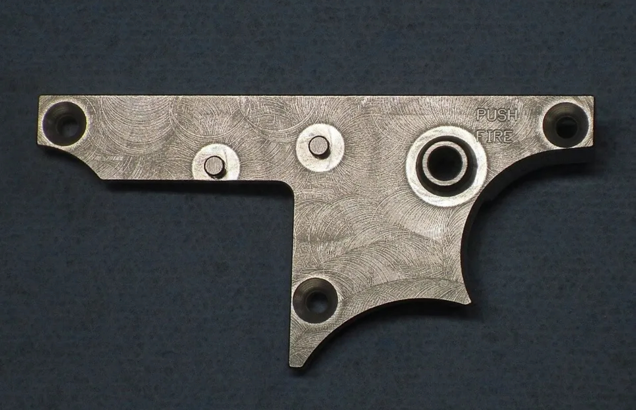

Hmm, what's the story with the side cover? Is it to see when you adjust the trigger?

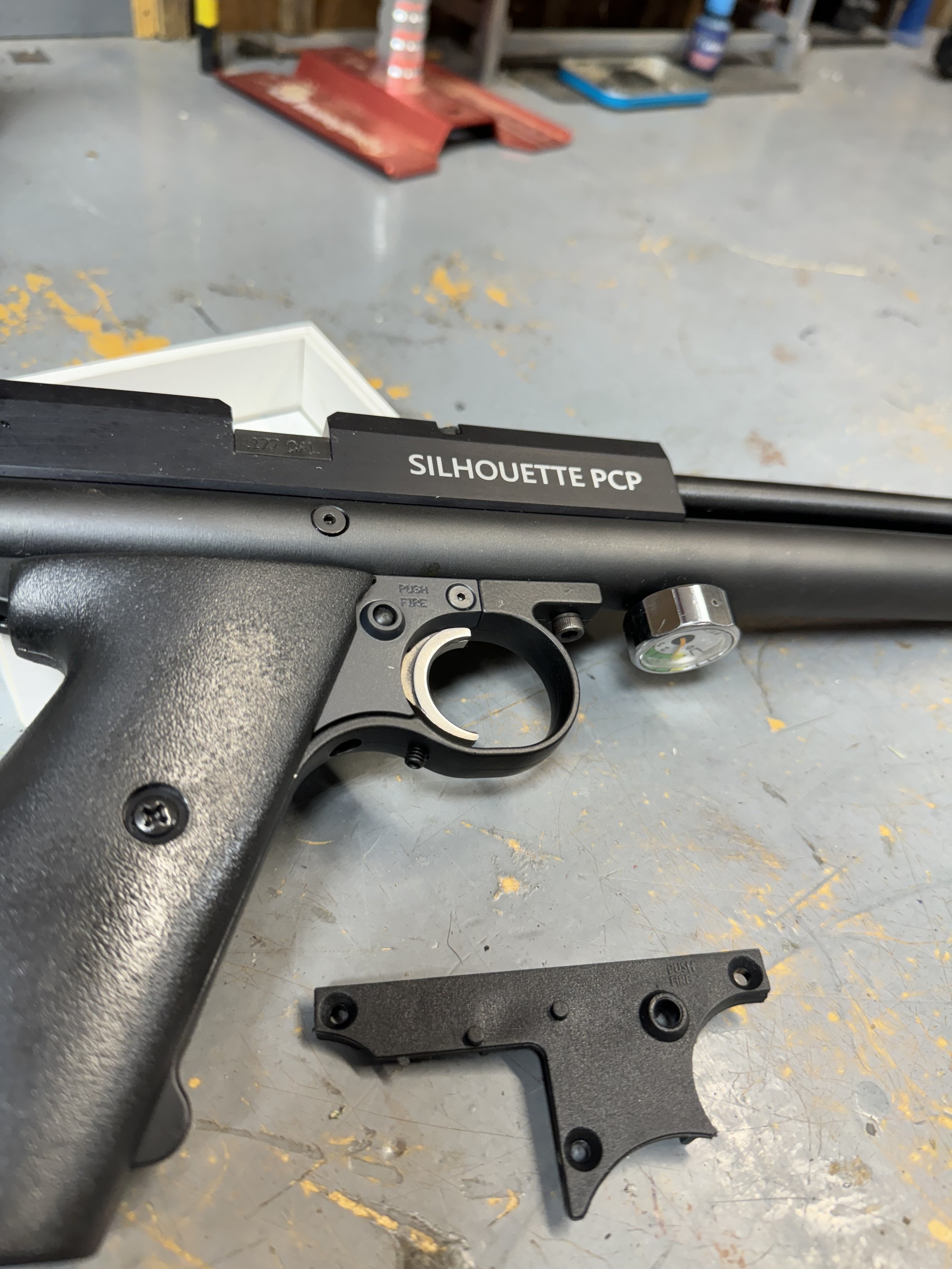

I don’t know why I don’t like the plastic part. But I just like the aluminum part better. It’s really no different. I did look at the trigger but did not adjust anything.
After a quick coat of primer I hit it with chalk board paint. It’s a flat black paint I have on hand. I put a couple drops of magic oil on the pivots and it’s all set to receive the new scope for the weekend.
Ok, thanks for the reply/info. I had no idea they had a trigger side cover that was aluminum :unsure:.

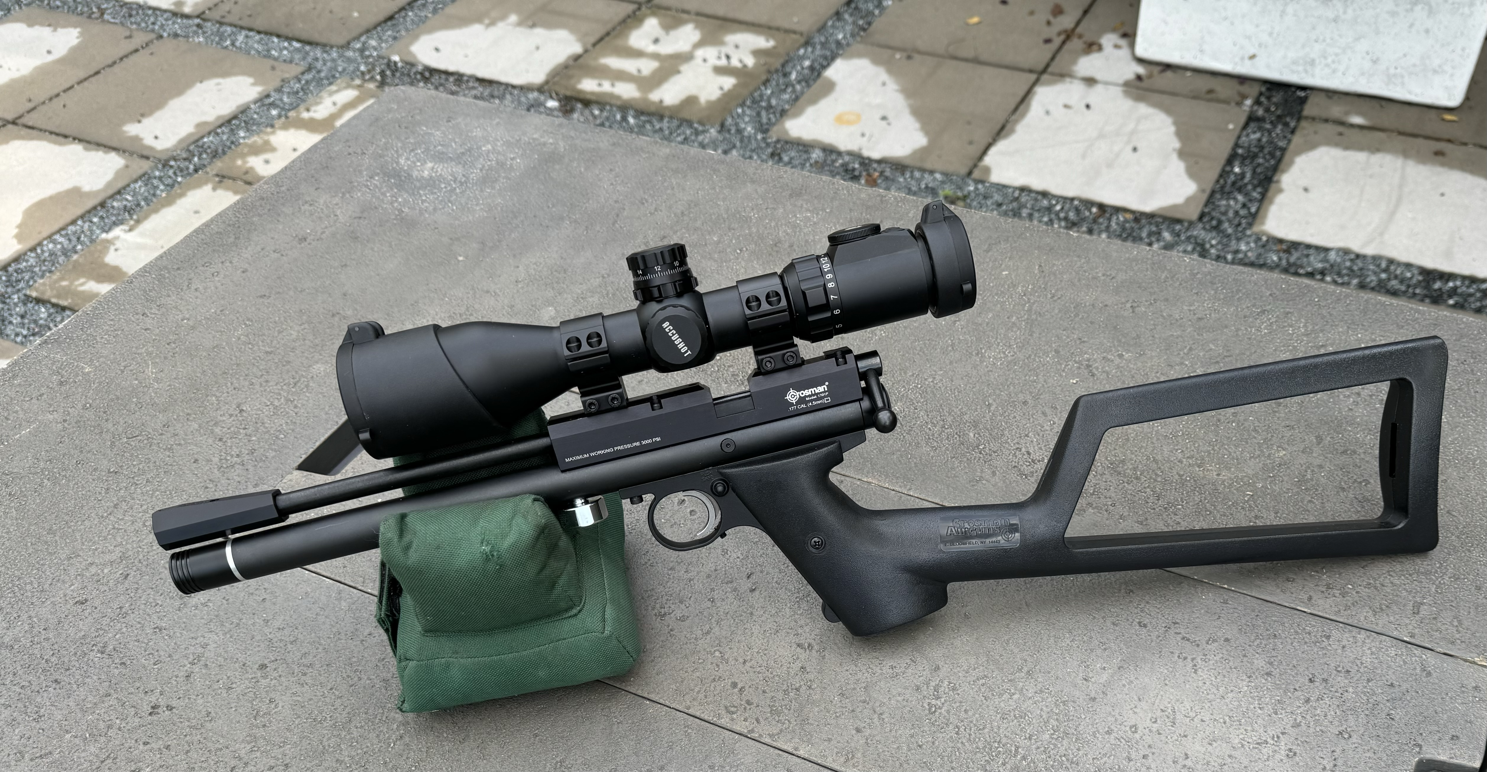

I got the scope from Pyramid air and mounted it up carefully. Then using my trusty old tin of dusty Premieres I sight it in.
It was three inch left and one inch low out of the box. A couple quick knob turns got it in pretty well and it was easy to see the pellets hit the paper with the chrystal clear scope. Once sighted in with the Premiers I figured I would just pump it up to 3000 and sight it in with my JSM Match 7.33 pellets. First five shots are a little low to the right. But that is five shots!

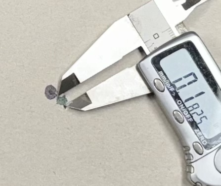

That’s five shots with a hole measuring .182! And a CtoC of .005 from 13 yards. New personal best on the first try with the new scope.
Dang! This thing can shoot.
