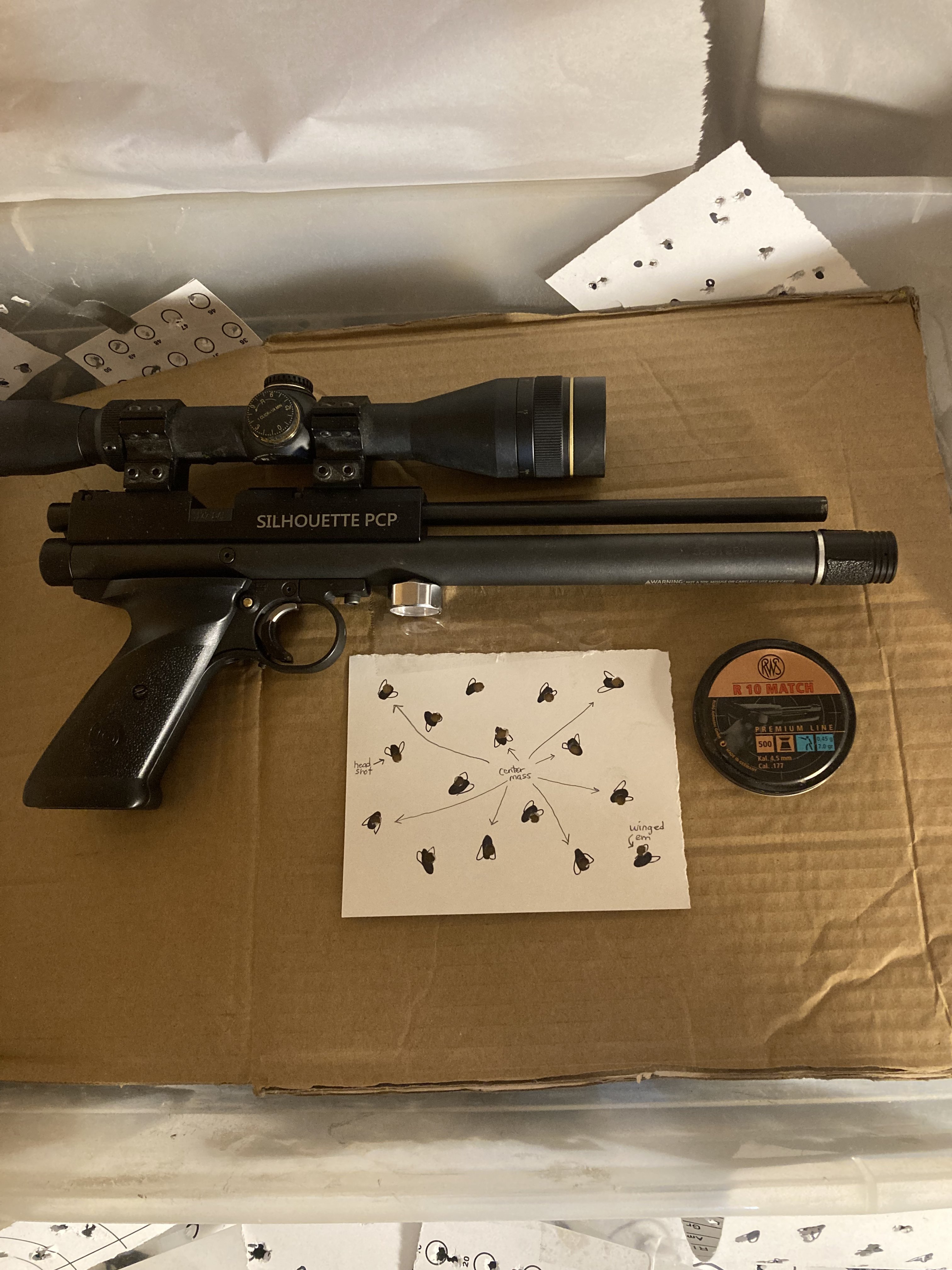

Here’s mine, just picked it up from the classifieds here and absolutely love it.
Shoots the 7 grain RWS wad cutters very nicely. I also really like the red dot on it too. These flys were shot at 7 yards from the recliner lol!

They are excellent pistols aren’t they?!
Totally scope worthy as well as off hand.
Shoots the 7 grain RWS wad cutters very nicely. I also really like the red dot on it too. These flys were shot at 7 yards from the recliner lol! I View attachment 308673
Nice shooting.Love mine but can’t shoot like that. Thanks for RWS recommendation.
Westypete, All shots at the flys were taken sitting in the recliner with feet up and shooting sticks across the knees and leaning back lol!
Really solid shooting platform, I bet you would do very well at my indoor range 😂.
Plus I shoot way more than I probably should, it’s my favorite pastime so I’m really used to the indoor range lol!
