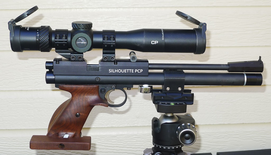

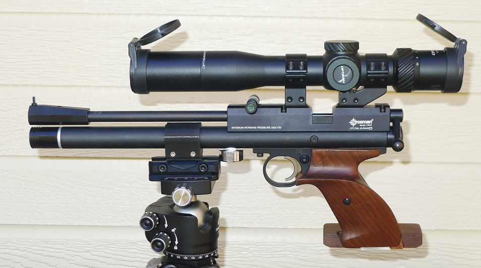

Received my Crosman 1701P 2 days ago. Unboxed it and mounted a Williams open sight and a set of Steve Corcoran grips. Yesterday I mounted a target at 10 yards and when I went to sight in the open sights, I realized my old eyes weren’t going to be able to use open sights! I had an Optisan CP 3-12x32P rifle scope on another PCP, so I borrowed it with its UTG rings and mounted it to the 1701P. Set scope at 6x, filled to 3000psi, sighted in the scope and shot 75 AA 10.3gr pellets. The ending pressure was approximately 1400psi (I ran out of my AA pellets at 75). I am very impressed with the accuracy and consistency for an unregulated pistol right out of the box.
For a Crosman out of the box trigger I was blown away. It has a nice first stage with a clear stop at the second stage with a crisp break for a total average pull of 13 ounces. I have a 1720 (1701 converted to 1720) and a Prod with the same trigger group but they required polishing/adjustment and still aren’t as nice as this trigger out of the box. I have paid tuners to get triggers this good in the past! Not sure if this is an anomaly or if Crosman has stepped up their game.

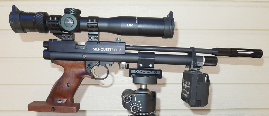

I installed a Prod TP (0.067”), my spare 1720 LW 12” barrel, Rowan Engineering air stripper and turned the hammer spring to 3 ½ turns from full CCW.
Hammer settings:
Hammer throw – 1 ¾ turns from full CCW
Hammer spring – 3 ½ turns from full CCW
