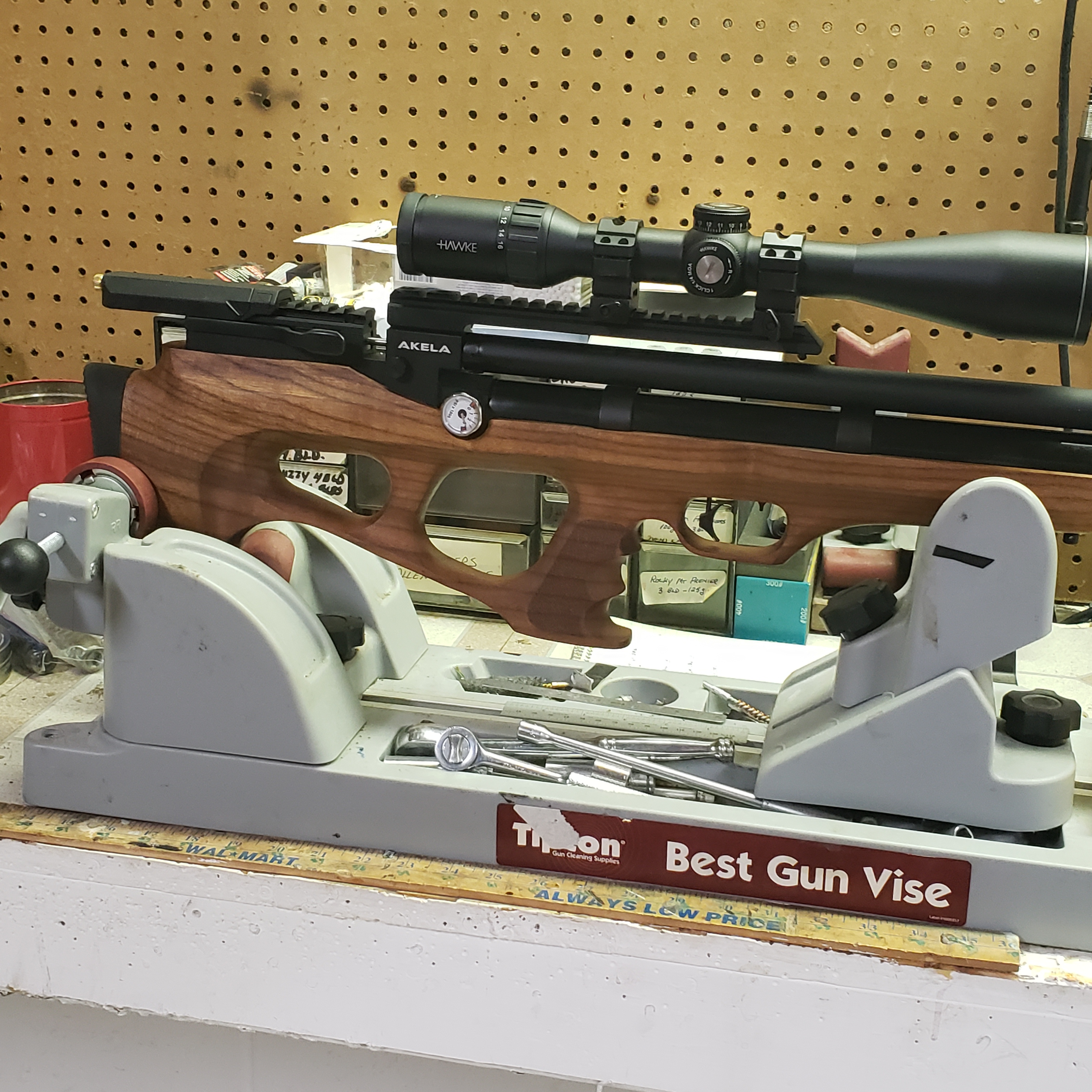

Received my new Akela from Pyramyd Air yesterday, came w/3,000 psi air.Had to email them as one of the mags has a crack in it running from the little pin in cover to outside edge, they are sending me a new one.
Took stock off immediately and put some Howard Feed n Wax, stock was as dry as a piece of paper.. started out putting a UTG 4X12X44 scope on but decide I didnt like it and then put on a brand new Hawke Endurance 30 WA SF 4x16x50. Bought same scope used and gentleman didnt tell me stuff was screwed up on scope so called Hawke and sent old one back then they sent me a brand new one.. love the scope nice big clear view.

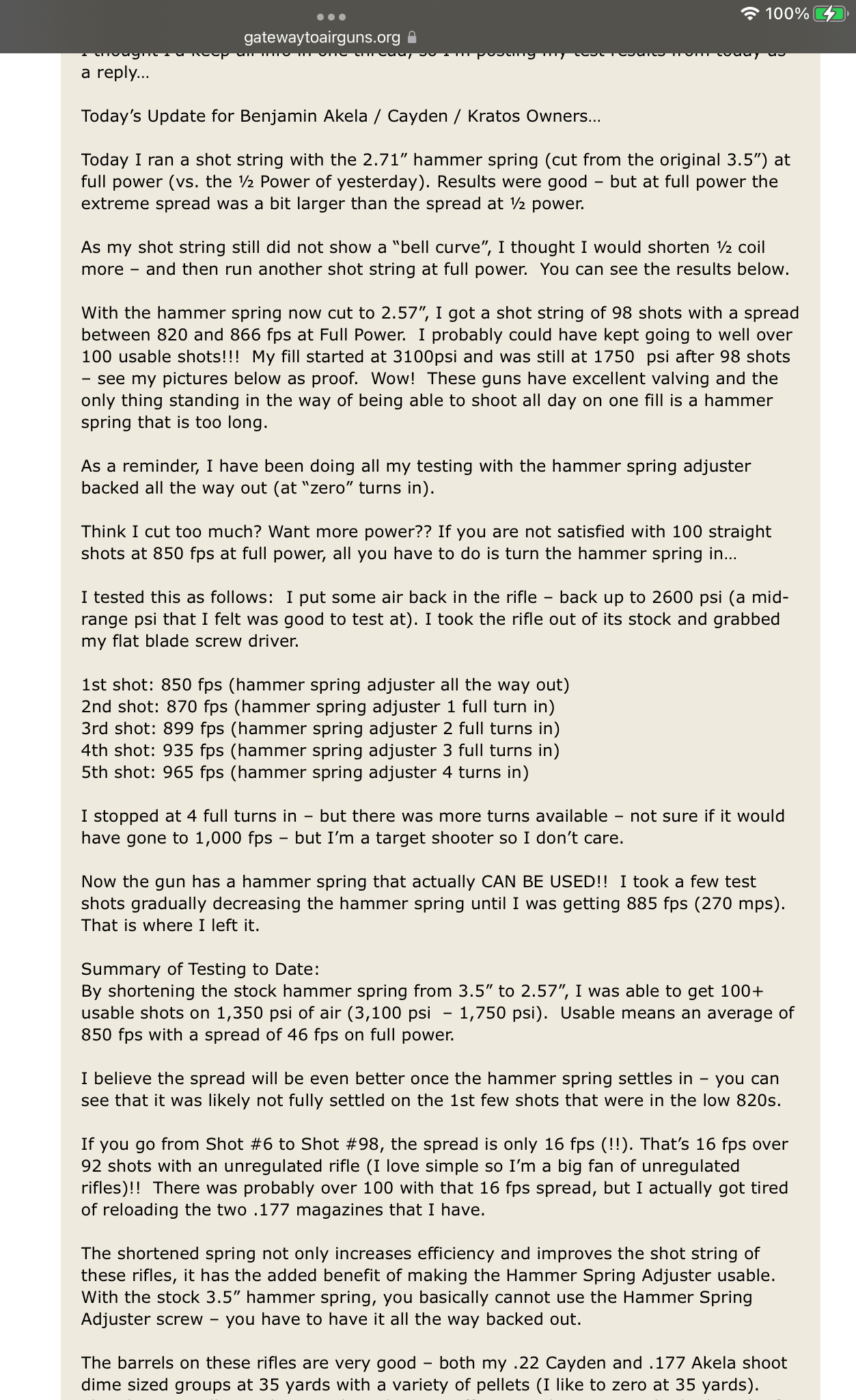

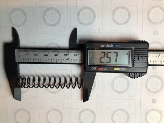

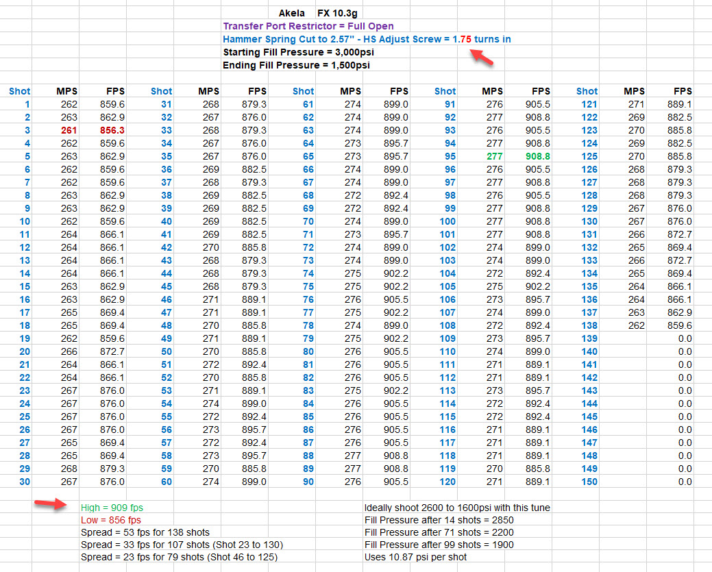

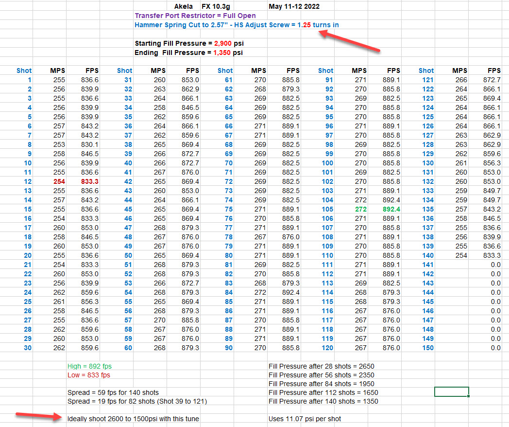

Waiting on cleaning stuff for barrel to arrive but had to run 10 pellets over chrony, with Hammer spring turned in 2 full turns from all the way out it averaged with Predator poly mags 8 gr - 1,038 fps, extreme spread 39 and SD of 13.
