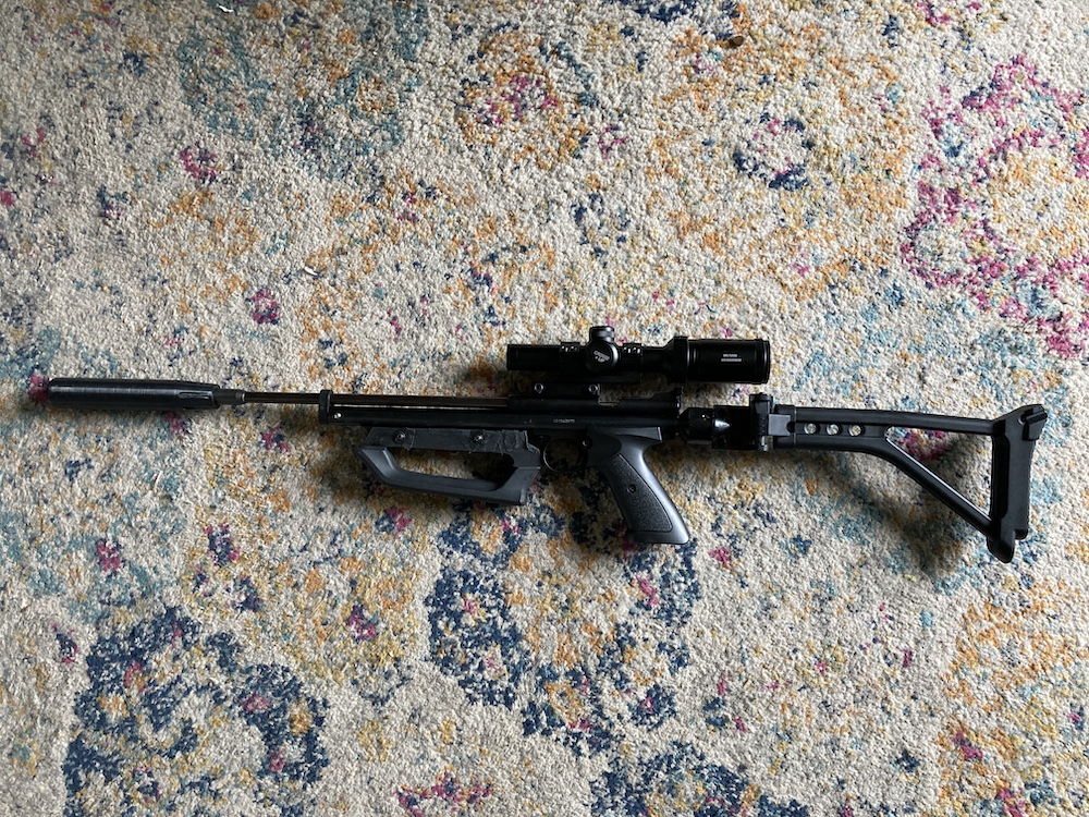

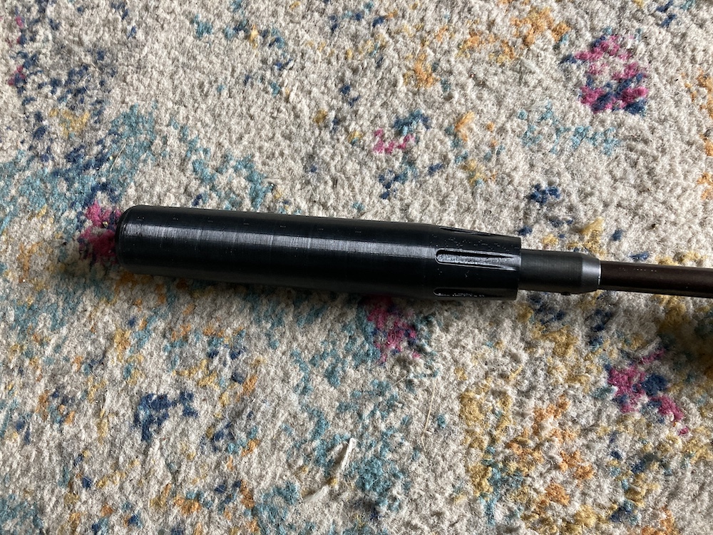

the one i got sent to me works great. very quiet, accuracy unaffected. a little larger than expected, but very very quiet. metal thread inserts work great. looks 3d printed.

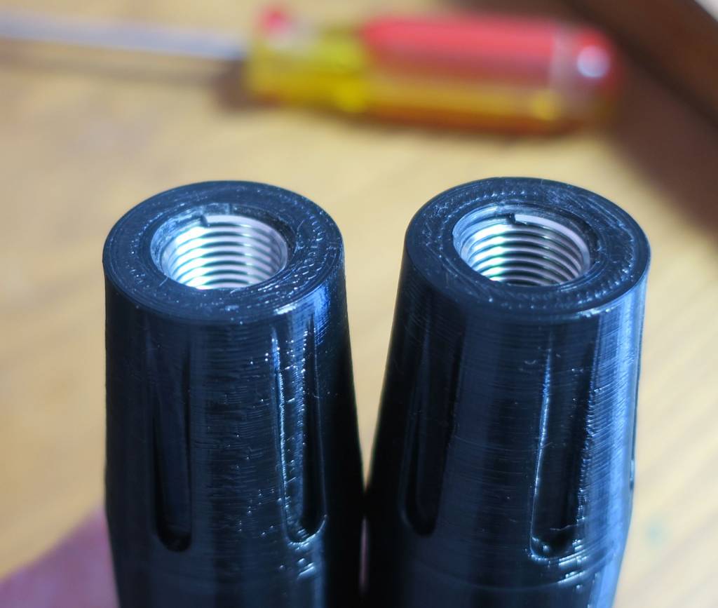

Just went to put them on to a gun laying on the table with a 1/2 UNF thread. One wouldn't thread on. The other went on fine (although these silencers have what is similar to a Heli-Coil inside, so they aren't true threads and therefore work but don't feel as nice as a truly threaded part would on installation. Nature of the chosen design).
Anyway, I looked at them side-by-side and the difference was obvious. The one on the right side in the photo was the one which would not thread onto the gun:
A little poking with a screwdriver and the end of the coil insert was in a better position, and both now screwed onto the gun.
Did they come this way? Did I cause the end of the coil to pop out of position when I first tried to install it? Don't know, but a simple fix and something to look for if yours doesn't fit your muzzle threads right away.
