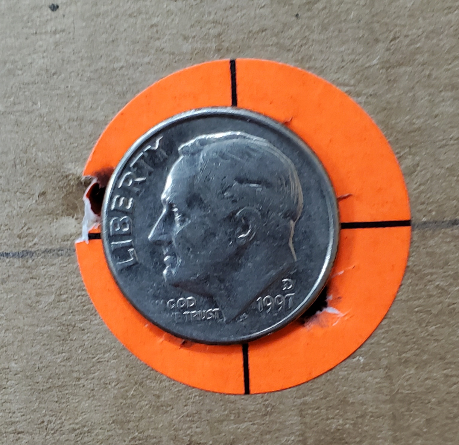

Just got my .22 cal Brocock Compatto Sniper XR from AoA Wednesday. I didn't know anything about Brocock except it is a sister company to Daystate and as of late they may be sharing some technology. So, I took a chance on the Compatto and so far I'm happy with it. I wanted a rifle that was short, lightweight, accurate, synthetic stock and had adjustable power (hammer spring). It checks all the boxes. I have it set up currently shooting JSB 18.13s at 805fps on mid power for about 25fpe. Once sighted in, I shot this 11 shot group at 40 yards:
It seems to just as accurate as the Daystate Huntsman Revere which is a nice surprise! My question is, does anyone on this site have any data such as speed and accuracy for different pellets at different power levels with this rifle? I tried the JSB 15.89 and 13.43s at different power levels and they were not as accurate as the 18.13s.

Just got my .22 cal Brocock Compatto Sniper XR from AoA Wednesday. I have it set up currently shooting JSB 18.13s at 805fps on mid power for about 25fpe. Once sighted in, I shot this 11 shot group at 40 yards:
