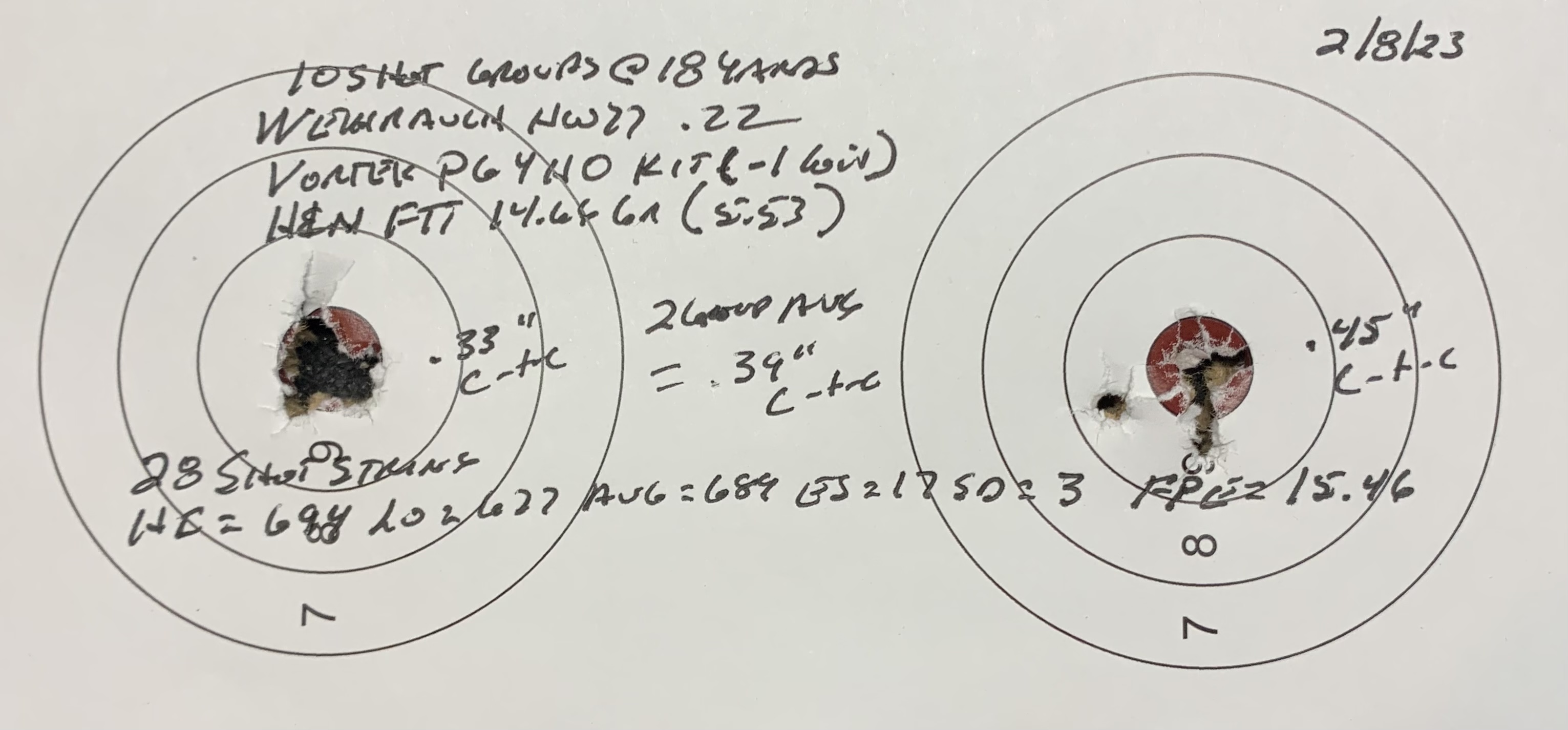

My goal is always +/- 15 fpe. As you can see below, I got lucky and hit it right on the mark.

After I had the scope fully dialed in, I shot two 10 shot groups using the H&N FTT 14.66 Gr, 5.53 pellets, with the intent of testing six others over the coming weekend.
This rifle is shooting incredibly well with only one pellet tested and less than 50 shots through it. Except for the one flyer experienced, the groups were really tight. I also attempted the five 10mm RX targets and took them down in only six shots.
