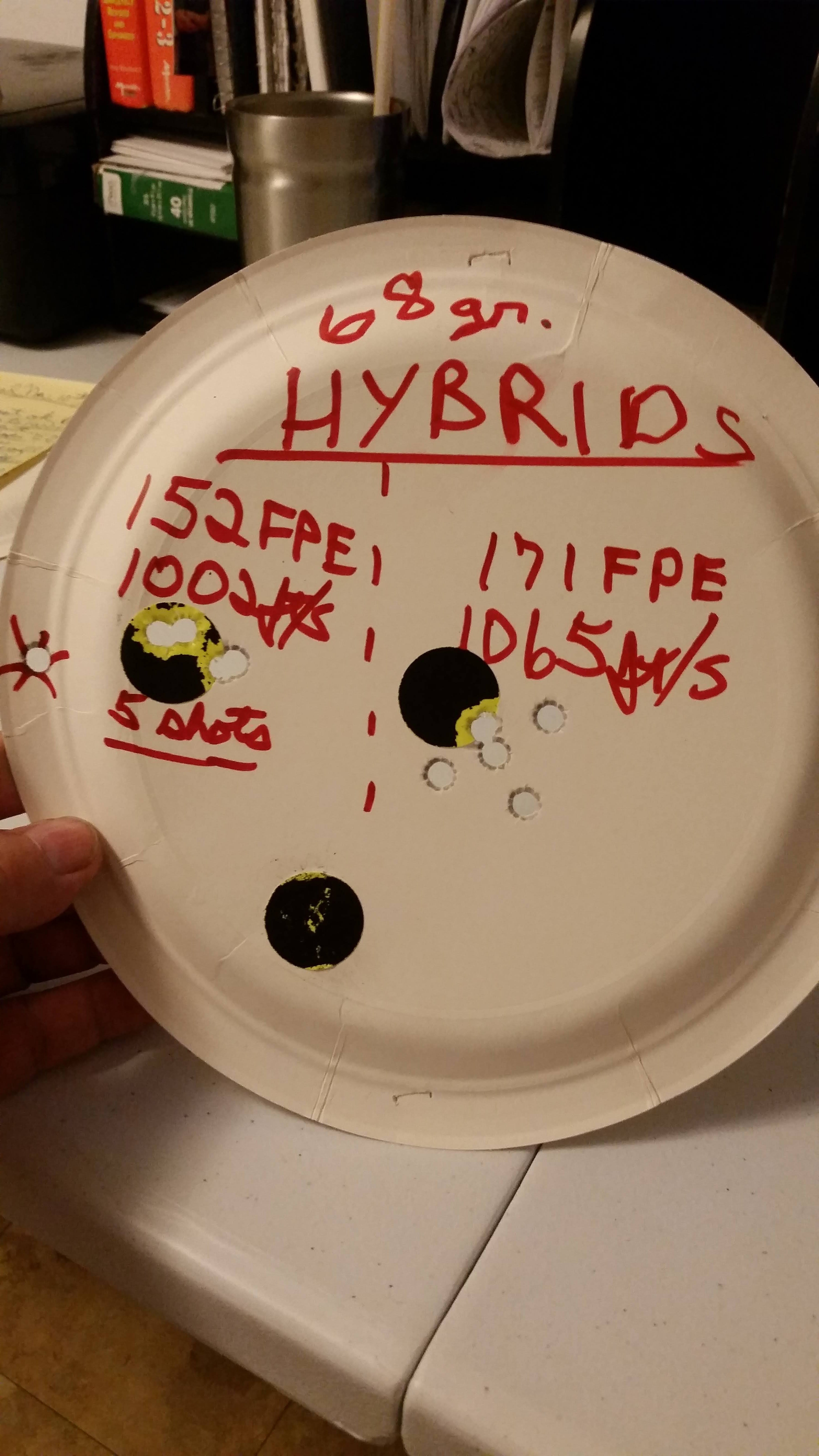

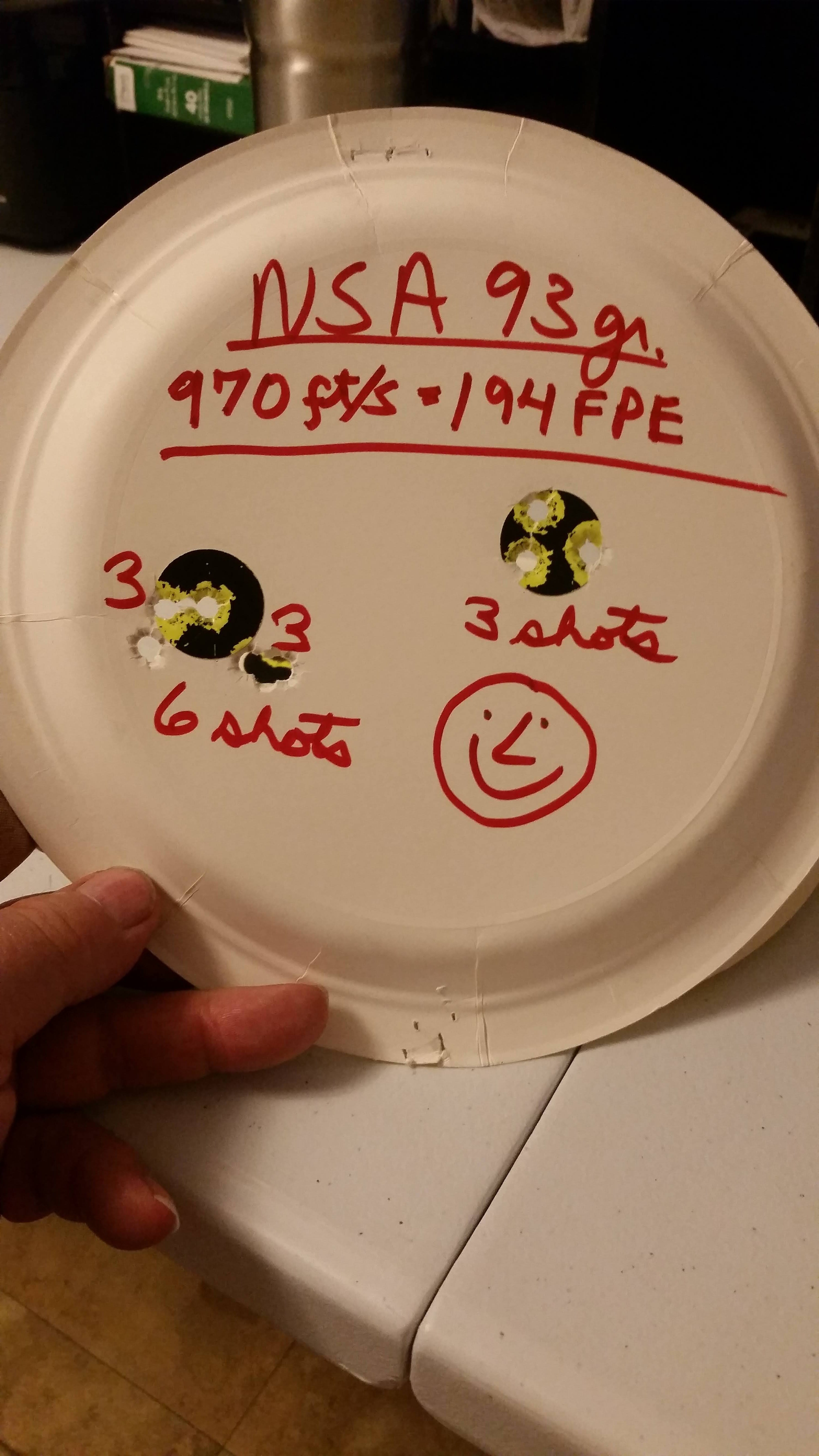

Yesterday my .35 Impact MKII I call Elsa shot the Nielsen 93gr Hollow Point slugs at 970 ft/s which is 194 fpe…and the photos below will show the accuracy. Also she shot the FX Hybrid slugs at 1065 ft/s for 171 fpe, and then at 1000 ft/s for 152 fpe. The Hybrid slugs like this new slug barrel best at around 1000 ft/s & under for extreme accuracy. At 1065 ft/s the group at 50 yards measured 1 1/4" center to center...okay for hunting but for target shooting one hole fun shooting them at 1000 ft/s or less is best.
I refer to accuracy two ways - one I call "hunting accuracy" which usually means sacrificing some accuracy for lots of power; and the other I call "target accuracy" which usually means turning down the power in order to get one hole target accuracy. Once in a great while I am able to find a projectile that will allow me to shoot it with a ton of power and one hole accuracy... and that's what happened with the Nielsen 93gr slugs out of this new FX Tensioned Slug Barrel!
I am including a couple photos of the results I got with the Nielsen 93 grainers and the FX Hybrids yesterday, and I am including a link to a couple videos from my YouTube channel for you - one demonstrates how to use tape wraps on the barrel under the carbon fiber barrel sleeve, and the other is from when testing this new slug barrel yesterday. I give this new FX Tensioned Slug Barrel my highest recommendation, and especially want to share my excitement about how fantastic the Nielsen 93 grain slugs performed out of this new barrel. I ordered four more boxes of them today, and also one box of the 79 grainers to try out in this new slug barrel. Make sure you order the Nielsen slugs in size .358 for this new slug barrel and you will be glad you did!
