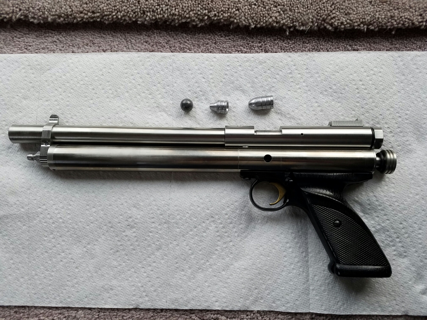

So I say "Quit whining and build one yourself, if you think you can."
I spent my whole career as a prototype machinist running manual lathes and mills.
My personal shop has a 13X40 Jet Lathe, and a nice vertical mill. And I am fully tooled up.
I have been busy in my basement shop. I have had a bunch of ideas to make a pistol like this for a long, long time. So 100 hours later, I have a totally Stainless steel gun. I used 17-4, 303, 304 and 316 alloys. I found out the hard way, you cannot use the same alloy material on mating parts for galling/ cold weld reasons. In my build, I used a .312 transfer port, the pressure chamber’s o-rings are inboard ( the threads don’t see pressure). There are no bolt or hammer handles hanging out. The bolt and hammer knobs all both behind the gun. I use a Vlier spring plunger to hold the bolt closed. I also use a large cross section O-ring that just fits between the bolt and the housing to add a little friction. It works super. The bolt is not coming open accidently. Another large O-ring is between the hammer handle and the housing so the hammer will never crash metal to metal. The hammer spring is
1/2 I.D.X.072X3.00 long. The spring guide is part of the hammer to add weight. The stainless barrel is .566. bore, .570 lands. I had these barrels made years ago from T.J. Enterprise. I want to use the .570 round ball that is swaged and commercially available. There are all kinds of internal improvements especially on the valve. I would have to show you the drawings. Which I can do. I don’t hold secrets. If this forum supports drawing files (DWG) I’ll publish the whole print for anyone that want’s to look/criticize my drawings.
I'm 60 years old and retired. I have a bunch of air gun related ideas that I'd like to share, I'd love to see someone else take these ideas and run with them.
I finished the gun about 2 months ago so I probably have close to 1000 rounds through it,.
Right now the Shoebox compressor is working overtime. This gun barks loud, and kicks like a mule. Look backwards before you shoot.
Because of the short barrel and air tube I get one shot at 570 FPS with a 3500 psi fill.
So I present to you: "BIG JOHN'S SON"
Full Stainless Steel.
Iron Sights. (and dovetail grooves)
Easily carries in a holster.
No clumsy Knobs.
About a 4 pound trigger. That might be the best I can do using the Crosman grip and trigger assembly.
Sorry, no shrouded barrel.
no silencer.
no carbine stock.
No scope.
This is a gun that I could drop in the woods and find 100 years from now, pick it up and fire it.
And YES, I am always open to any constructive critique.
Please, Let me know what you think. John
