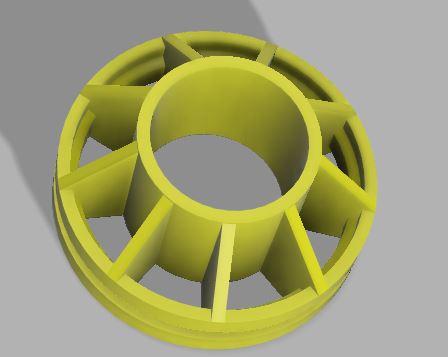

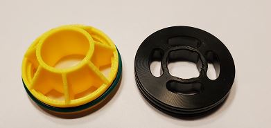

I designed a 5-spoke CF Barrel sleeve / shroud spacer with a thicker o-ring, as is on the right below. On the left is a new 7-spoke spacer with a thinner o-ring design.

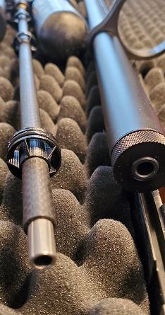

For comparison of the new 7-spoke to the OEM spacer (that works with the barrel without the FX CF barrel sleeve):

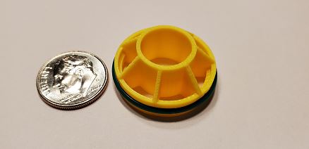

For a size comparison to a dime:

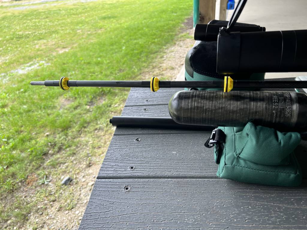

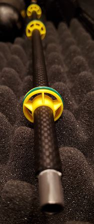

In the following photo, an intermediate 5 spoke design with thin o-ring is on the front, and the last two spacers are the new 7-spoke design. This is just to illustrate installation:
I'm too lazy to go back and take a photo with the 7-spoke design on the front, as I already put the shroud back on.
In any event, I am not as confident in these new spacers because they take more care to install as the o-ring can walk off if care more easily if the shroud is forced over the spacers too quickly or forcefully.

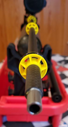

The following shows the installation of the longer 5-spoke with thicker o-rings.

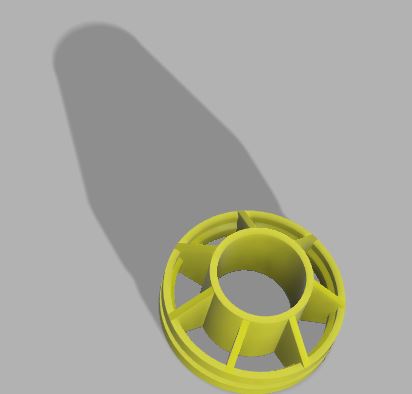

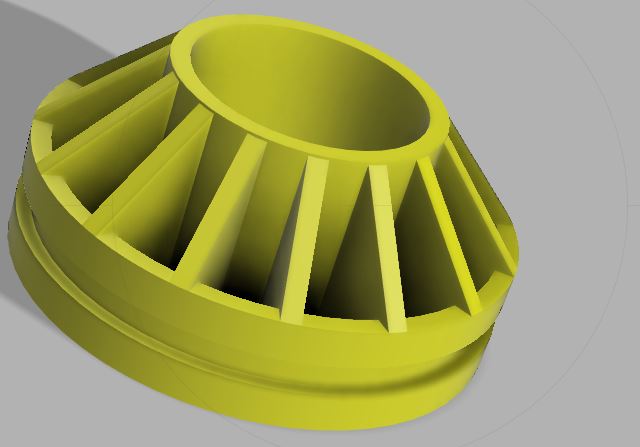

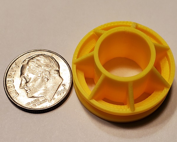

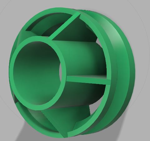

which looks like this rendered without o-ring:
