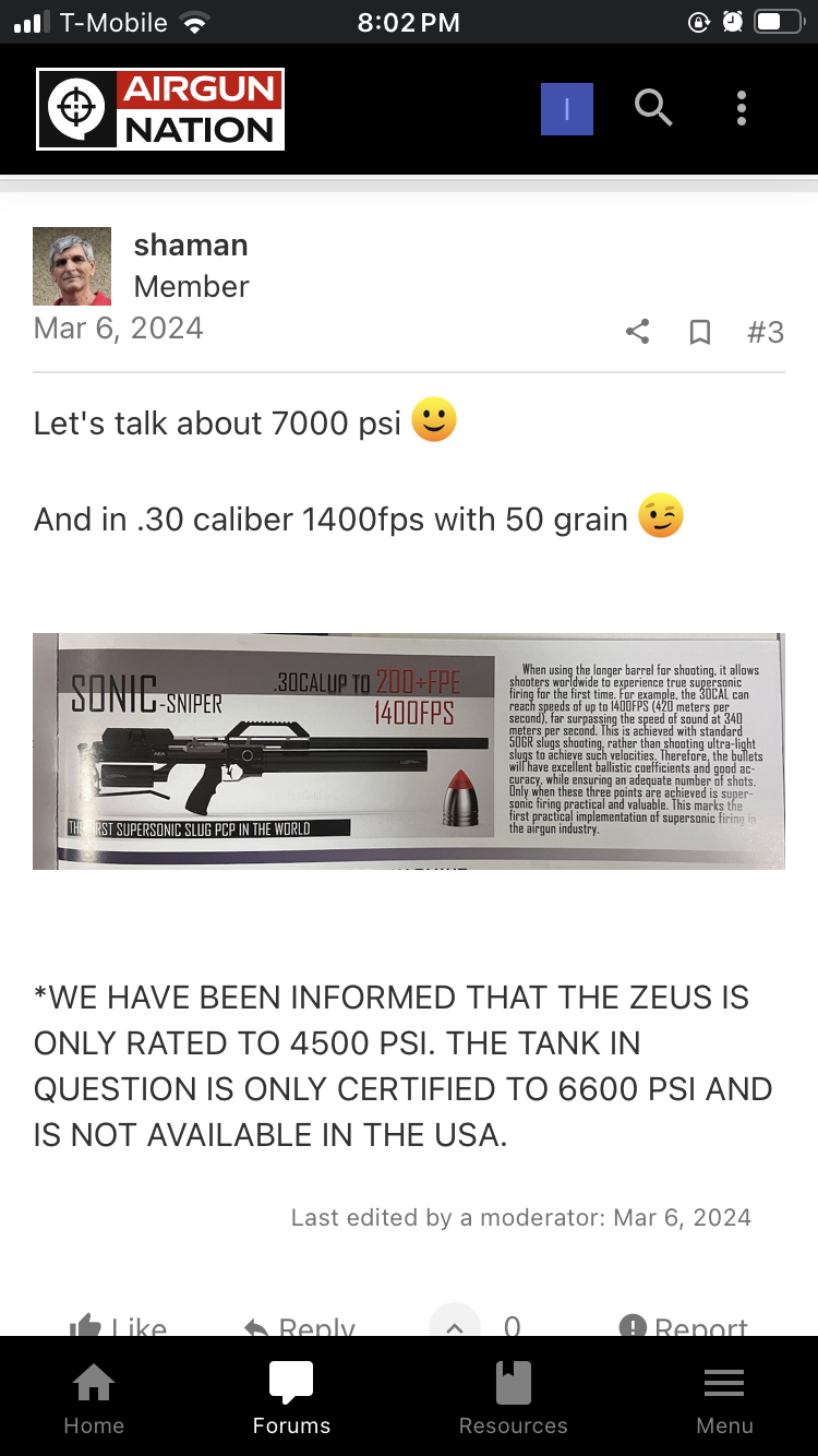

The question is are they capable of hydro testing a 7000psi tank. If I remember correctly it need to be tested at a factor of 1.5 which is 10,500 psi
Not sure if it's correct but I was told that tanks are tested at 5/3 the operating pressure. So for a 7k tank that would be 11,667 psi

And that's my point. A GX compressor can do 5800 psi. The AEA can allegedly hit 7000 psi. But those are MAX output ratings, and no tank has been made to hold either charge, so asking if there is a hydro facility that can test it is kind of moot, IMO.
And most people who own their own compressor and tank aren't going to get hydro testing done anyway.
Bin Tac new Rifle takes 7000psi BUT is regulated at 4500psi
