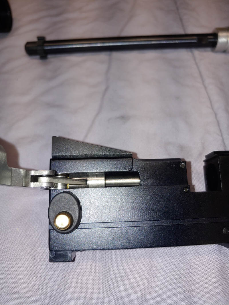

Ok first let me tell you the receiver air passage is a respectable .136 opening, unfortunantly the valve-regulator and the barrel passages are .116 go figure. this item is easily solved we are opening all passges to .136 to provide good airflow from tank to barrel and have a good machine match. stuck regulators, belvilles that are not functioning properly due to crap machining, and some debris and cut O-rings very rough cocking due to again poor machining at factory. All these items are being fixed as part of tune we are performing on the PP750s.

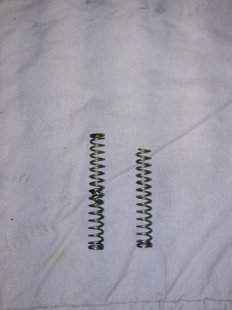

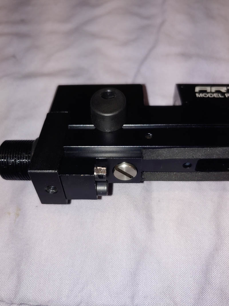

Now some other items we are discovering, several pistols are missing cocking lever springs, we have found many that have had there hammer springs cut back, and quite frankly they have missed the mark on several mounting screws as well. In fact they are grinding flats in them to make the allow parts to fit. I have attached a couple images showing these items we have found. NOW that being said Wes has no control over chinese QC. but Ver adium will not ship these pistols as they are not fair to client who has spent there deneros on them.

Here are items found and have corrected.
