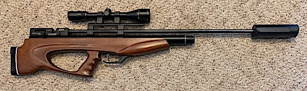

You bought an airgunsmith's dream air rifle Woody, but it sounds like you might not be an airgunsmith. Hate to say it, but notwithstanding the modifications I've described, you're not going to enjoy shooting that rifle very much (because you won't be able to cock it more than a few times in a row).
