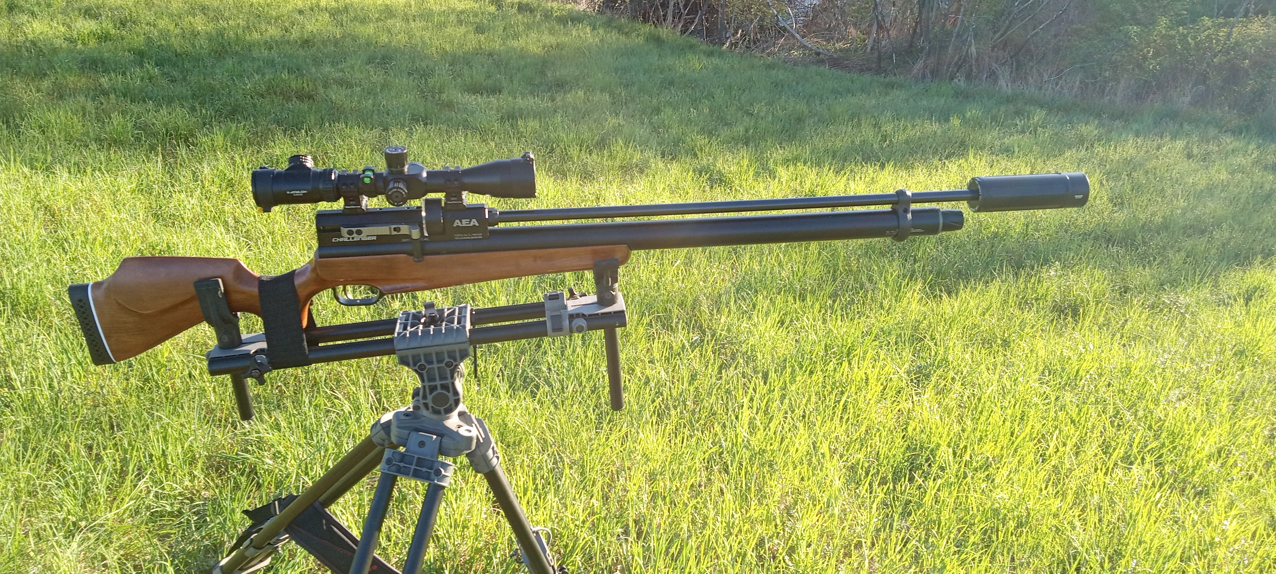

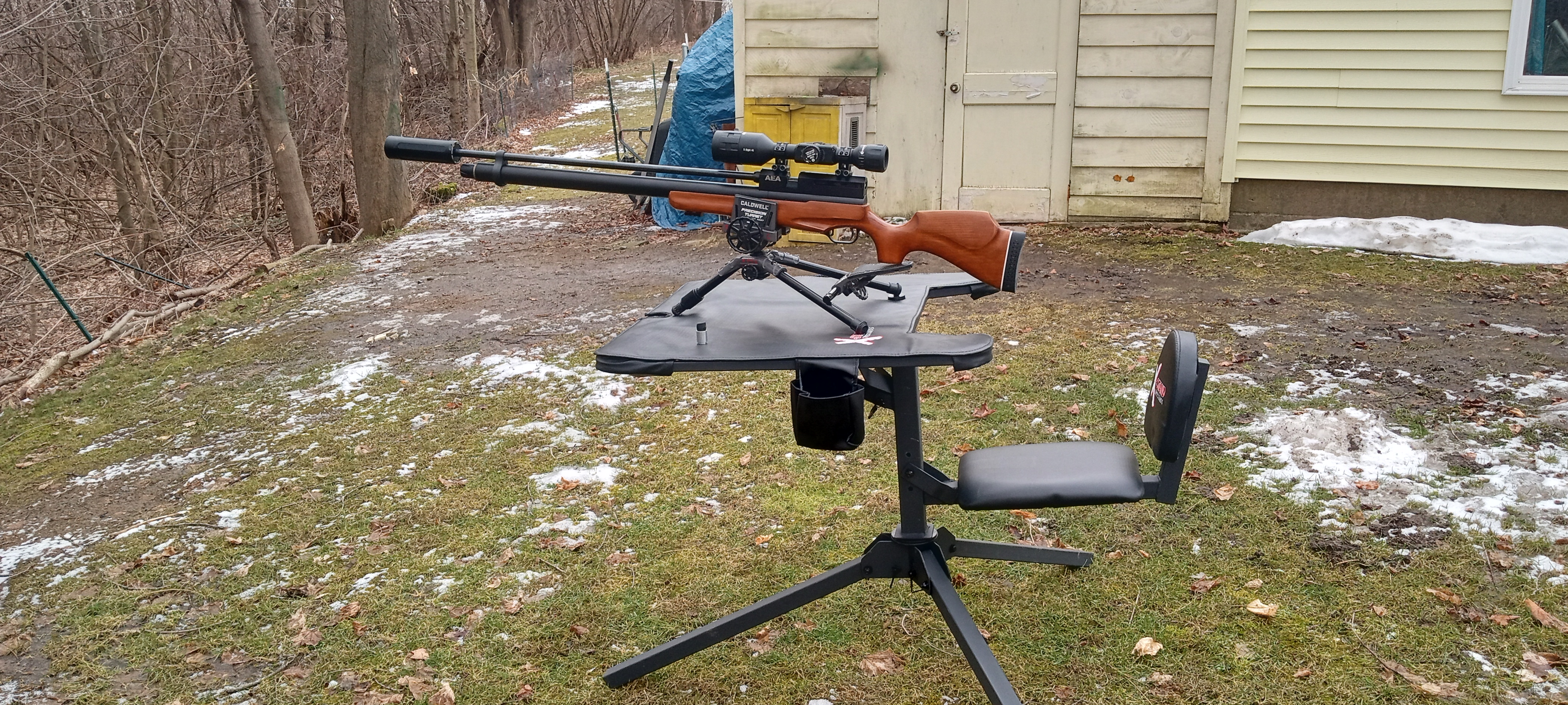

I have the 357 big bore and i have never had any trouble with the mag and i will say there not all plastic like most. But It's a tank, I don't carry it around, i shoot from a blind with a tripod or my portable shooting table. I also shoot tethered and have a inline regulator set for 3800 psi

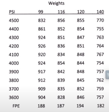

the 900's are 150 ft lbs and the the 1100's are 220 ish. 4 shot X 220 = 880 lbs and 2 X 155= 310 for a total energy of about 1200 lbs.
I get 12 shots at 195 lbs which is almost 2400 ft lbs. Now if you added a regulator and had it tuned to 950 fps every shot would have
the same point of impact and the wasted air for 1100's is 200 lbs X 4 or 800 lbs saved air and no misses due to velocity change.That air would probably
give you more shots. for example lets assume each shot uses 155 psi. 4500 fill down to reg setting of 2850 = 1600 divided by 155 gives 10 shots.
You could up the reg/hammer settings for more... say 3100 psi and use 170 psi per shot. so 1400 psi to work with divided by 170 psi gives 8 shots.
that's how you setup for big game and 125 grain hollow point moving at 864 FPS gives over 205 ft lbs of consistent shots. Western Rattler and challenger elite's are both great but that hammerless dude rules. I'm selling my seneca eagle claw 22 despite the decent shot count. 18 grain pellets go 920 with the power wheel on 3rd click. the 4th click goes 990. so 33 to 40 lbs. Put a 25 grain slug and click 6 gives about 58 ft lbs. on the low end I get about 50 shots and about 10 up high. because of velocity variance 80 yard groups are a joke. So I got an avenger and while 40 ft lbs is near max power, soda cans at 80 yards all day! The only unregulated shooter I'd consider for a one shot one kill would be the 58 cal Element.
