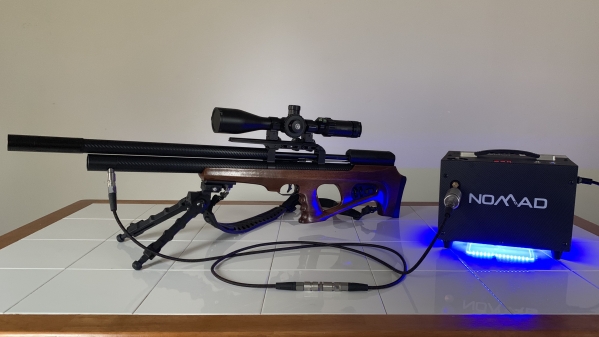

It showed up a few days ago and I’ve been filling and shooting my PCP’s like a mad man. Build quality and operation is top notch. And I also believe maintenance will be very simple.
Tryed it both from a 3 prong 110v home outlet and from the 12v DC battery connections via my trucks battery! Works like a charm! 3 and a half to 4 minutes to top off fill my FX Streamline (.22), Wildcat MKII(.25), or Crown(.25). I know most of you are way past this level of Airgun Compressors, but for those who hand pump like I’ve been doing, this Nomad II Compressor is proving to be a Huge convenience! Shipping box was top notch and I believe it will work out very well!

Hey Joe I got one too but have not run it yet. Did you put in any drops of oil before running it the first time or just run it as it came? I have the silicone oil but no instructions about the first run. Thanks for your input!
I ran it first and monitored the load indicator while topping off a PCP. Instructions say load indicator will safety shutoff the compressor if a 28 load is reached. Air Venturi includes a test verification card so I believe it was oiled properly and is ready for use right from the box. It runs at about a 15-20 load in the 100bar range and levels off at a 24-25 load at the 200+bar range. I ordered a 4 ounce bottle of quality 100% pure silicone oil from Amazon. Added oil once out of paranoia, 3 drops it probably didn’t need it. You’re more than likely don’t have to add oil as often if you’re just topping off guns 50-100bar at a time. It would probably require more oil if you were filling PCPs from empty. Top offs mostly and the occasional fills from empty will be how I’ll use the Nomad II. Its not for SCBA’s or buddy bottles. I’m digging on it. Noise level is moderate and it runs very Kool! (Powerful cooling fans everywhere)
how long did it take to top off and how many ci is your gun air bottle/tube?
My Streamline has a 230cc air cylinder to top off from a regulator setting of 140bar to 230bar max takes 4:30 minutes.
The Wildcat MKII has a 300cc air cylinder top top off from a regulator setting of 130bar to a 230bar max takes 5:30 minutes.
The Crown has as a 480cc air cylinder top off from a regulator setting of 130bar to 250bar max is about 7:30 to 8:00 minutes.
Beats pumping.
Most times I shoot my airguns down 50 to 60 bar and then top them off. So, it’s usually less around or less then 4:00 minutes for a top off. A ritual or routine I adopted when I hand pumped only. To cut down on pumps.
