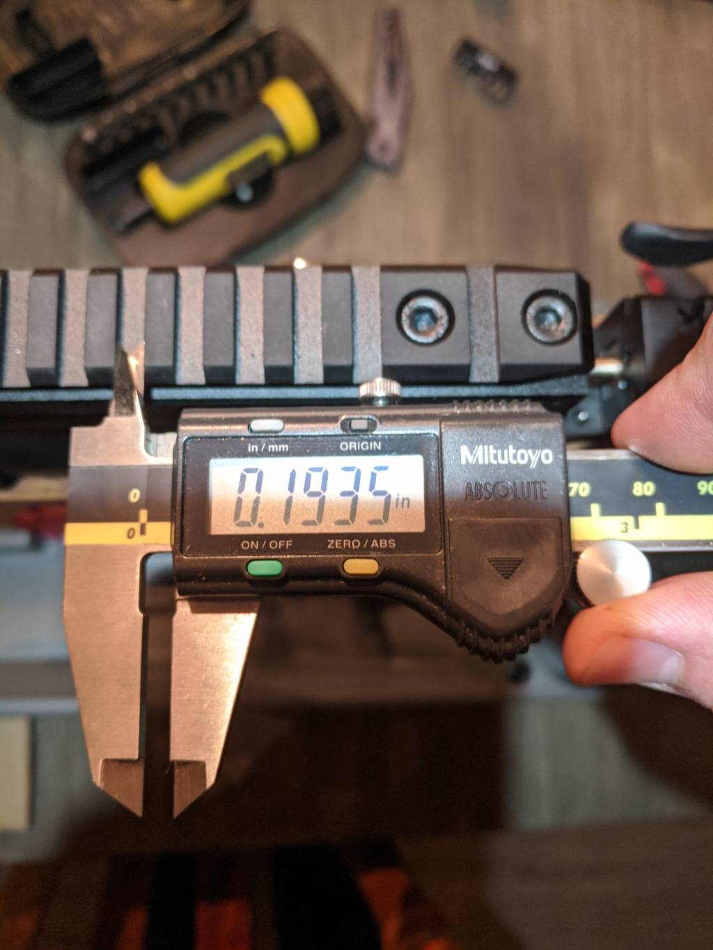

1. The "picatinny" rail that is on the rifle, does not fit a picatinny scope mount due to the slots not being spaced far enough apart. With some google and some calipers on hand i discovered that picatinny rails have a 0.206" spacing , when my akela's "picatinny" rail is 0.193". This is an issue with with mounts like the monstrum cantilever mount that has square cut outs to help stabilize in the groove. I have this mounted on 2 of my benjamin/crosman break barrels without any issue. DOES anyone know if this is a machining error, or is benjamin falsely advertising the picatinny rail when it is not? I can find another mount but i really like this specific one and am somewhat disappointed i have to spend more time with this gun unable to shoot it.

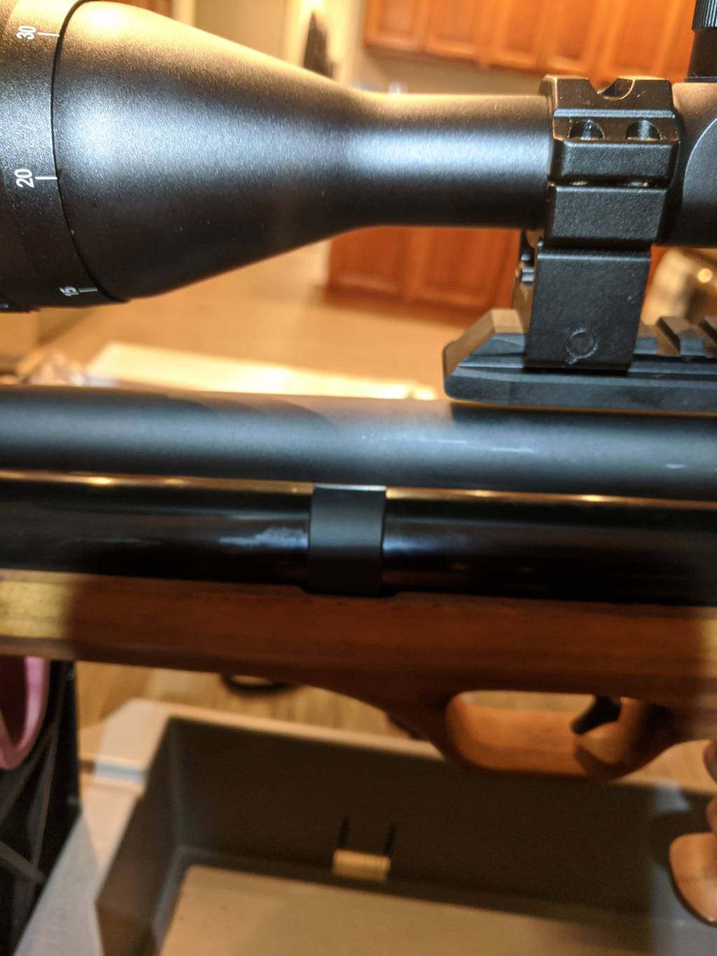

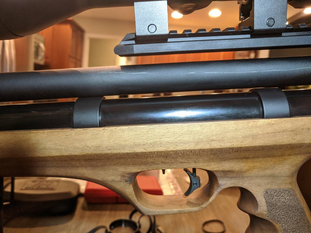

2. My main issue with the gun. As some may know, there is now barrel strap on this gun, which allows the shroud and barrel to flex with slight pressure, having some floating barrels in other rifles i don't know that its a big deal and should be fine for accuracy as long as aware of it. My issue is that the shroud is actually resting on the tank reservoir strap, and when removing the shroud, has rubbed off the finish of the strap and scratched and marred the shroud. As this is a brand new gun i am really upset at this. A floating barrel is one thing, but when it isn't floating and actually resting on the tank, i feel something is wrong.

Pic with calipers and gap in rail, pic showing gap in front strap and resting on second, pic showing damage on strap from turning shroud and scratch on shroud from taking it off of barrel.
