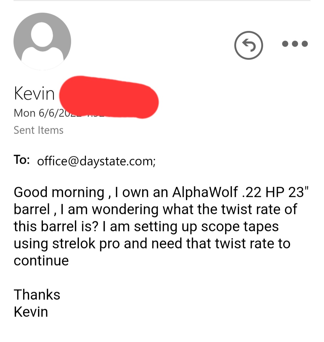

So I have had my Alpha Wolf .22HP for 2 weeks now, I have shot pellets and determined this rifle will shoot any pellet like a laser beam.
Bought the rifle to shoot slugs so I moved onto slugs, had to do some testing, did some testing, got an awesome tune for JSB Knockouts I wrote and its lights out at 50 yards... hopefully taking it to 100 this weekend.

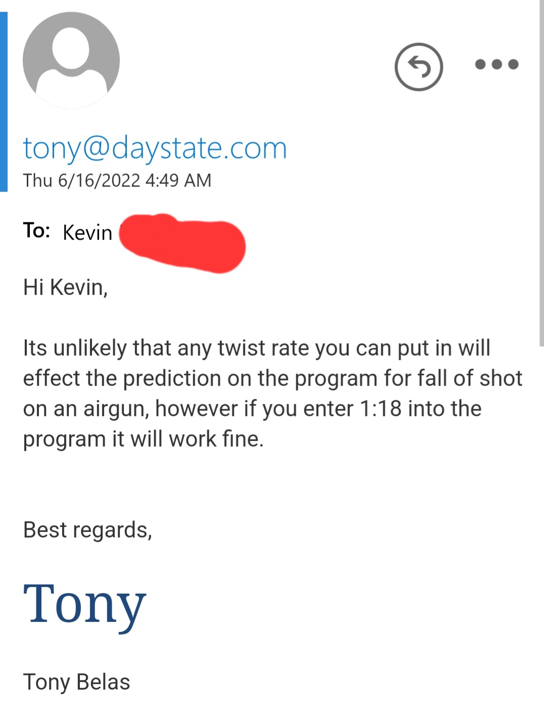

With that said I wanted to know the barrel twist rate for my own knowledge (don't see the big deal in being so secretive) as well as for entering it into strelok pro. Whether Tony at daystate is correct or not, a lack of response would have been less than a slap in the face than this.
Love the rifle, love the build quality, I just find this to be a little disappointing after a customer drops $3500 USD on one of their products.

That's actually a reasonable response. It takes some work to get the predictions to work. If put in the variables exactly "correct" you get a bad appriximation of theoretical. If you put in the variables in close enough but you adjust to test data from shooting accurately you get much more accurate predictions. So it doesn't matter if you put in 1:17 or 1:19 or their magic secret number. Without adjustment to physical reality of velocity at 2 or more distances the predictions will be off.

I get that, however...
The question wasn't what will work in strelok pro, the question I asked was what is the twist rate of the barrel in my rifle.
Like I said "Whether Tony at daystate is correct or not, a lack of response would have been less than a slap in the face than this".
Also with my Taipan , everything I entered in strelok pro, I tested the first dopes it gave to me and checked ranges with a quality range finder. It was spot on.

Couldn’t agree more, I tried on multiple occasions to find the twist rate but no luck. I use twist rate to determine which slugs I want to try(calculate stability factor) so it’s an essential piece of information for the gun owner especially after dropping 4k on a gun which isn’t trivial even in higher end center fire world.
Trying to measure with cleaning rod is error prone especially with polygon barrels. Again, this is after dropped 4k after shipping and tax! This is one of many reasons I don’t own a DWolf and very unlikely ever will.

Not sure why Tony didn't respond more informatively but there are 2 barrels that have been shipped on DW's... maybe he doesn't know on your particular one. The earliest 22s were 1 in 17.7... a standard LW like has been put in all the Daystates for a long time. Latest ones COULD have a 1 in 30 modeled after the larger calibers ART barrels. I've been testing one for a while as have a couple more people but I'm really not sure how complete the transition is or what shipments they started showing up in. They are VERY good for pellets but my slug testing so far is limited.

If its a 1 in 30 that shows to be not very promising, if its 17.7 that would be great but with the Alpha Wolf I doubt it got that because the Alpha Wolf as I understand is the mass of all revisions done to the DW along with a pretty stock.
