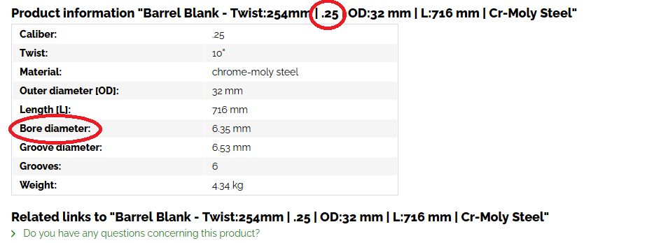

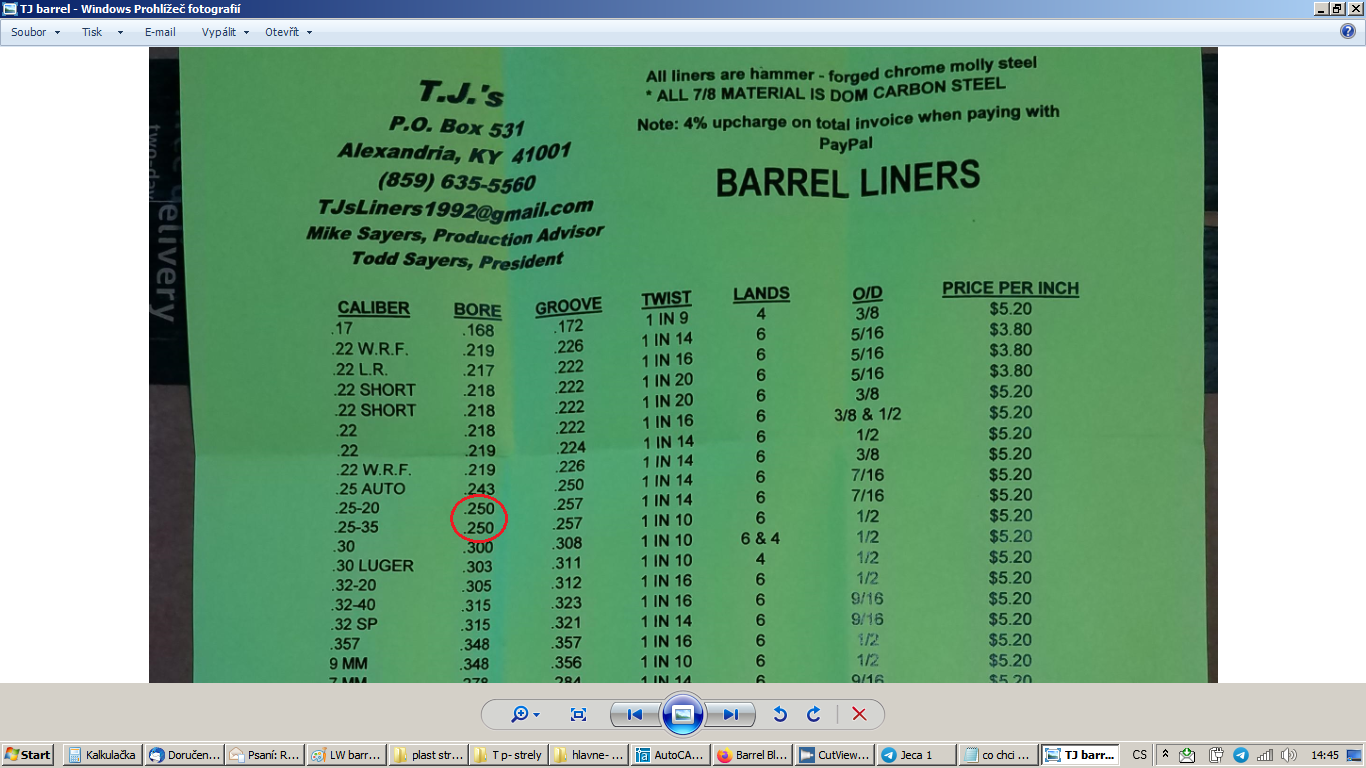

here is an example of a LW barrel marked .25 caliber:
here is an example of a TJ barrel:
therefore, if you do not know whether slugs are suitable, write to the airgun manufacturer to give you information about the barrel Bore diameter, because the marking of the caliber is not uniform.
