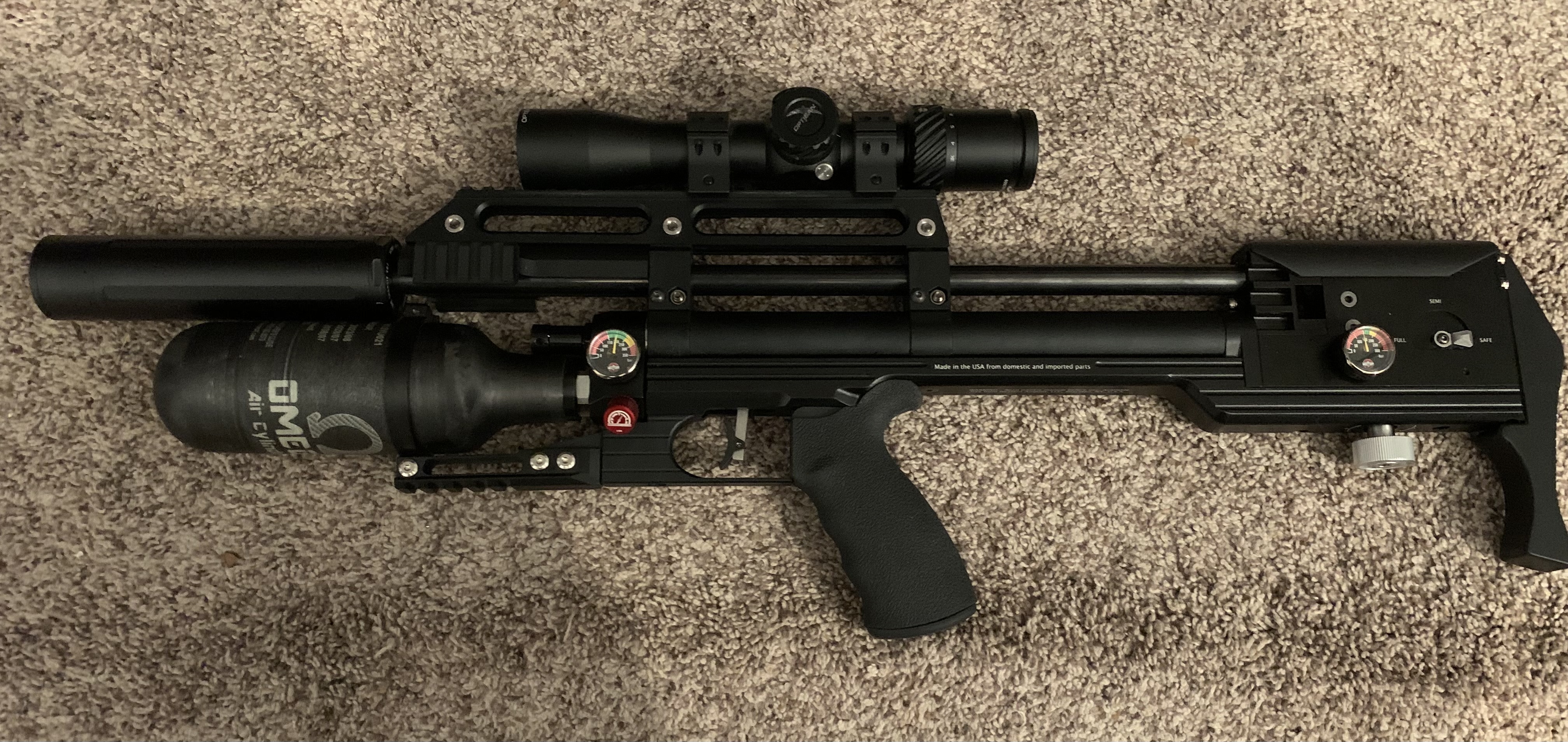

Here it is with a compact Optisan scope and the Sumo. I think it looks better and feels safer not to have the supporting hand so close to where the pellets emerge. The compact scope is on low rings. I tried a full sized scope and it felt like a suitcase with a trigger!
A 480cc bottle would probably match the length of the Sumo. Might as well up the shot count.
