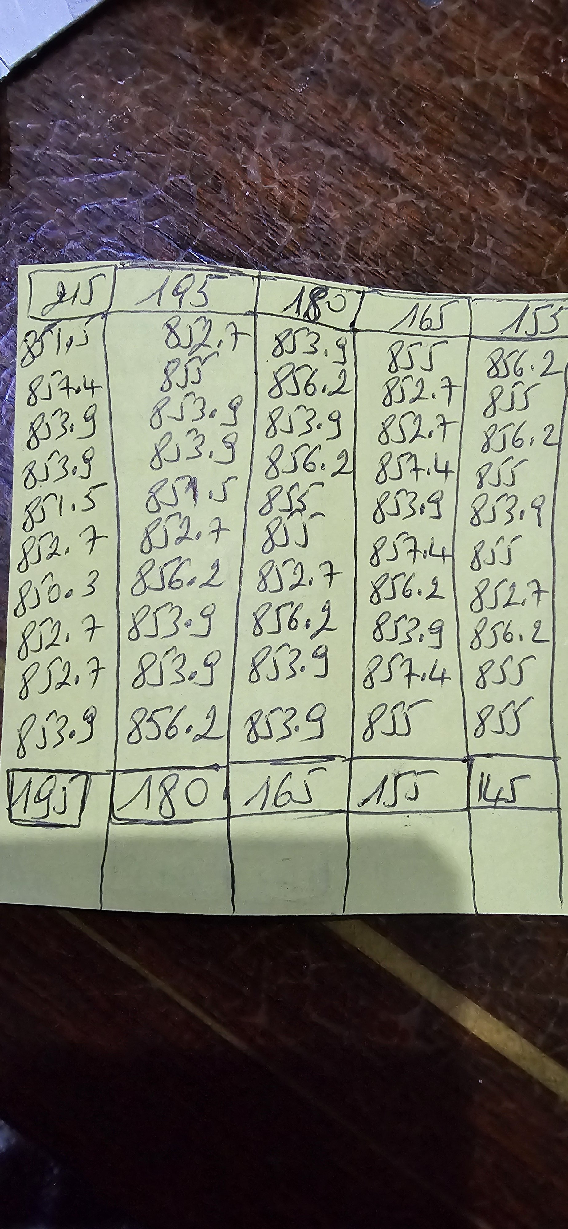

to me , he needs a full shot string, well the end of one , does the velocity go up near the end or does it gently slow down, or drop like a rock?
but the 852-856 fps looks darn good

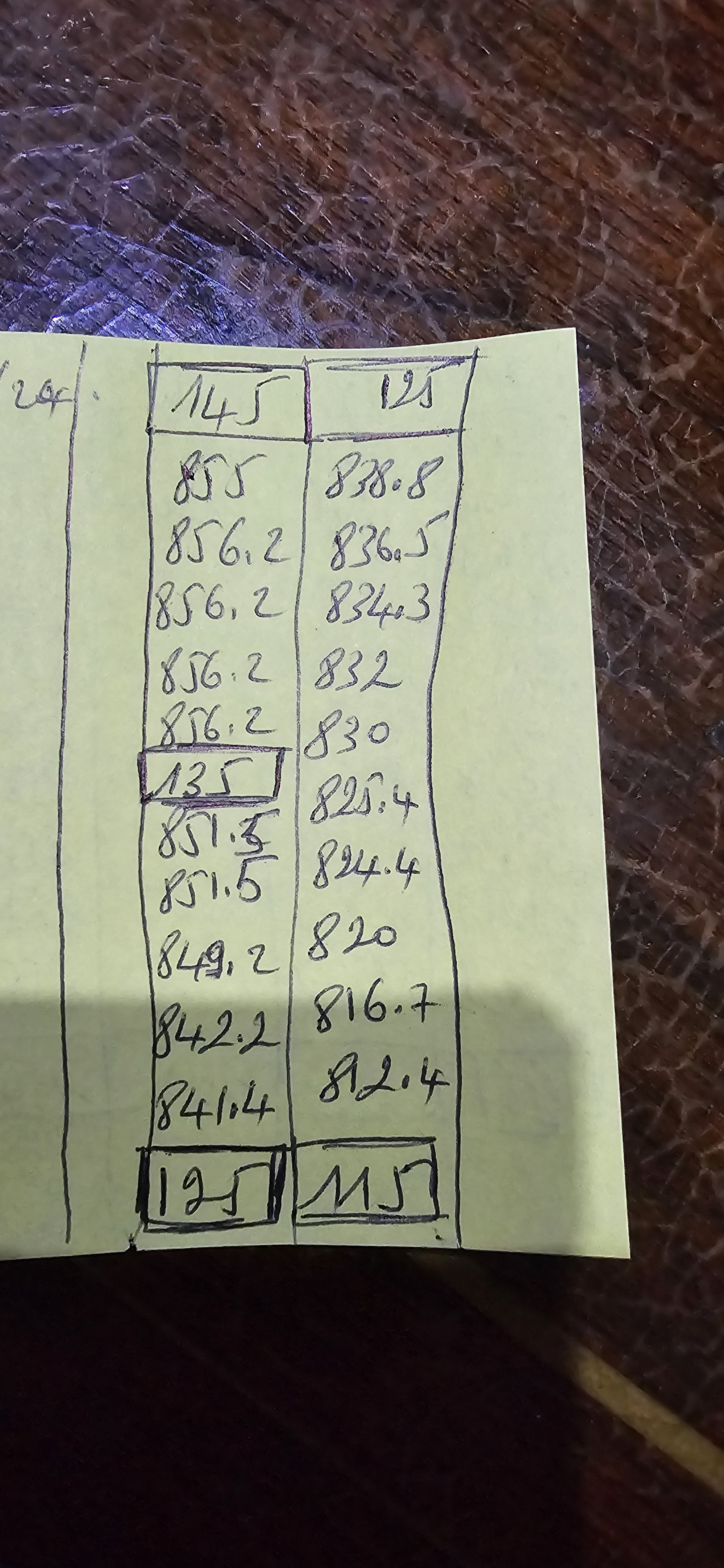

I just did a full shot string from 215 bar to 115 bar attached are the results. Velocity dropped when the pressure reached 130 or 135 bar.
Btw from 230 to 115 bar took 80 shots.
