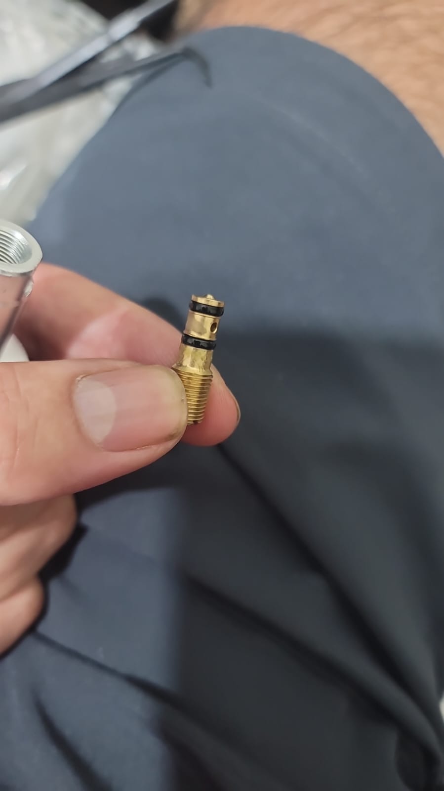

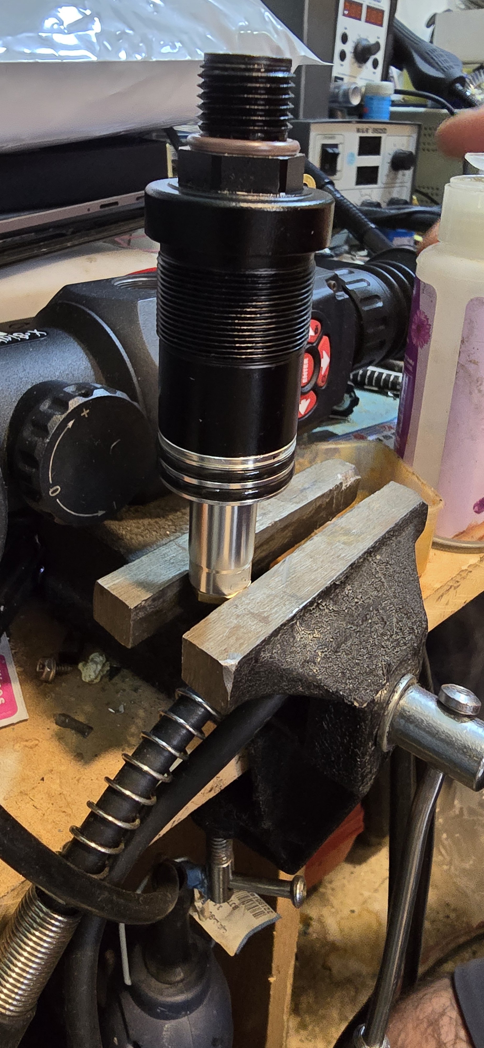

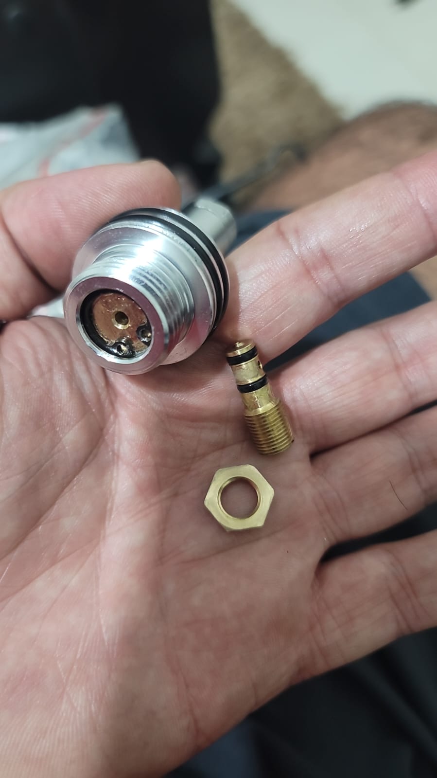

Looks a lot like the Huma in my Caiman. You need snap ring pliers to take off the snap ring and look at the bellville washers. In my Huma they were caked in silicone grease. I agree, that looks like a lot for the adjuster screw area but I don't understand what issue it would create. Having the bellville washers coated caused my velocity to be somewhat erratic, I think. My regulator stopped working because the one O-ring on the adjuster screw did not have enough silicone grease on it and failed, I think. I changed it, flipped the white plastic disc that is on top of the bellville stack sealing the hole to the adjuster area and the regulator worked. I would change the O-rings on the adjuster screw of yours even though they look OK. You do not need visible globs of silicone grease on them but they need a thin film of silicone grease. I would also flip over the plastic disc over if there is one on top of the bellville stack. A new one would be even better but at the time I did not have one and I assume you do not for your P15.
I would also take a picture of the washer stack before you disassemble it. You will want to put them together the same as the factory. If they look OK, you don't have to disassemble the stack. You could just flip the disc, change the O-rings on the adjuster and see if you are successful.
