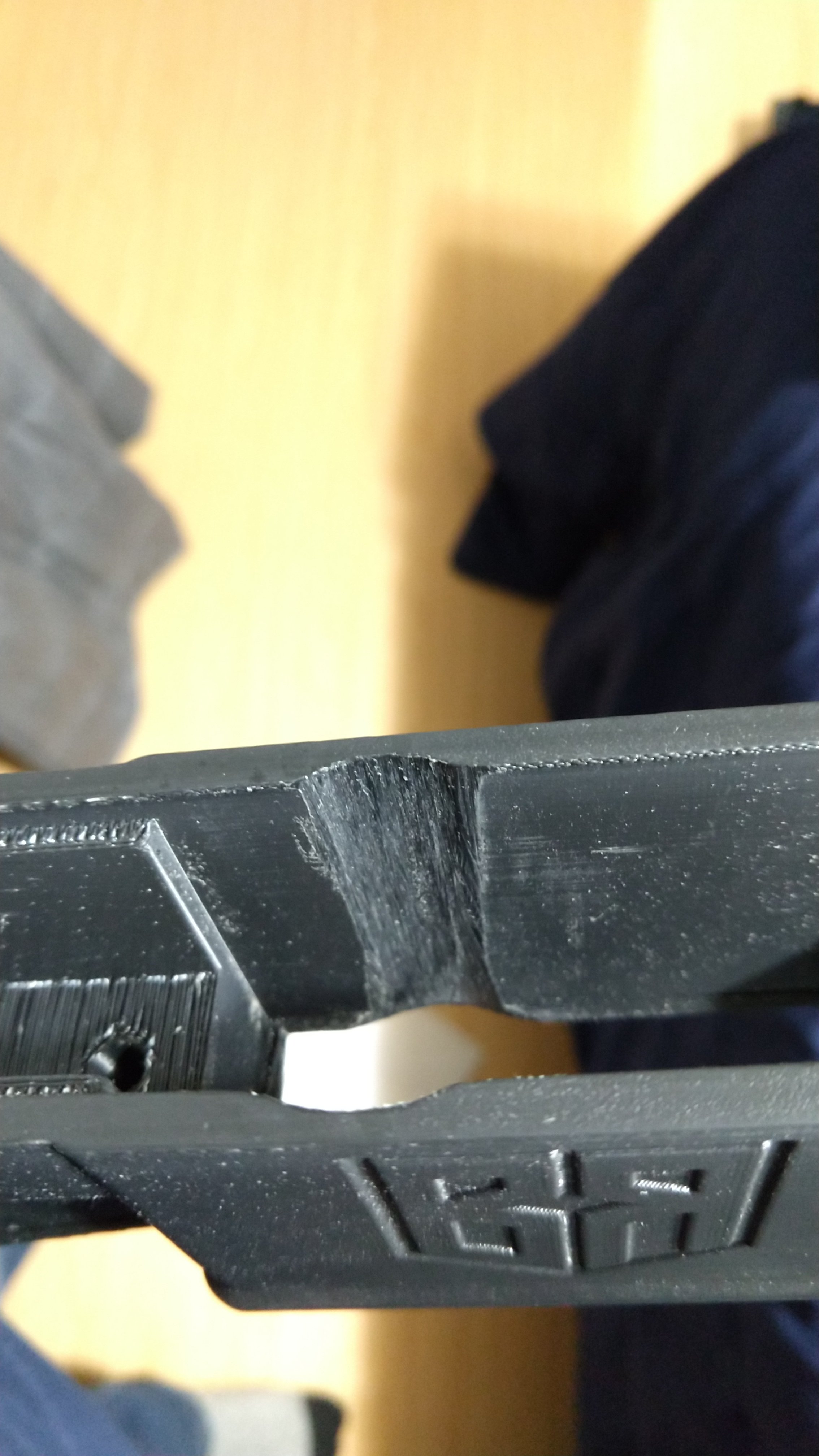

The only issue I had with the AE Swede adapter is that the I needed to cut out a spot for the flat piece you put on it before the buffer tube. (Not sure the technical term, but they make these aftermarket plates with sling or QD attachment options, may swap to that.) On an AR receiver, there is a recess for the little oval bump on the flat plate so that it all stays together in the same orientation when you screw on the buffer tube and your stock is straight up and down. I used some calipers to locate the spot on the AE Swede adapter and chiseled it out. Very easy as it's towards the bottom. Sorry, this is my 1st post and I can't attach a photo. But now the buffer tube is locked in it's orientation. Technically you could skip this and screw just the tube in but I liked having the metal plate there. The adapter threads are real deep, so I think it would be secure. I ended up putting a side folding hinge adapter on because a guy on YouTube suggested it because when you have these AE Swede type adapters you cannot access the hammer spring adjustment screw unless you unscrew the buffer tube. (yes, there is a cutout for the screw, just can't get to it with the tube there, same hole). The side folder works great, and I will have access to the hammer adjustment. Also found on eBay.

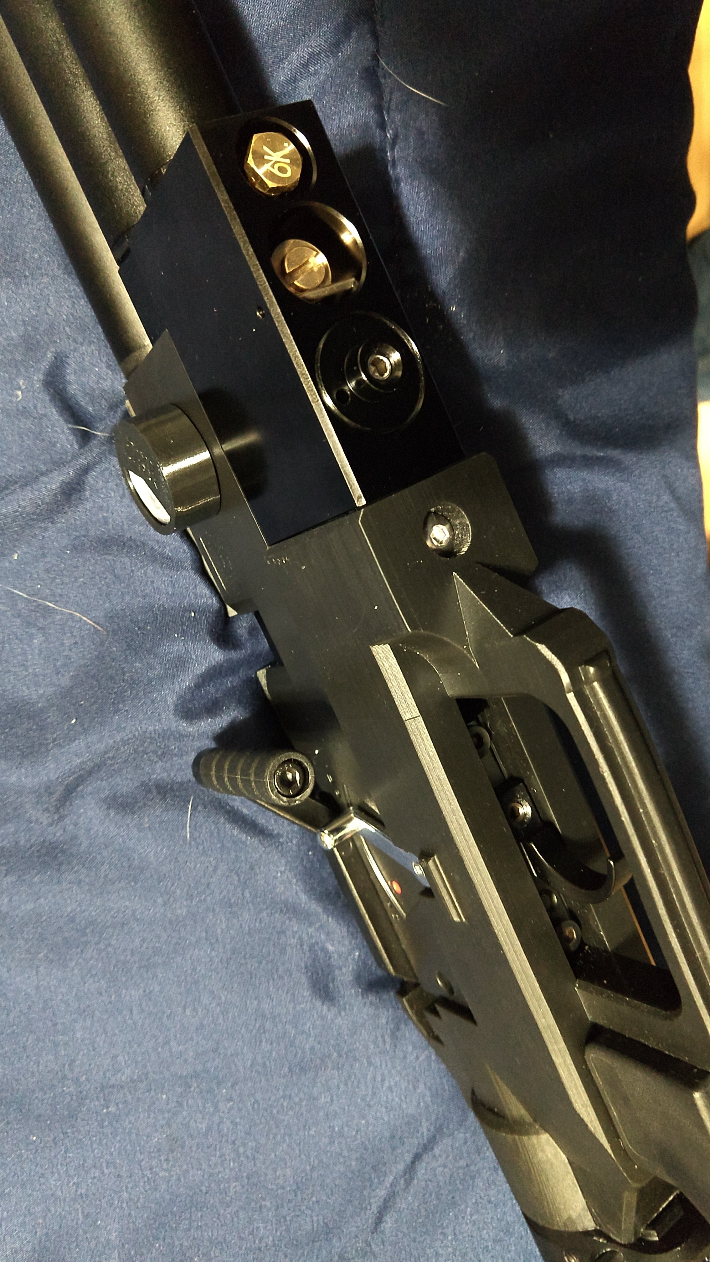

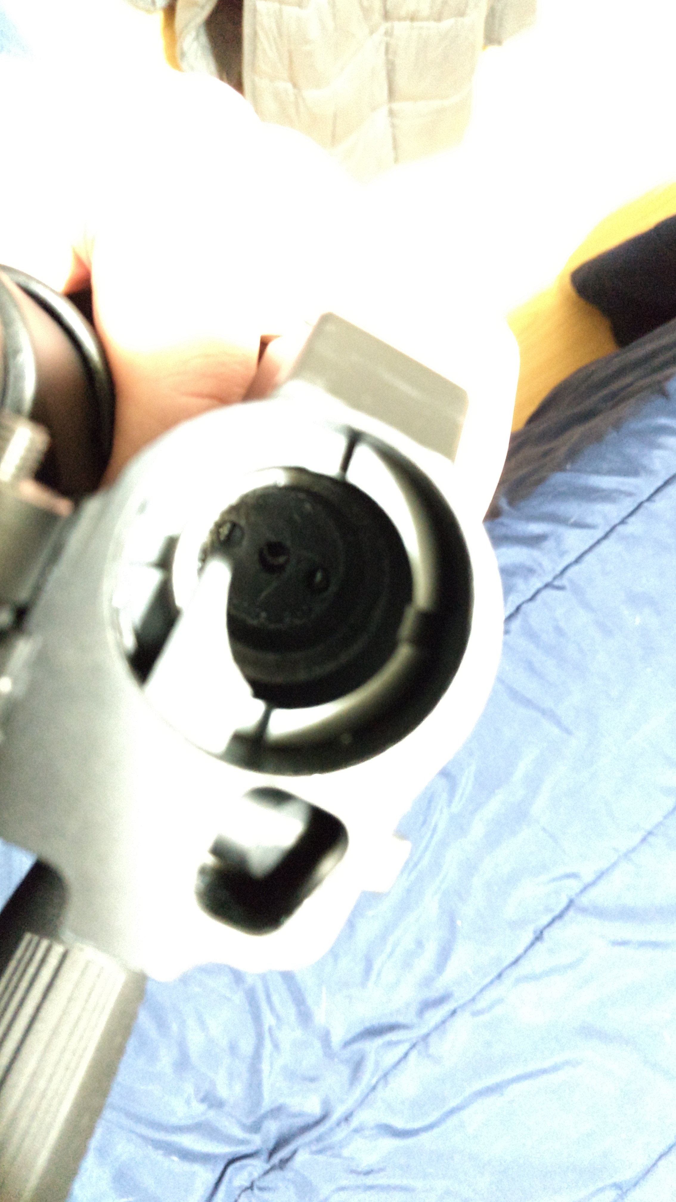

The BR version goes out further than AE Swede by having that AR mag well looking part out front. That is where the plenum block is, and I like how it is protected more than Swede being bare but I have a power plenum to install, and the ID of the mag well part is a MM or so too narrow on each side. I'll have to take a semi circle file to it to make it fit. The mag well part is completely an open rectangle on the bottom, so easy access to the adjustments there. On the muzzle end the two sides of the mag well extension is attached at the bottom by a semicircle that'll support the bottom air tube on a stock Avenger. I'm gonna run a bottle so hoping that fits, otherwise a file will make it fit. Because it is just the semicircular support on the bottom, the BR is flexing at the top when wiggled. But with the block in there I bet it'll be solid. The BR is overall thinner than the Swede but the benefit of the BR is it comes up lower on the block so you can get to the hammer spring adjustment without needing a side folding adapter. That's why you need the comb adjustment stock. Other thing to note is BR is only connected to the block by ONE screw where Swede is a couple.

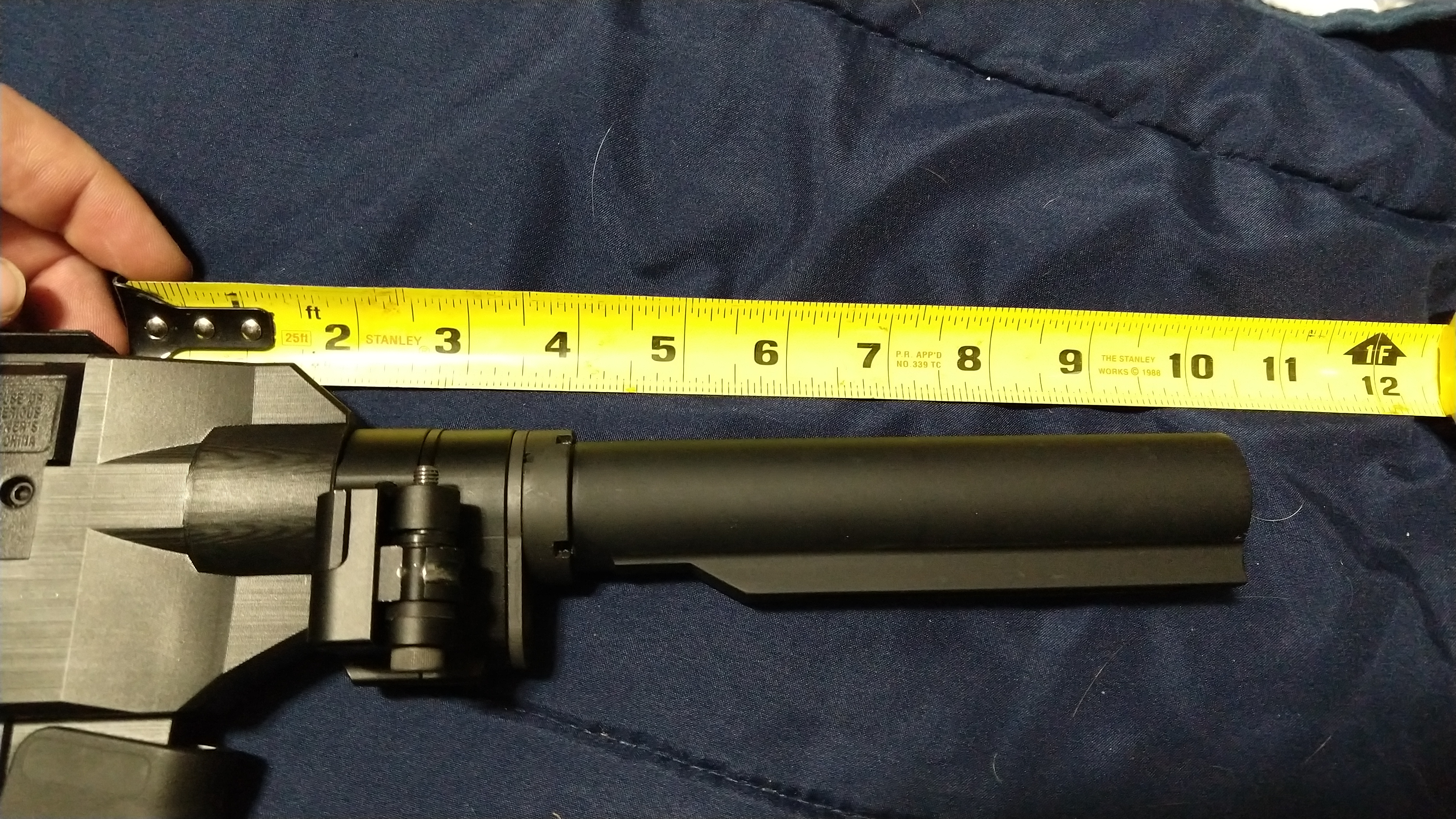

You can't tell from the BR YouTube install video, but the BR "buffer tube" is keyed vertically by a bump and a corresponding slot on the frame. So your tube/stock will not rotate. Pro of BR is it is screwed onto a nut, not threaded into the 3D printed material like Swede.
One thing I noticed right away on the BR when I put on a super generic AR collapsible stock is that on the BR the length position locks in however the pin that goes up and locks in on the stock isn't all the way in. Like it could go in another 1/4 inch so the lever you press to adjust the length is loose. The buffer tube OD is the exact ID of my stock though, so it doesn't wobble and it takes some effort to change positions (friction). Downside of BR version is the tube is 3D printed, not the metal, real AR buffer tube like on Swede version, which lets the stock lever go all the way tight.
So...as you can see, pros and cons of each. You're required to order BR's buffer tube b/c standard AR tube doesn't work, so BR ended up being $65 shipped b/c you need the frame and tube at the minimum. Swede a standard, Mil Spec tube screws in however it blocks the hammer adjustment so you'd need a side folding adapter or to unscrew it every time to adjust. It's $35 for Swede plus shipping. It's kind of a wash for price once you add in the adapters and stocks required. Swedes has better finish (don't see any stringing, is all smooth, very fine layers, more sturdy). But BR has the added protection to the block and the easy access HS screw. Both take standard AR grips. BR comes with one.

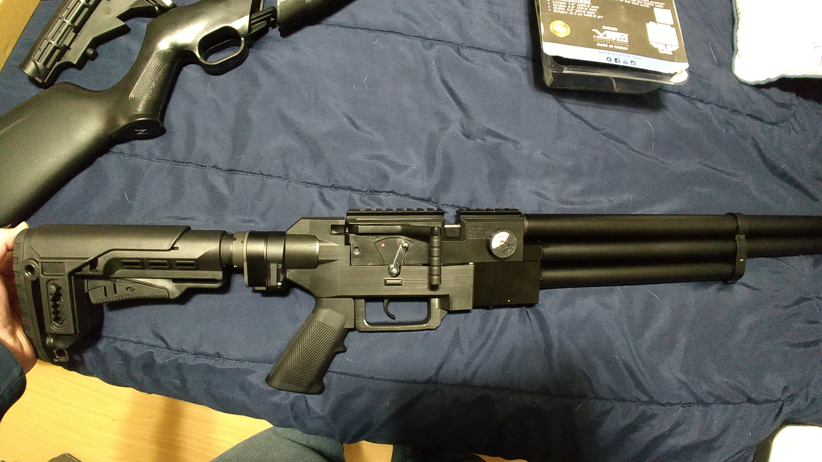

If you don't go for the tri rail due to weight, you definitely want a triple tube barrel band to keep everything secure. I'd stick it furthest out towards the muzzle as possible. There's a few available on eBay that are 3d printed. I think I'd go for this one from dadr-232
But it's $9 more than the BR and you get a lot less rail slots as well as the BR protects your air tubes more. Plus if you're doing all BR there's that 10% off the whole kit deal. FYI Just checked and BR is sold out til tomorrow.
If you're punching paper on a bench, you might even consider doing a double tube barrel band just before the fill cap by the muzzle to keep it all secure way out there, too.
(Look at photo #6, this is how you should set up the bands if not doing the tri rail) others are also available on ebay or people here recommend Black Arts brand band.

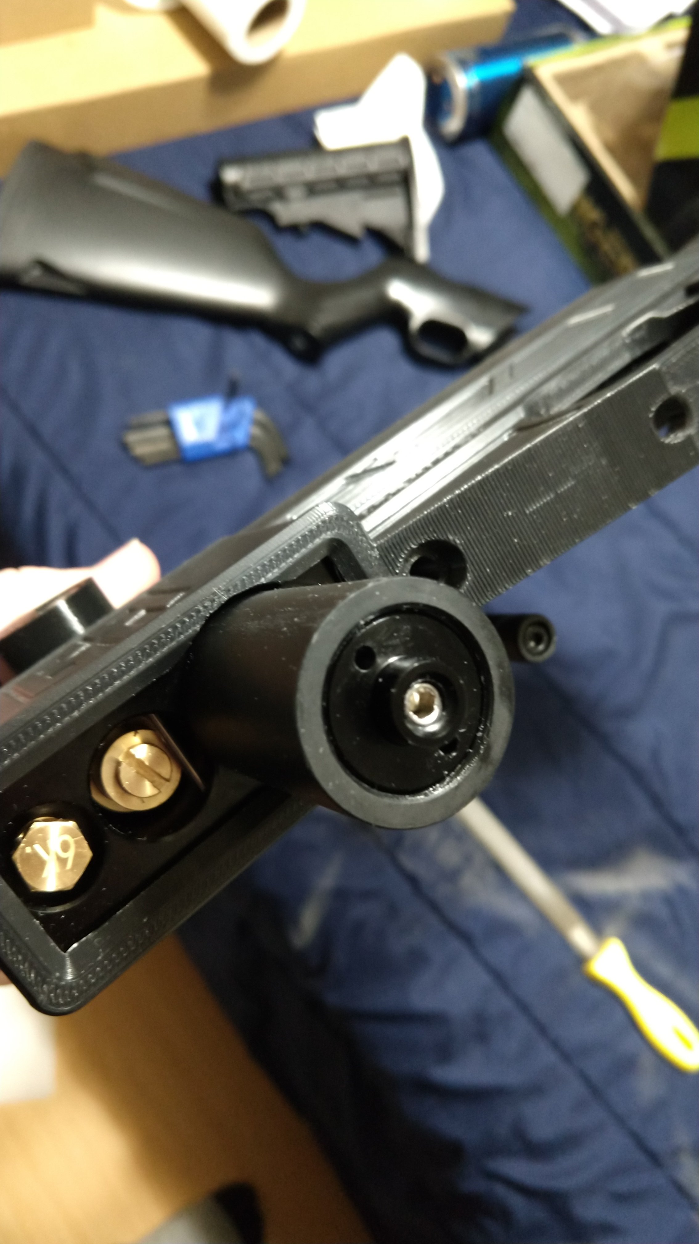

I'm glad you picked Buck Rail because after tinkering around with both yesterday (first time I was able) I definitely give nods to BR. The dimensions are much more accurate. It slipped on tight over the block and there were no gaps. Because I was doing a power plenum and bottle, I had to use a file to get it all to fit. Had to file the "mag well" inside as well as the front where the bottle adapter goes because it is wider than the stock tubes by maybe a MM.

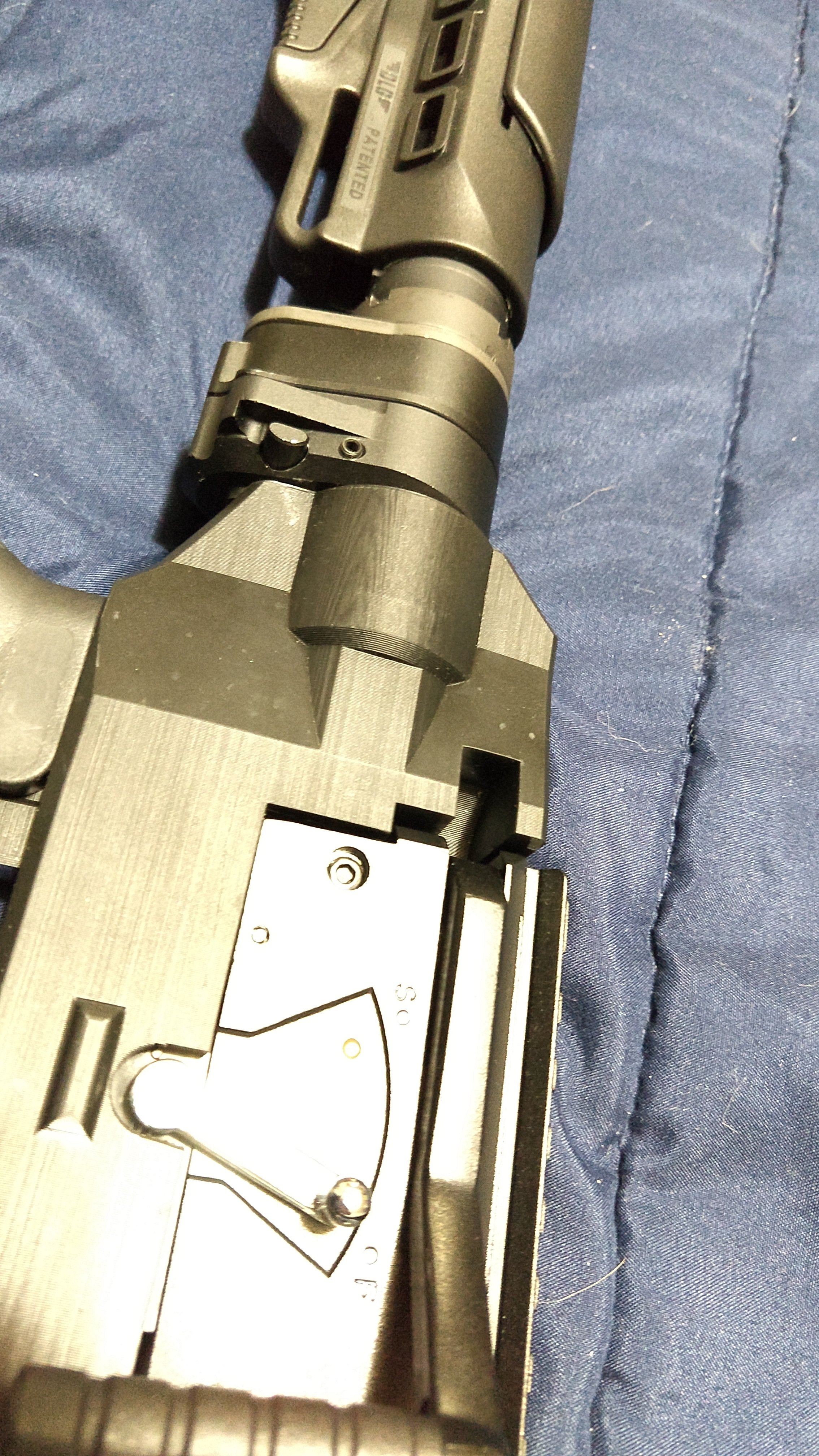

My AE Swede had gaps around it and also the front screw wasn't wanting to go in. Not sure if the supplied screw was too short or if the angle of the AE frame hole was crooked. Rear went in but again it's into the 3D material not a nut like Buck Rail. I suppose I may have gotten a "Friday afternoon run" frame from Swede but it doesn't leave a good impression especially after I've had troubles getting an email back from Swede on a barrel band I ordered Dec 6 but have not received yet. He emailed back last week saying sorry they'll get one out and was nice but the tracking number still says USPS hasn't received the package. So I emailed back on the 23rd asking if it's a new tracking # but he hasn't replied. I get Christmas affects things but if I were running it I would have personally shipped a new band out FedEx overnight shipping..
I did however use his Swede dual reg adapter, metal threaded barrel shroud spacer thing, and 18 shot magazine which I got and all went together great. The band is for 61mm bottle and mine is 60, so I have a slight gap. Should have measured, that's on me. Thought it would clamp enough but nope. So his products are good besides the V1 frame, or at least my example of it. Maybe that's why his V2 frames sell for a lot more on different sites. I can't tell any differences by the photos though. The descriptions are the same so not helpful.

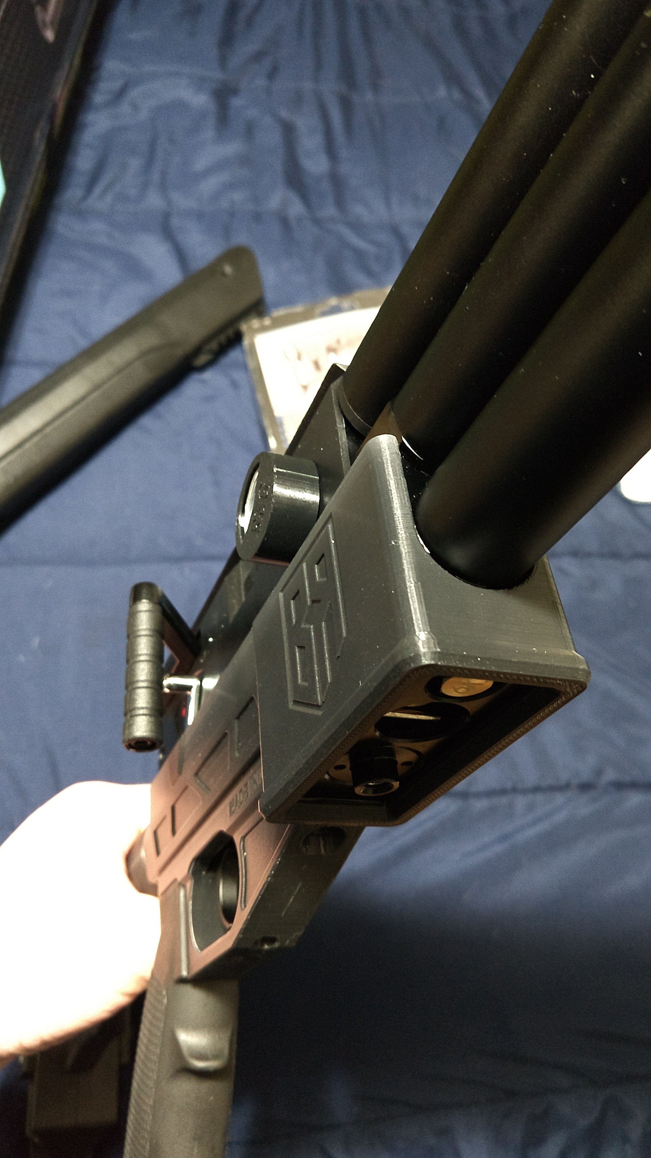

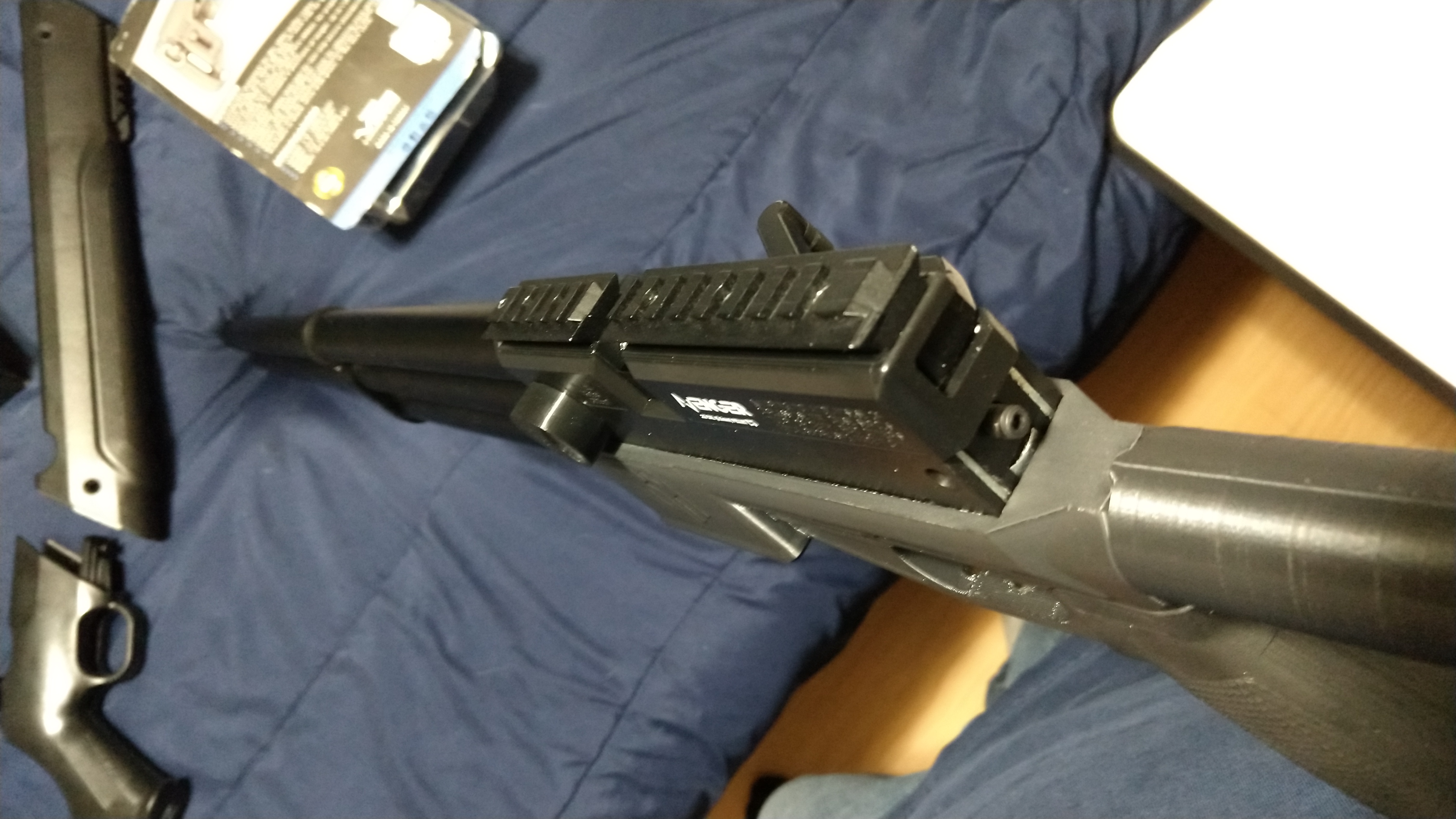

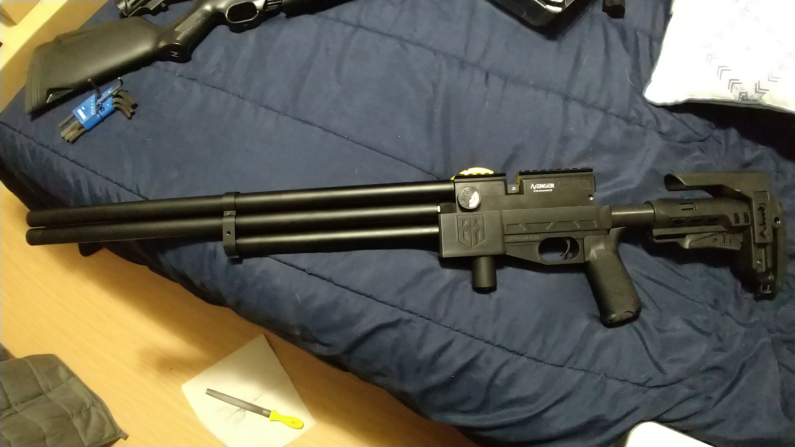

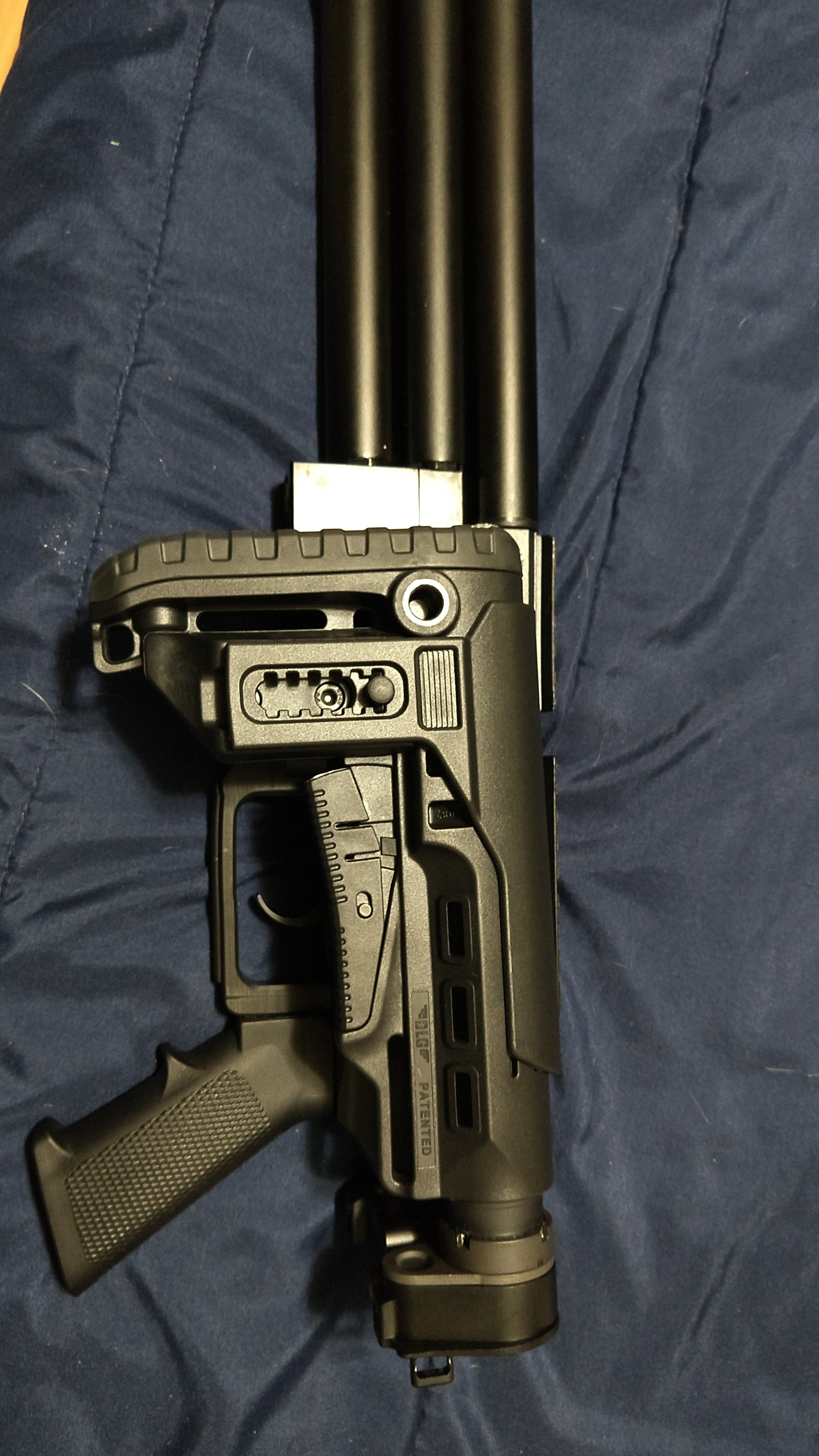

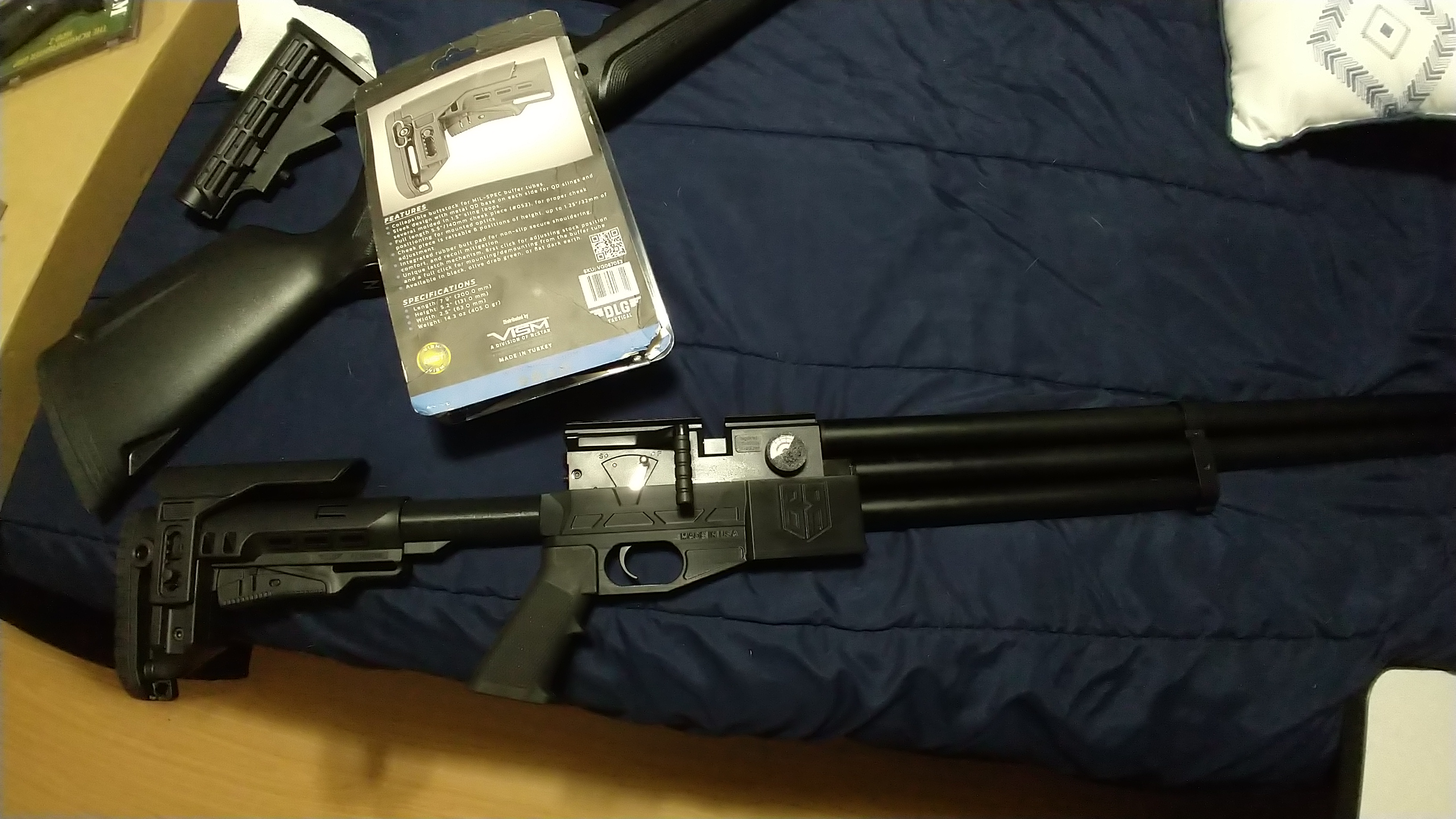

Sorry if theyre out of order, but I took a few photos of each stock on with the tubes for you to get an idea. I've not uploaded photos here yet so let me know if they need re done.

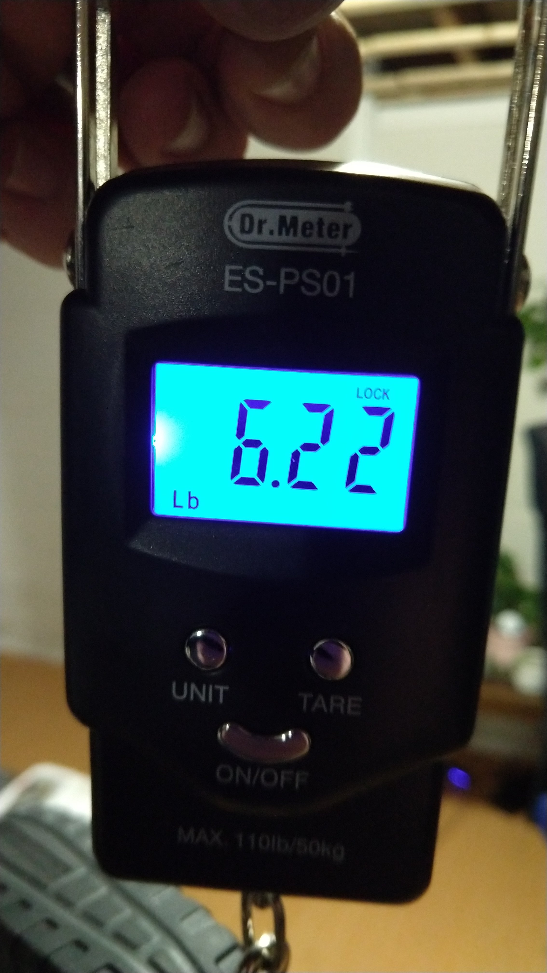

The BR is going to be at that weight with stock air tubes but without a scope. It has the stock I took a picture of the SKU on it, which weighs like a pound by itself. Needed for comb height adjustment. But amazing it's lighter than the OEM stock's 6.4 lbs. I put a BCM mod 2 grip on there and filed the #3 size beaver tail down to fit. So that's slightly different than what comes with the BR kit, too, but I prefer this grip over the A2.

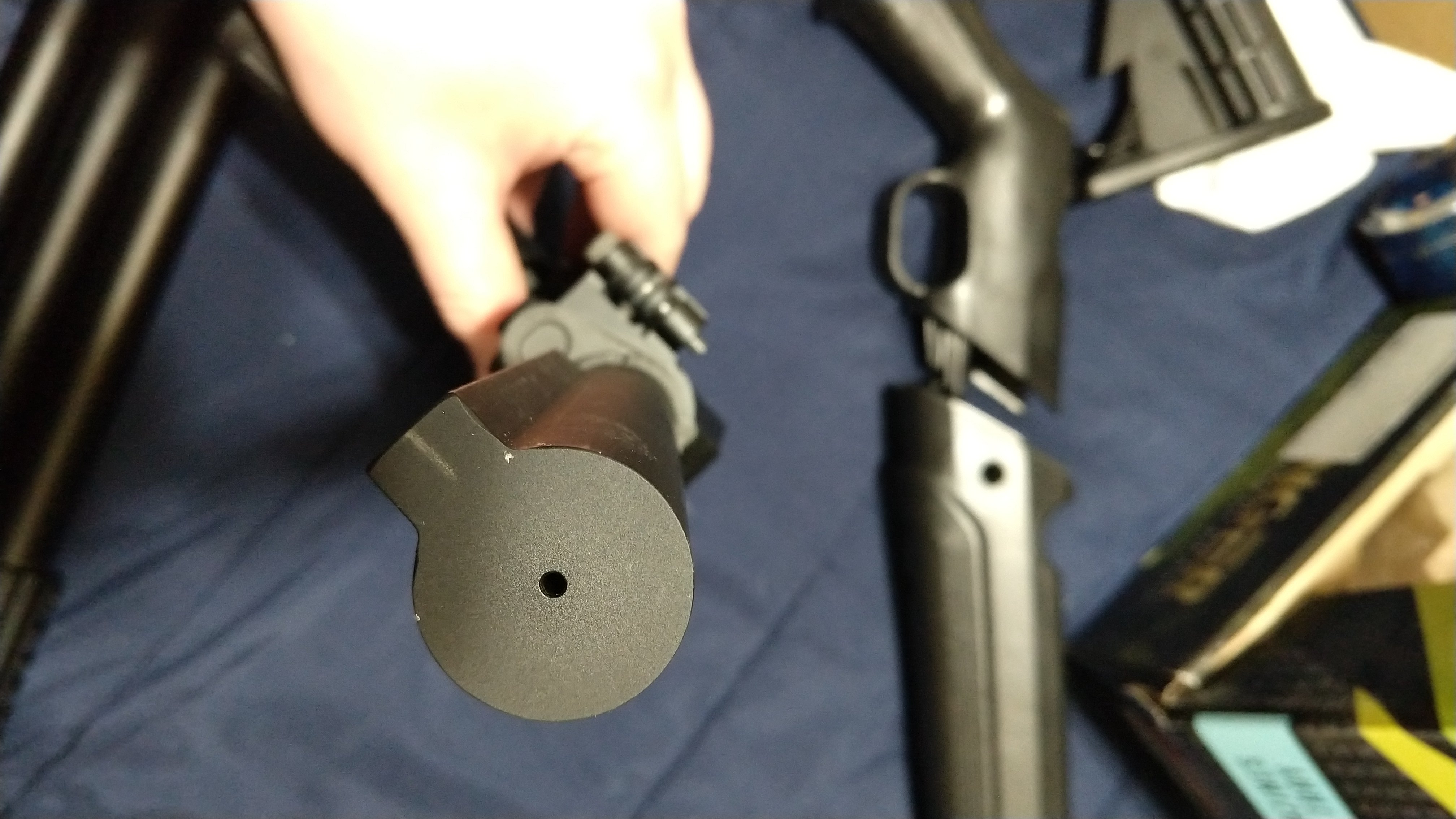

You can see the side folder on the Swede and the hole in the back of the buffer tube in these. It does look cool with it folded but those gaps aren't gonna work for me. You can see the hole for HS through it when folded.

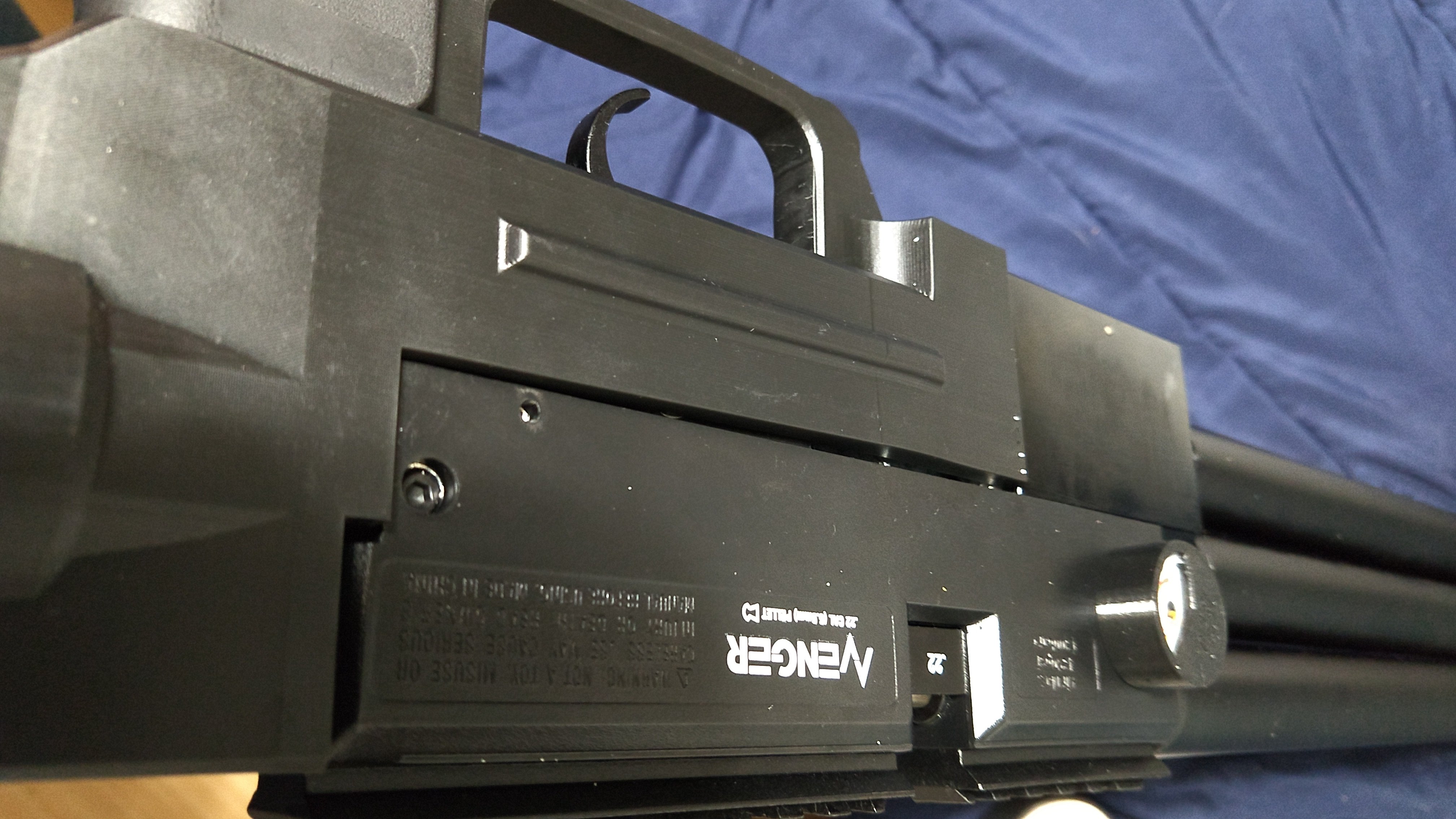

I settled for the Buck Rail and am happy because it covers the front block unlike Swede but I did have to file to fit my upgrades. Fit great on stock tubes though. No issues with it only having 1 screw holding it in, either.
