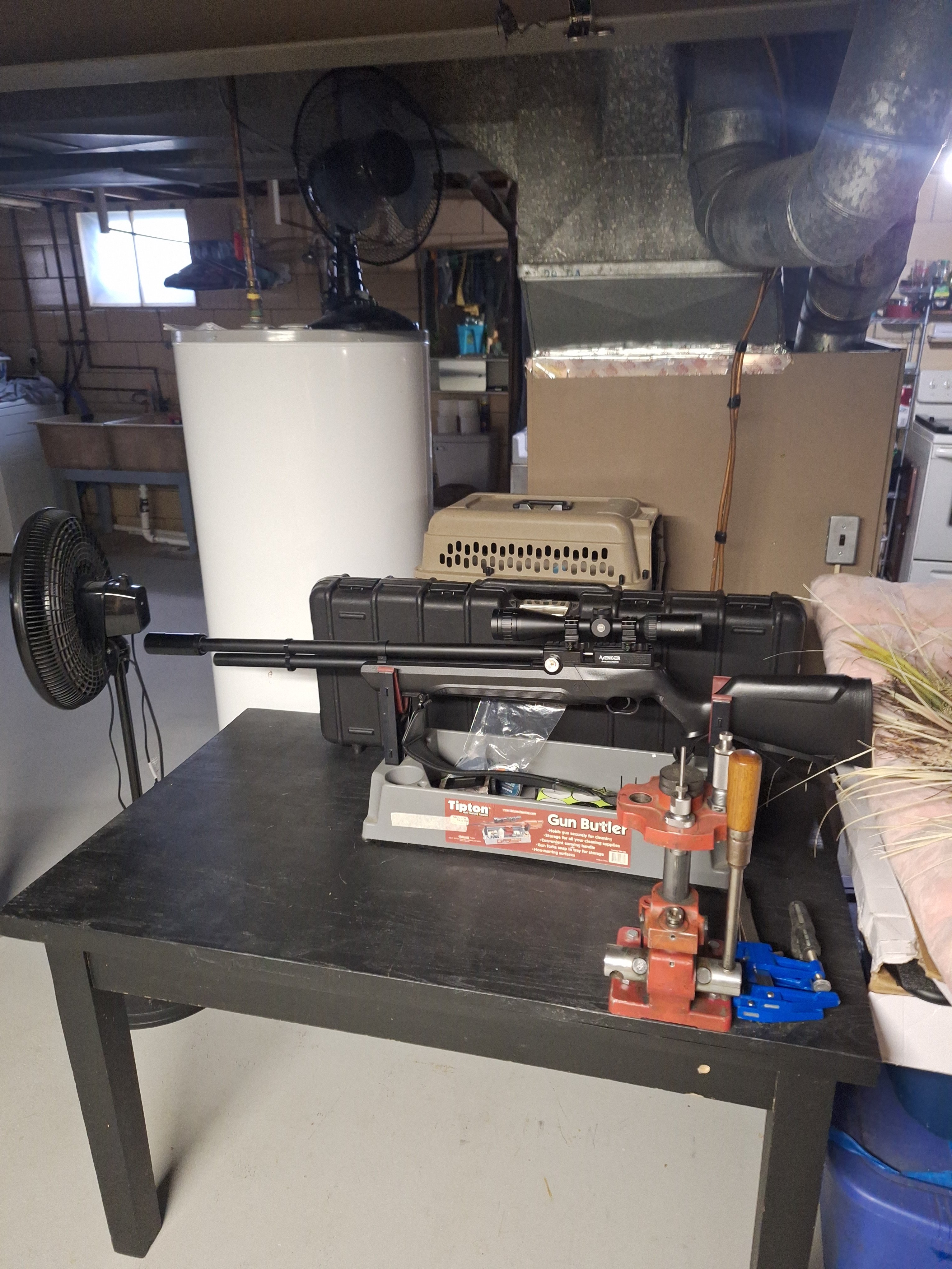

Well one of the members here had a great deal on a .177 avenger and I couldn't pass it up. I purchased this for pest control I do at a pig/cattle farm locally and I think once I tune it up, it will work perfect.
Currently I use a .22 FX Crown for all my pesting and it works great but is overkill at 30ftlbs for sparrows (mostly what I shoot). Most of the shots are 25-75y with the bulk being around 50y. Over the last couple years of being there I decided a powerful accurate. 177 would be my best bet...
Tuning... I looked all over for some type of guide for .177 with really no avail. Since I know these run super hot, I plan to use a 13+ grain pellet or slug. When I recieved the rifle, it was set with the reg at around 1600psi and no idea on the hammer spring..yet. however I couldn't get really decent groups with any weight pellet until I gave the reg a boost to 1800psi and the hammer spring a 1/4 turn in. Currently shooting 10.65gr Baracudas at 925fps (a little hot) but accurate to 50y.
I'm going to try to redneck document everything for the tuning process (within reason) due to the lack info out there on the 177 platform. I have a new shipment of projectiles I'm going to work on (and a new chrono) to hopefully get this thing launching some heavy pellets or slugs at a decent speed.
If anyone has suggestions on tuning settings for the 177, or what your getting, please let me know. Overall, I'm in love with the shot cycling and trigger weight. Such a fun rifle to shoot and with the Tatsu it's quiet, at least for now lol. PS: Don't mind the horrible mess in the picture I just took one quickly for the post!
If anyone has suggestions on tuning settings for the 177, or what your getting, please let me know. Overall, I'm in love with the shot cycling and trigger weight. Such a fun rifle to shoot and with the Tatsu it's quiet, at least for now lol. PS: Don't mind the horrible mess in the picture I just took one quickly for the post! View attachment 517171
