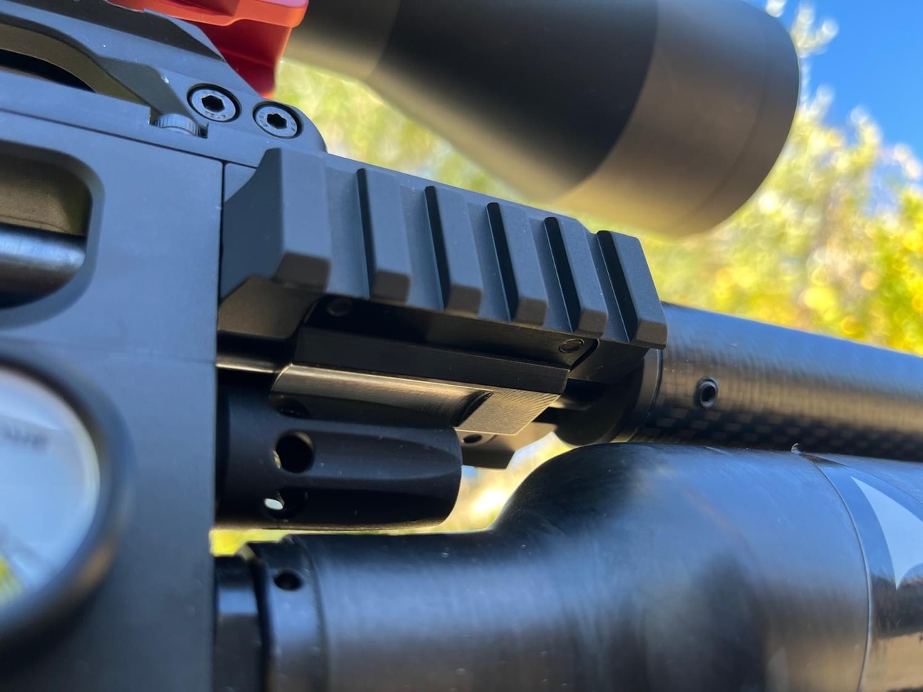

Hello, Since this is my gun pictured here, I thought I would answer and let you know..... the "tensioner kit" and the "clamp" (pictured on my Ghost here with a 28" barrel) are two different items. The clamp can help with vibration and I personally find it helpful on the longer barrel. It seems to give me more stability with each shot. I did not find it as helpful or needed on my short .177 barrel. The "tensioner kit", also referred, to as "Barrel Tuner Kit" (NOT shown here) "Adds barrel stability and reduces vibration by allowing user to change barrel tension and harmonic frequency for different calibers, pellets etc."
I chose the clamp as I wanted less vibration and I wanted to use my moderator while shooting. I have not personally tried the "tensioning kit" and I do not know if a moderator would work with it, but I do know Fady did not use a moderator at the Worlds.
