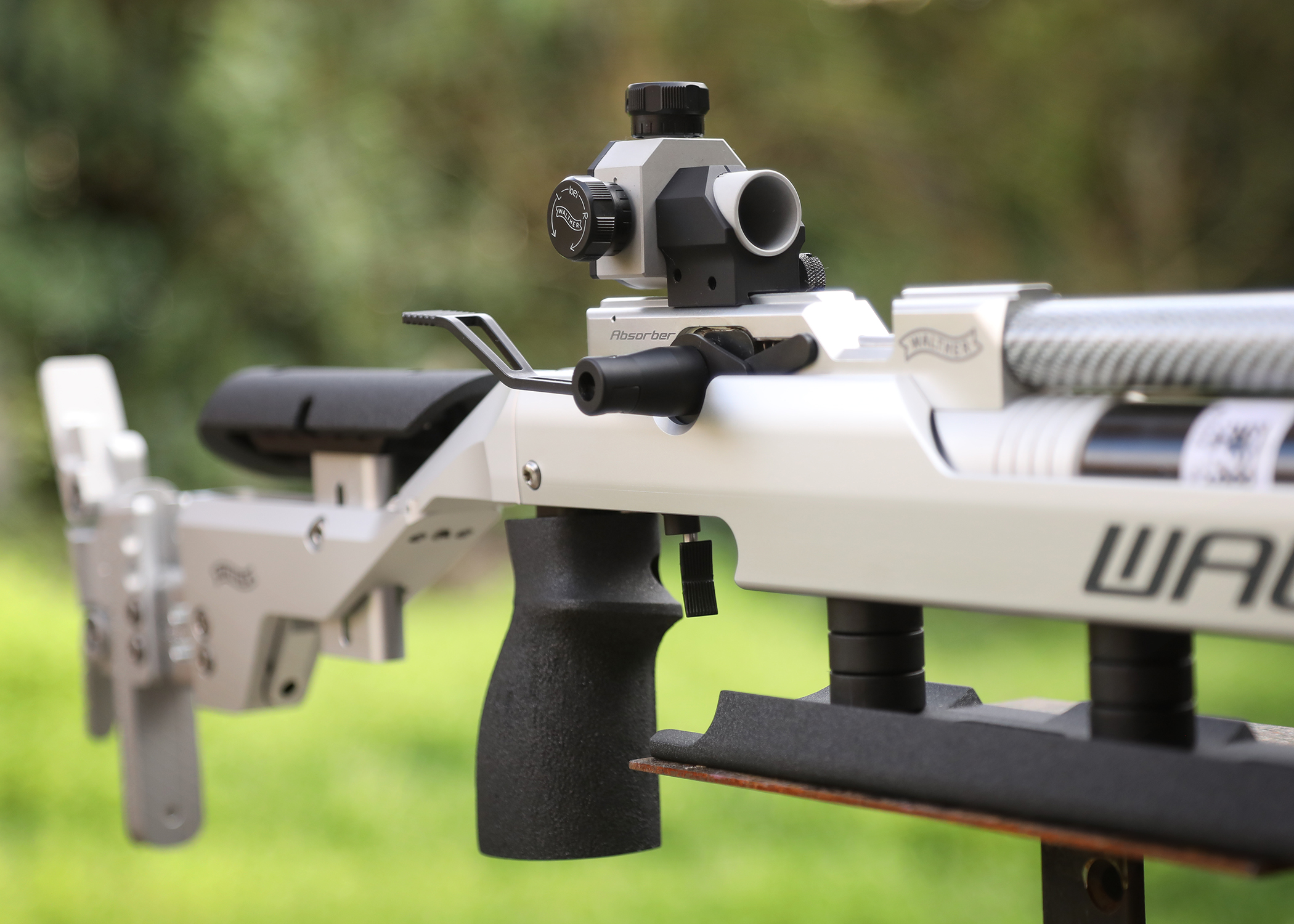

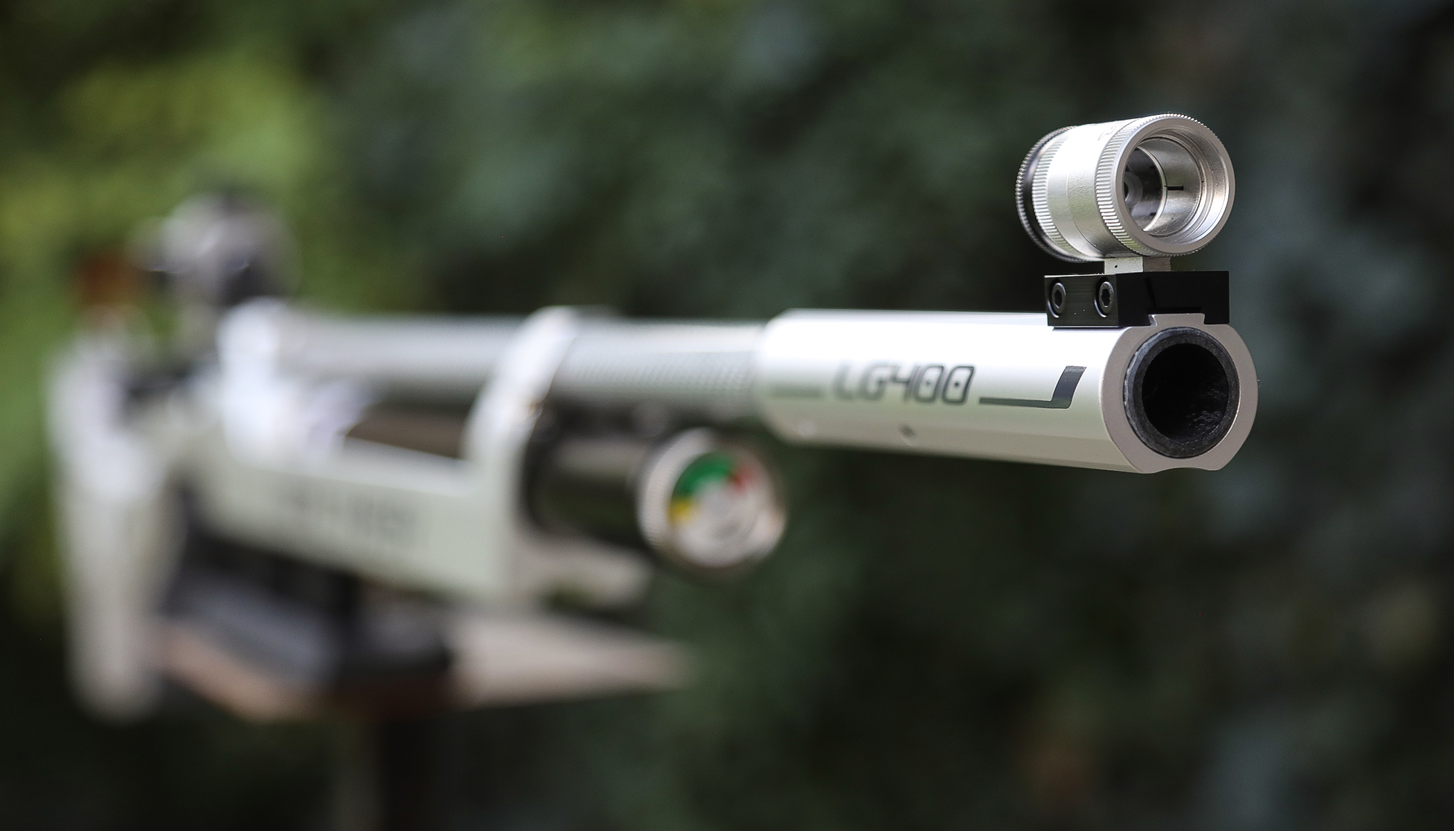

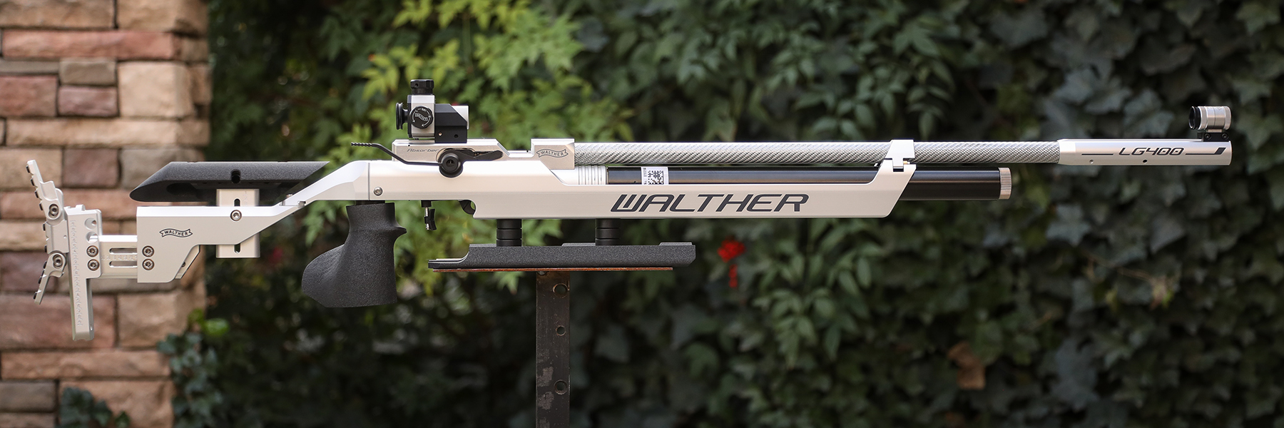

I haven’t put her over the chrony just yet. Through a strange twist of fate and a shining example of my own “ADDICTION”, the UPS driver that delivered my AR2079A also delivered my new Walther LG400. The Walther has been receiving more of my attention. I know, I know, I may have a problem😂. I will make an effort this weekend to put them both over the chronograph.

Nice Pic 📸 wow!
