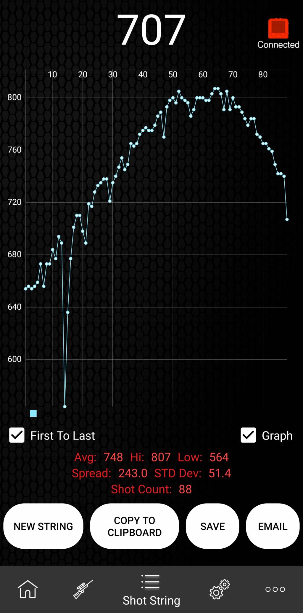

I have already found the cause of differing fps's in shooting. It is a very simple issue. Nothing more that a change of steel the hammer rides on and the poppet pin ic made of Easy-peasy! The company is awaiting my suggestions and pic's now. I will be getting the info out to them today. 😉

I have been in constant contact with the factory rep and the factory Forman. I have found several issues and they are being addressed and will be included with teh May shippment guns.
Here is as sort list. The barrels are being re-sourced, The hammer guide rod is now tool steel for the hammer to ride on as the previous rod was SS. As the hammer is SS, It was causing galling and resulted in wildly varying fps. The choke will be loosened a bit and the crown cutters are being replaced to prevent the dreaded ring in the bore apx. one inch down the bore from the muzzle. The re-source will take care of that.

I am working on a degassing solution and next will be adjustable trigger. On a side note, by changing the Hammer Guide rod material, the rough, rather gritty cocking is now liquid smooth. Un real the difference it has made.
