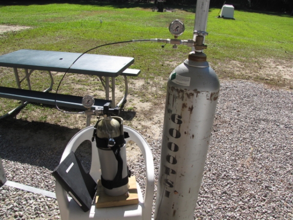

I contacted a local Arc3 gas distributor and leased a 6000 psi Nitrogen tank. Bought a 6000 psi fill assy from Joe Brancato and love this set up.
I lease the tank for roughly $115 to $120 a year. Costs me about $160 to fill it and lasts me close to 8 months. I shoot a lot but mostly .177 and .22.
Depending on where you live you might be able to get Nitrogen way cheaper than I can? I know lots of guys do. I can't believe some of the great prices guys get in other areas of the USA? Also the air we breathe is 80% nitrogen and it's a good dry gas for your gun. No need to worry about introducing moisture to your guns.

Good to hear from you buddy. I've known guys to get the nitrogen for less than half what I pay. If you can get that 4500 psi tank at a decent price go for it. Would you have to bring it to them to get it charged?
Arc3 just comes by and exchanges the tank with a fresh filled one when I'm down far enough below 3000 psi to suit me? Heck I just fill my guns straight from the nitrogen bottle when it gets that low.
I've been keeping mine outside under the carport for years? No problems. I just take my gauges off when they're scheduled for change out. My tank is around 4 feet tall and if memory serves me correct and 9 inches in diameter.
It's heavy, I wanna say close to 400 pounds? Maybe heavier? I think the sidewalls are 1/2" thick? I squashed a set of scales trying to weigh it?

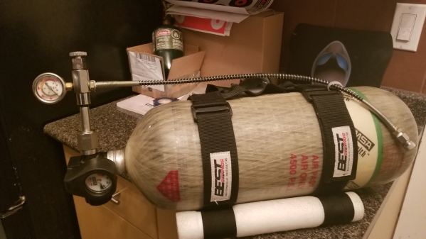

I ended up buying two 6.8 liter SCBA tanks with 8 years left on them and a fill rig for half what Joe sells a new tank for. And these will work great if decided to get a compressor in the spring! I'm learning as I go....it will be great to be free from pumping!!!! Lol.
