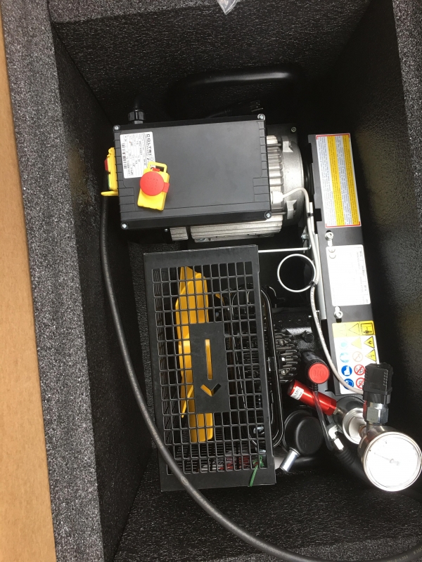

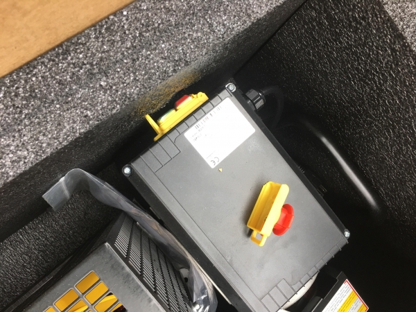

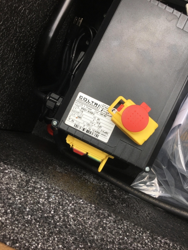

New compressor on the way
just call AOA and order the daystate 110. Compressor, can't wait to have it here

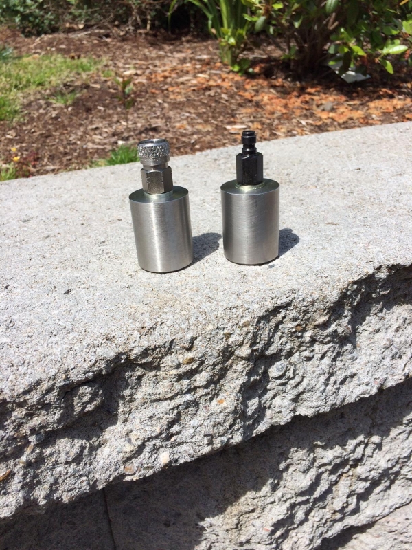

Pretty sure you'll be okay... I had to buy an adaptor for my CGA fitting. I'd give AoA a call tomorrow to confirm.

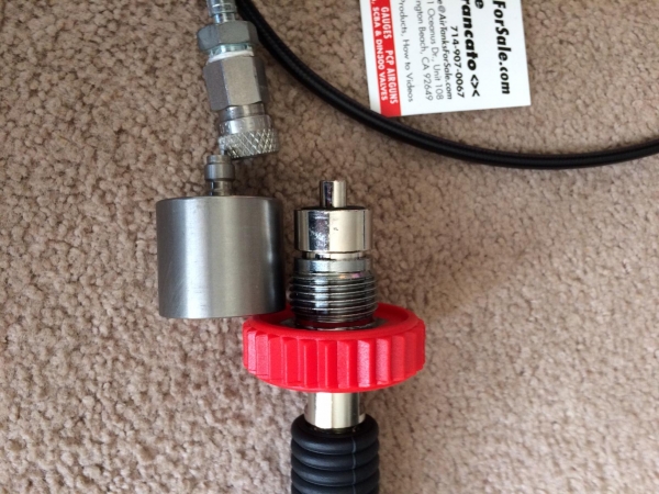

This is my tank valve hope I don't have to buy anyThing else because wife isn't to happy lol
Looks like your tank has the DIN and 1/8 quick connect capabilities... if that's the case, you're set.

I already own a Carette compressor which I am very satisfied with and has performed flawlessly. Had this Daystate/Coltri been available when I was in the market I would have opted for it and added a gold filter to it. I do wish that AofA would specify that Daystate terminate the fill hose with a tank owner friendly Foster quick disconnect instead of the DIN 300 fitting. The fill hose requires most owners to purchase pricey adapters which AoFA doesn't sell. If I owned the Daystate LC110 I would replace the entire fill hose assembly with one terminating in a Foster quick disconnect instead of buying expensive adapters. The fill hose probably connects to the compressor using a JIC fitting so a hydraulic supply store could make up a replacement fill hose at a lower cost than the accessory adapters cost. Small quibble but otherwise a great compressor for the money.
