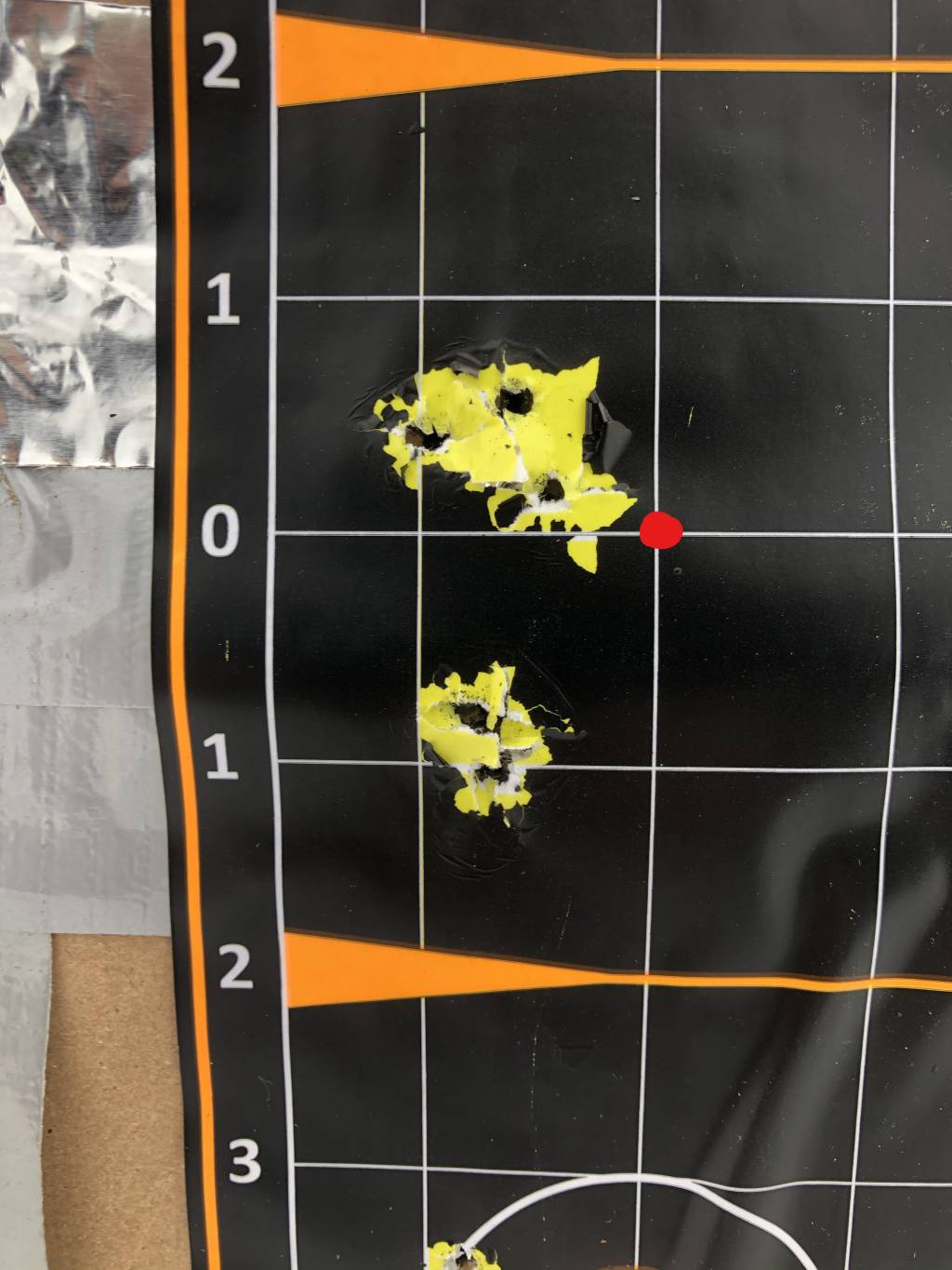

 These two are the JSB 14.35s in 10 shot groups each. In each picture, the holes at the top and bottom are from trying to shoot slugs. Also, each square is a 1"X1" for reference.

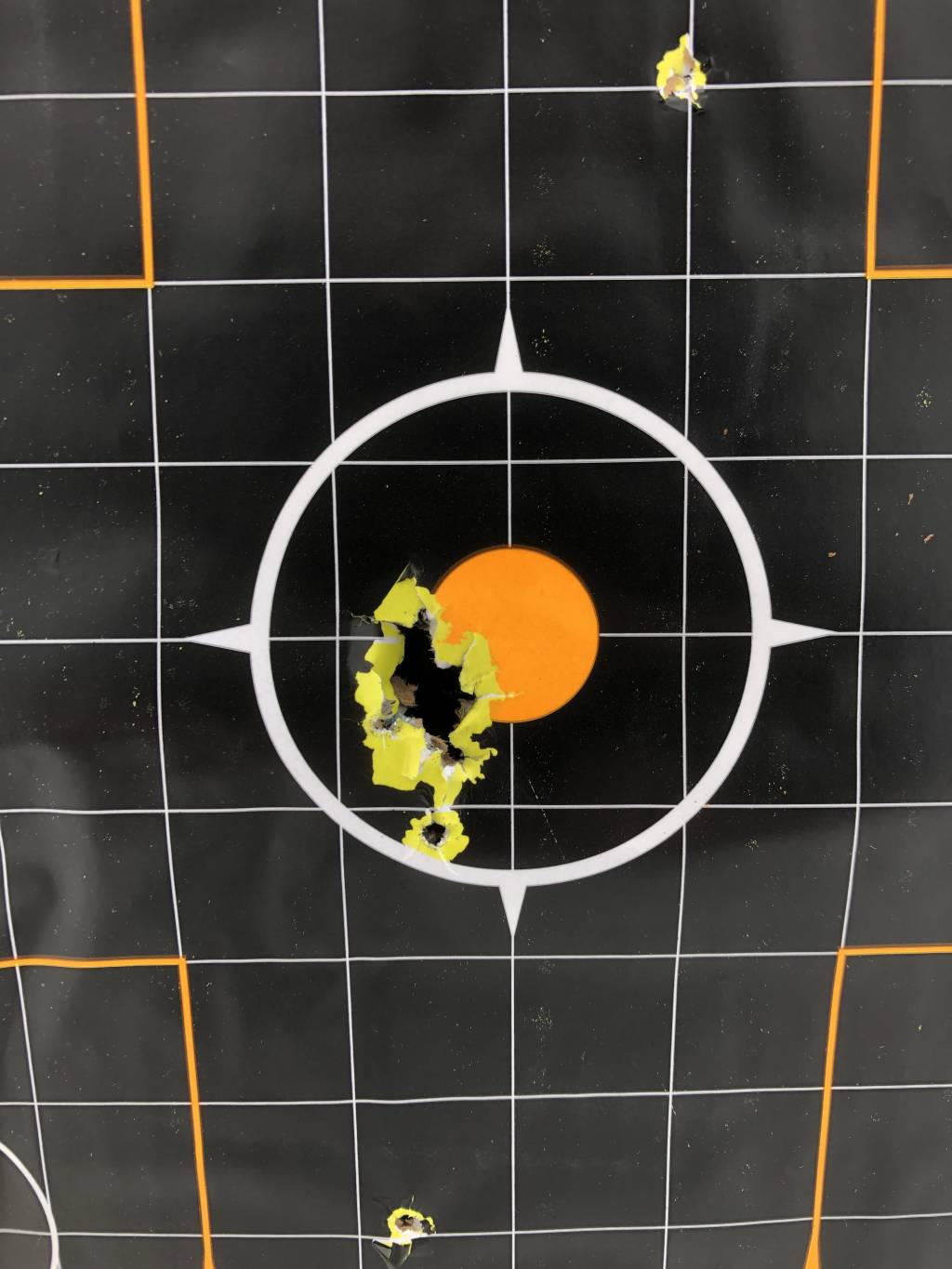

 These are the JSB 18.13s in a 5 shot group on the orange target in the bottom corner and a 6 shot group where the red dot was my aim point. Now it may be the cold, but it seemed with the heavier pellets, when I took less time in between shots that I get some "fliers" that would hit lower. Maybe I'm doing something wrong or maybe something is wrong with the gun, idk I'm still new to PCPs.

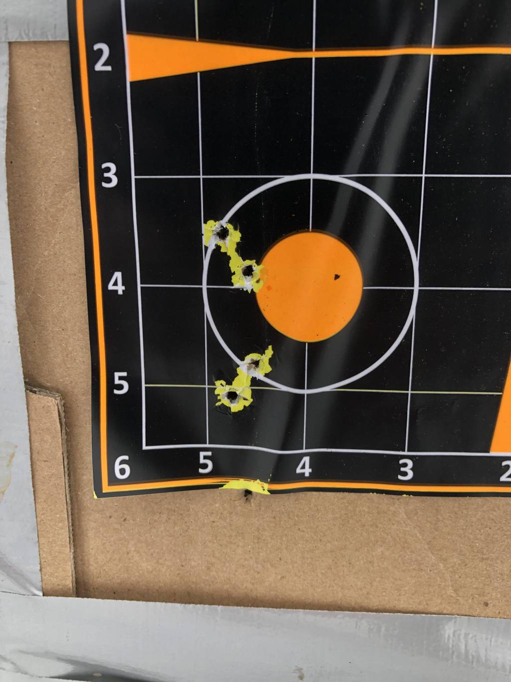

 This is a 5 shot group with the JSB Hades. eh. again with the circumstances, I'm not going to place any blame on the gun today. These are all things that could tighten up my groupings. I also shot the H&N Barracudas and they had a slightly tighter grouping than the Hades but not by much.
