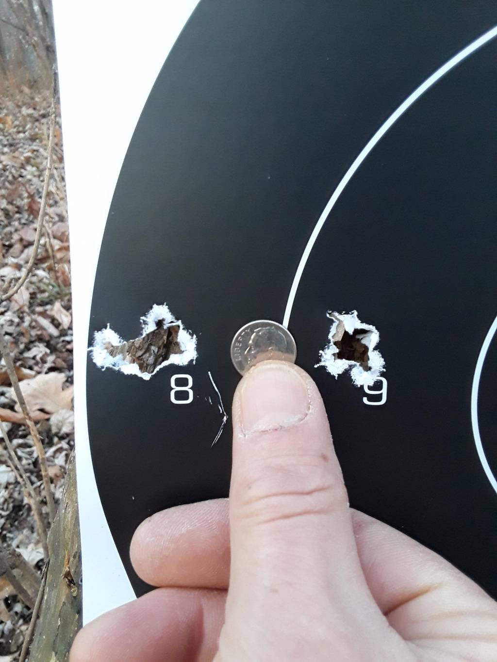

This is what mine is doing after a barrel polish with 18.1s at 40 yards!!! 840 fps. In the cold!

Forgot to mention those are 10 shot full mag groups...the one to the left was fresh cleaned barrel with the first couple going left and then settled right in!!!
