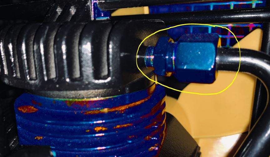

ferrous metal in blue, and tested all points pictured on my LC-110. Guess this explains the localized rust.

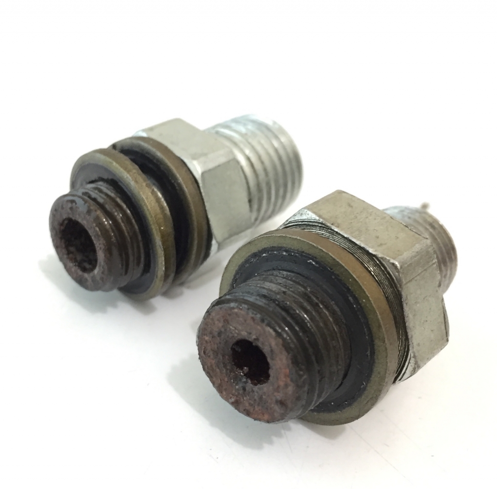

Thanks for taking time to check this out and reporting the findings. I think a bit of external rust is no big deal. Just rub some oil over the rusted area and it will probably cease to rust further. My concern is internal rust which will just keep worsening until some failure occurs. As mtnGhost has seen rusty water being spit out of the compressor, there may be rusting inside the machine. My cheap Yong Heng has got a number of compression fitting connectors / adaptors of this kind at various locations :
Some of the connectors are made of stainless steel and some are made of ordinary steel that can rust. The two connectors attached to the moisture trap of the first stage are made of steel and rusted inside. Can similar things be happening inside the Daystate ?
My Yong Heng is one year old so I believe it will take several years before the rusting will cause real problems. So far it just makes me feel uncomfortable. I have tried to look for stainless steel replacements but no joy so far. My temporary fix is to sand off the rust and coat the surface with Boeshield T9 hoping that it will last longer. If it doesn't work, it means I will have to replace these connectors regularly although that's no big deal because the original Yong Heng parts are very cheap and always available.

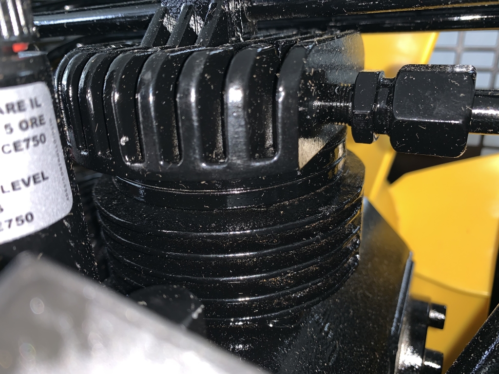

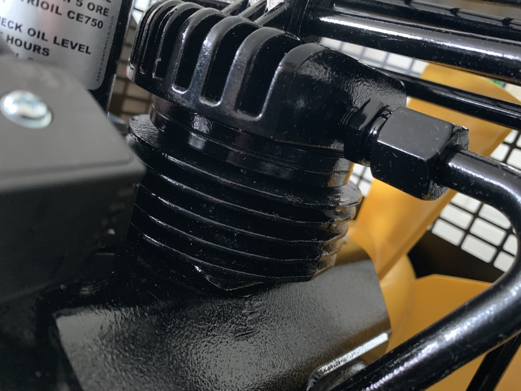

Good illustration! Is yours coated better?
If I look closely I can see some of the same underspray issues that you had on various parts *but* the ferrous stage 2 cylinder and the heat sink fins appear to be better coated than yours. That said, I do have a spot that looks like painted rust that may have been rust prior to painting or a blemish after the casting process. If I poke at it the paint doesn't flake off so there's a good bond there. I wonder if these things have a cylinder sleeve?
