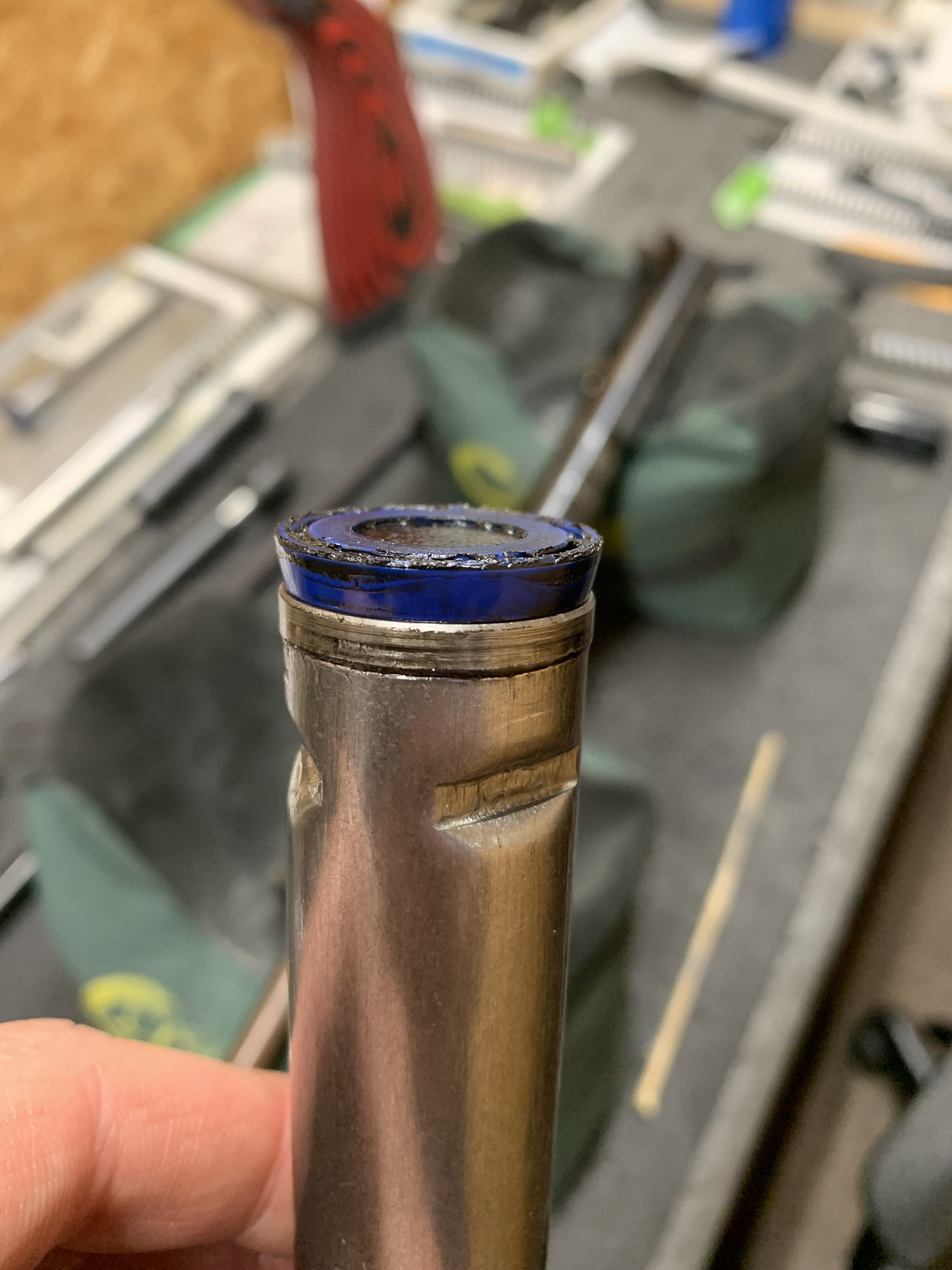

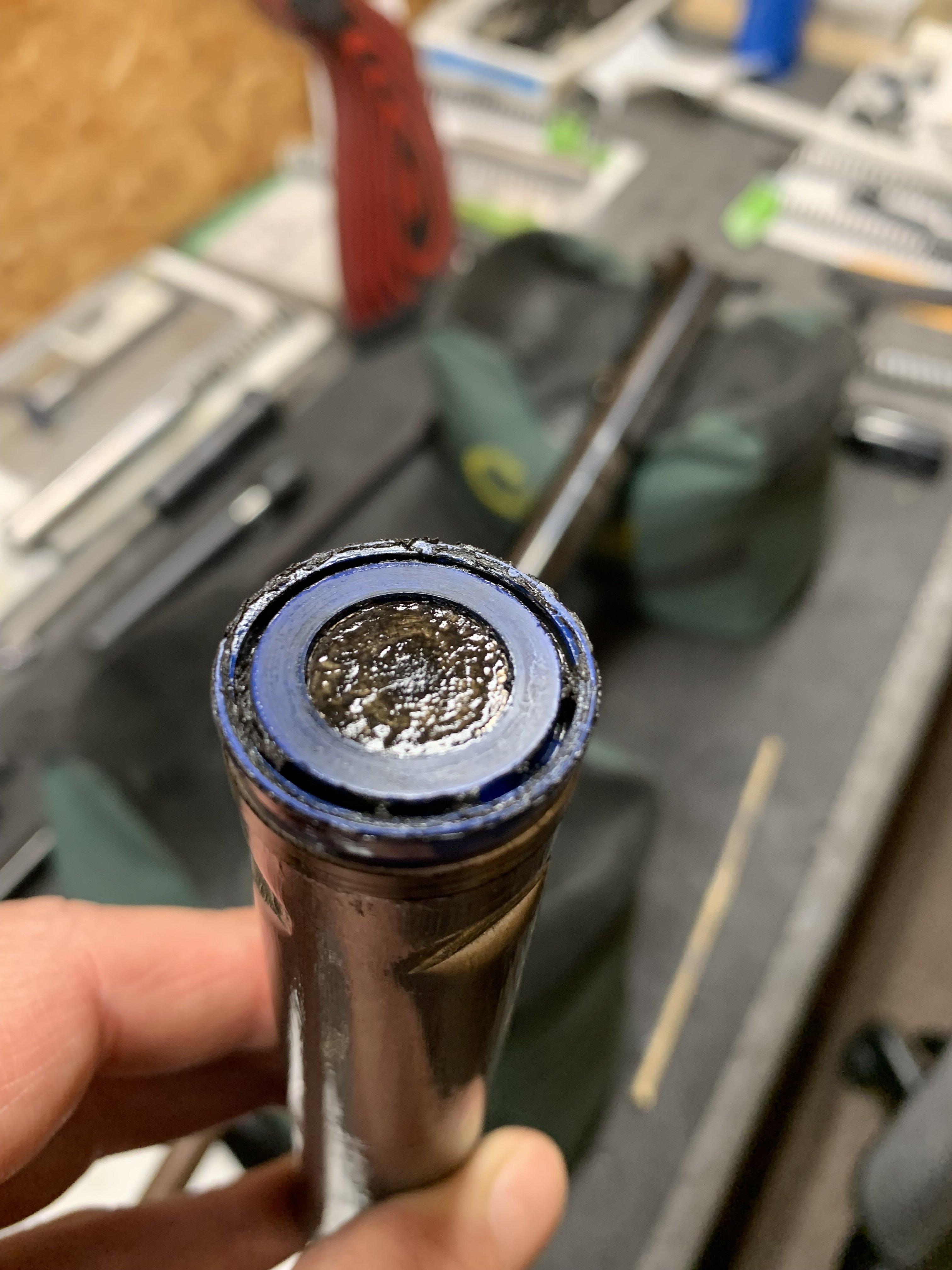

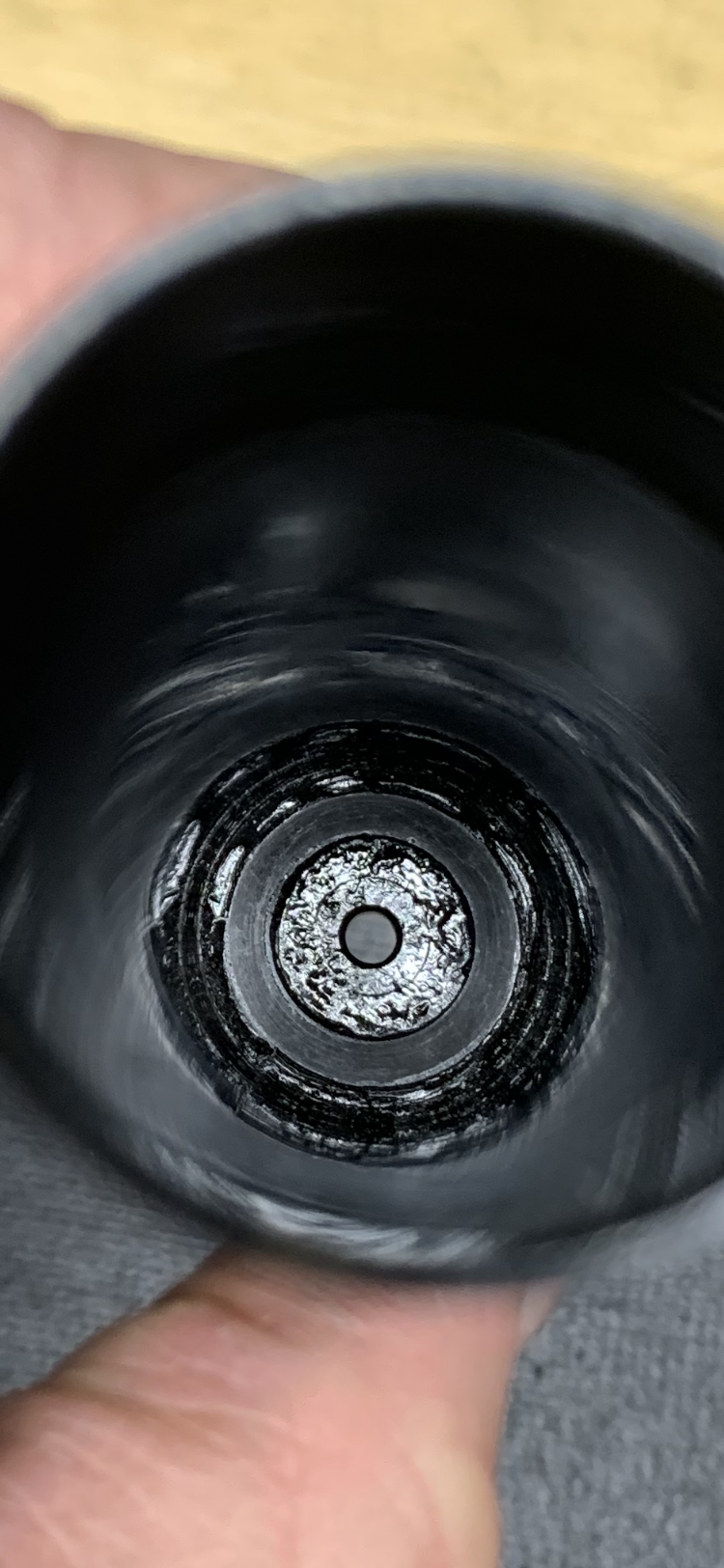

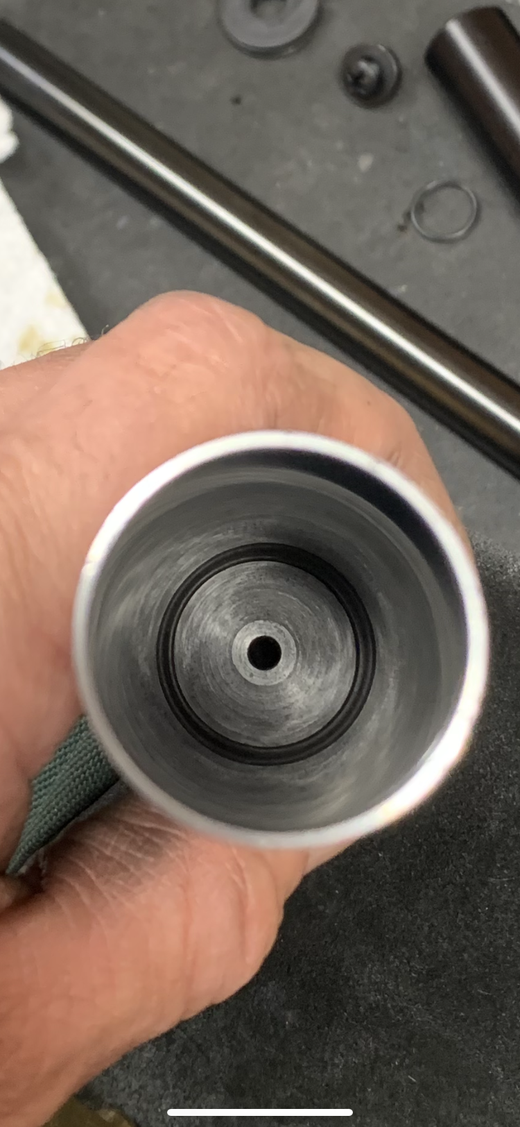

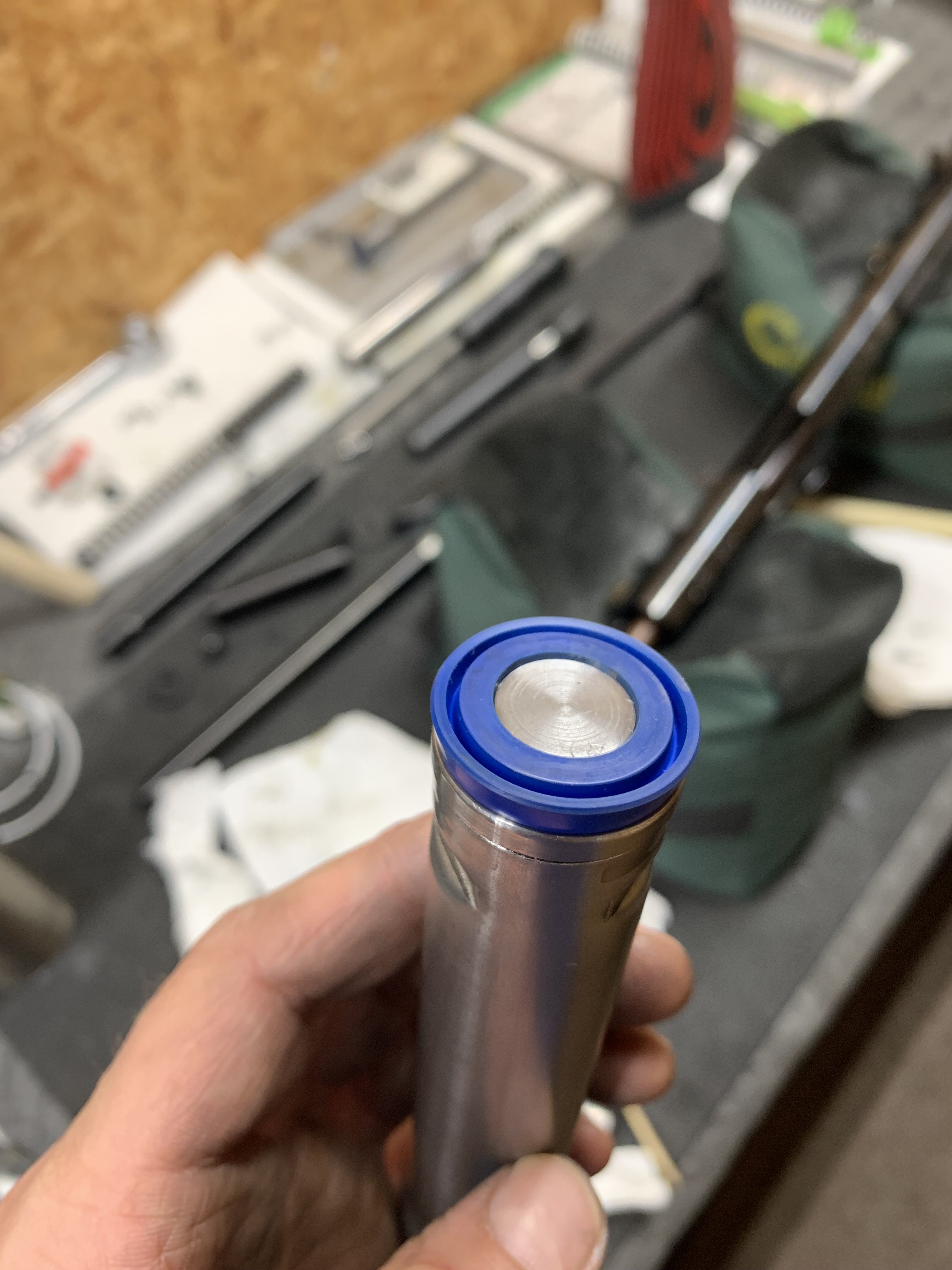

It was detonating and despite trying to shoot through it, it was in no way taming down. A quick disassembly revealed the source of the problem, EXCESSIVE Lube!! In the pictures below, you can see the amount of lube that was applied at the factory. I also attached pictures showing the piston and comp tube after it was cleaned up
Before
After
Before
After
