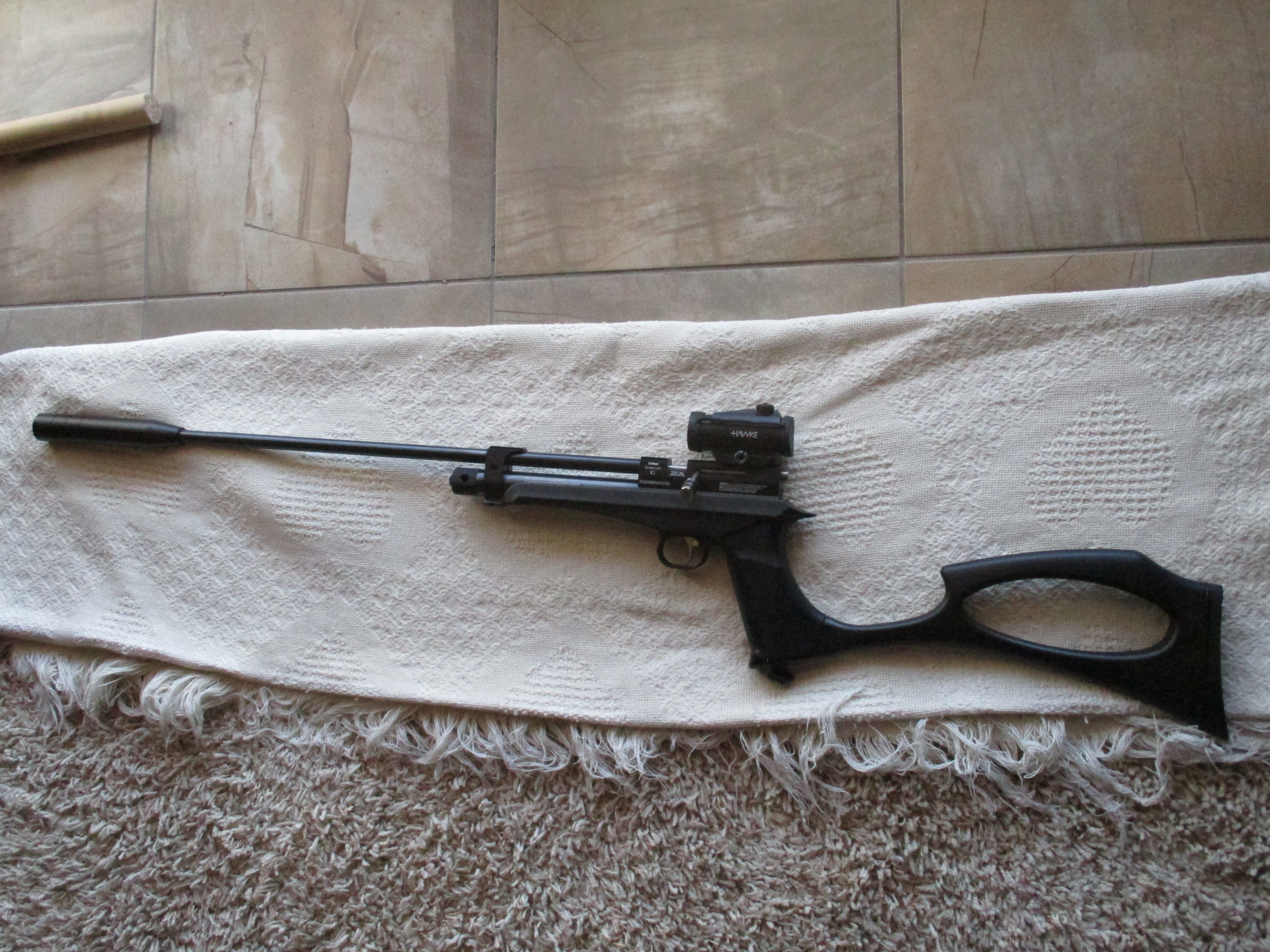

Just got my Diana Chaser Kit from Midway - $129.99.
First things first:
1. Made sure everything was included in the kit. Gun seems very well built for an inexpensive gun.
2. Cleaned both pistol and rifle barrels. Each took about 10 patches with Balistol.
3. Assembled the gun in rifle form following vids on youtube. I don't think I'll ever use it in pistol form.
Second things second:
4. Loaded a co2 cartridge and went outside. 55F outside, so no chrony data at this time.
5. Quietest pellet gun I ever shot. Trigger is fine - light with clean break. I like the single shot tray. Also bought 2 mags from PA.
6. The rear sight on the rifle barrel is plastic and flimsy. Windage adjustment is barely functional. The front blade is tilted about 10 degrees to the left. Annoying. Too bad because I like open sights.
7. Removed rear sight by tapping it forward with a block of wood.
8. Removed moderator and front blade by putting them in boiling water for 5 min. Came right off. Lots of red locktite on threads. Screwed moderator back on.
9. Installed Hawke red dot scope. Rifle easily drills tin can at 60 feet. Will sight in seriously when warm weather shows up.
Next step:
10. Work on increasing power to 650 fps.
Aside from the cheap plastic sights, this thing is impressive! So much fun to shoot.
Can't wait for warm weather and increased power.

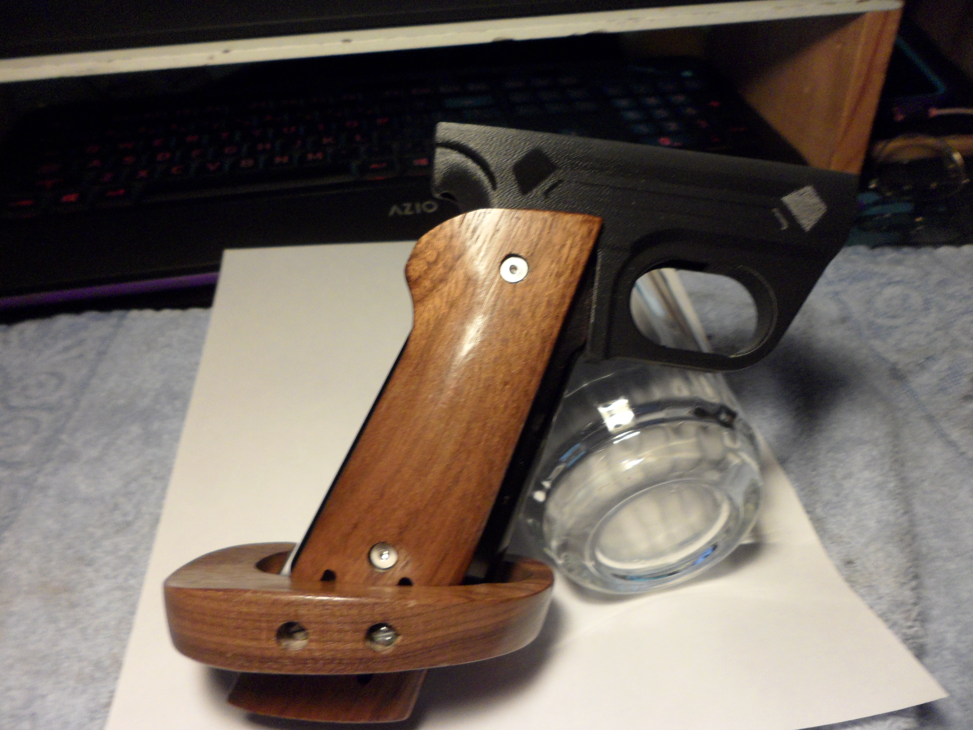

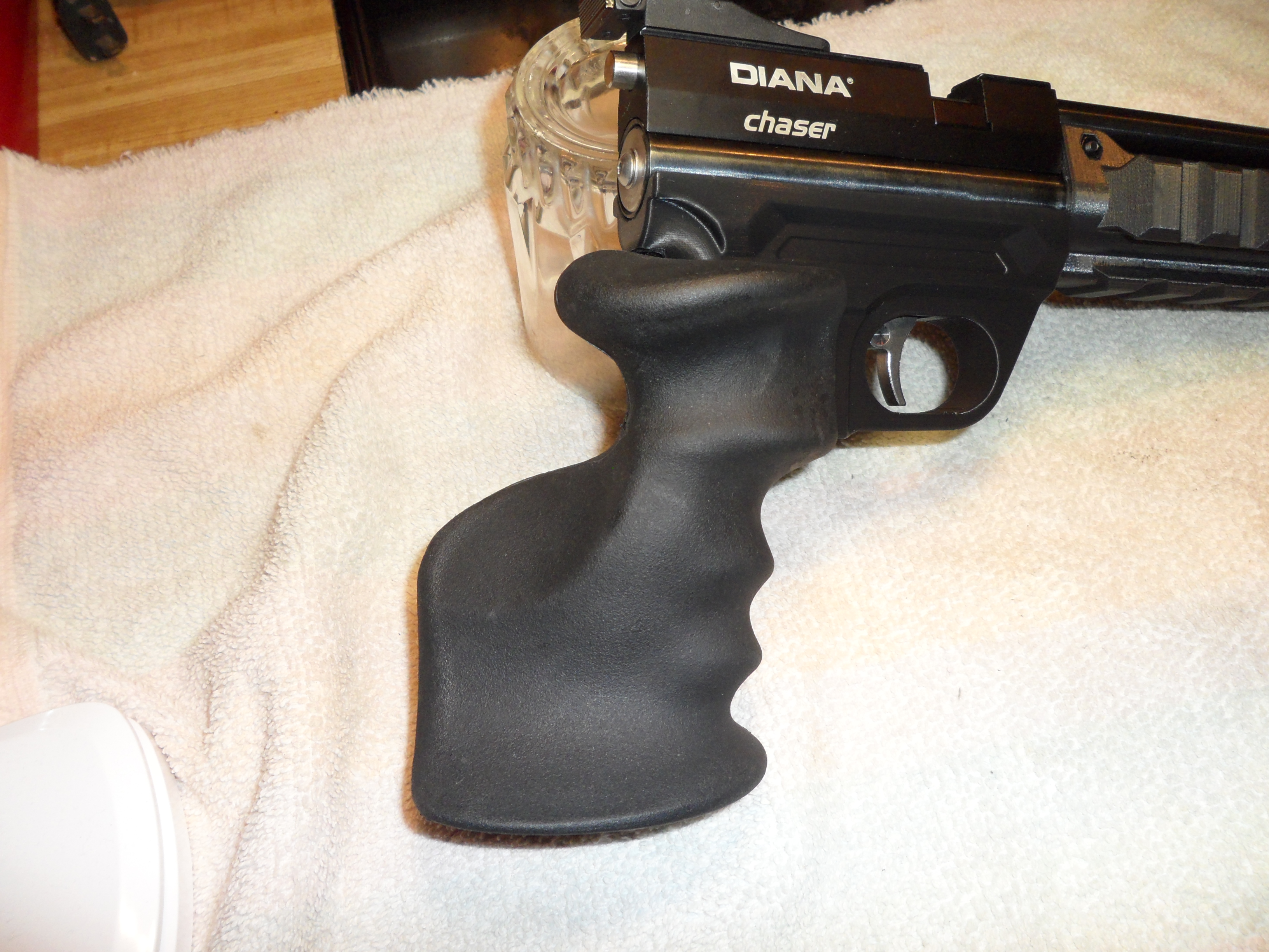

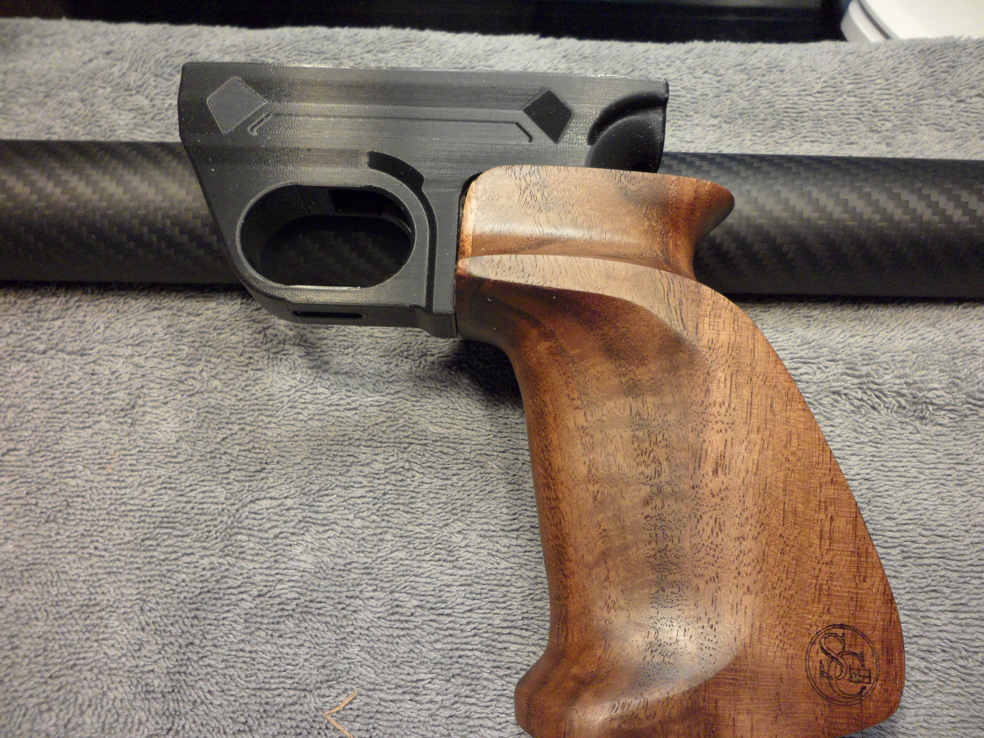

Buck Rail has a grip frame so a thought what would it look like with different grips i had many here so i bought several grip frame and did a fashion show
even took a Phantom 1911 adapter for the AR 16 grip mount
all the grips needed their own length screws
the one Steve Corcoran FX grip needed the Buck Rail frame to be thinned so just scaped it down
this one has a
ARG AR15 TACTICAL / TARGET GRIP​
the next one has a Herrett 1911 grip on it
my thinking is the Chase, Airbug and or Bandit could be use as the base for custom pistols as the 2240 has been for so many year
the one with the aluminum grip is very little

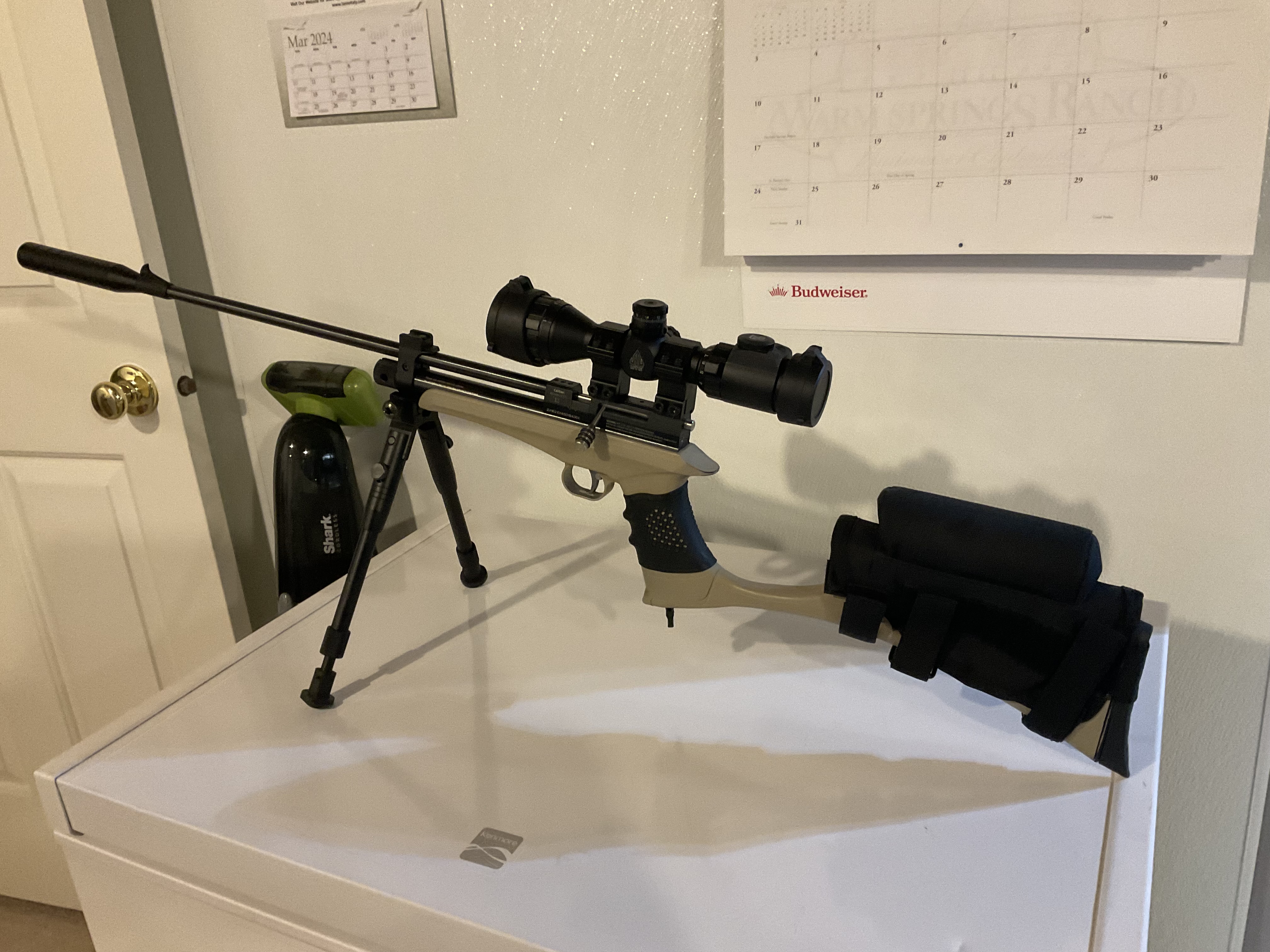

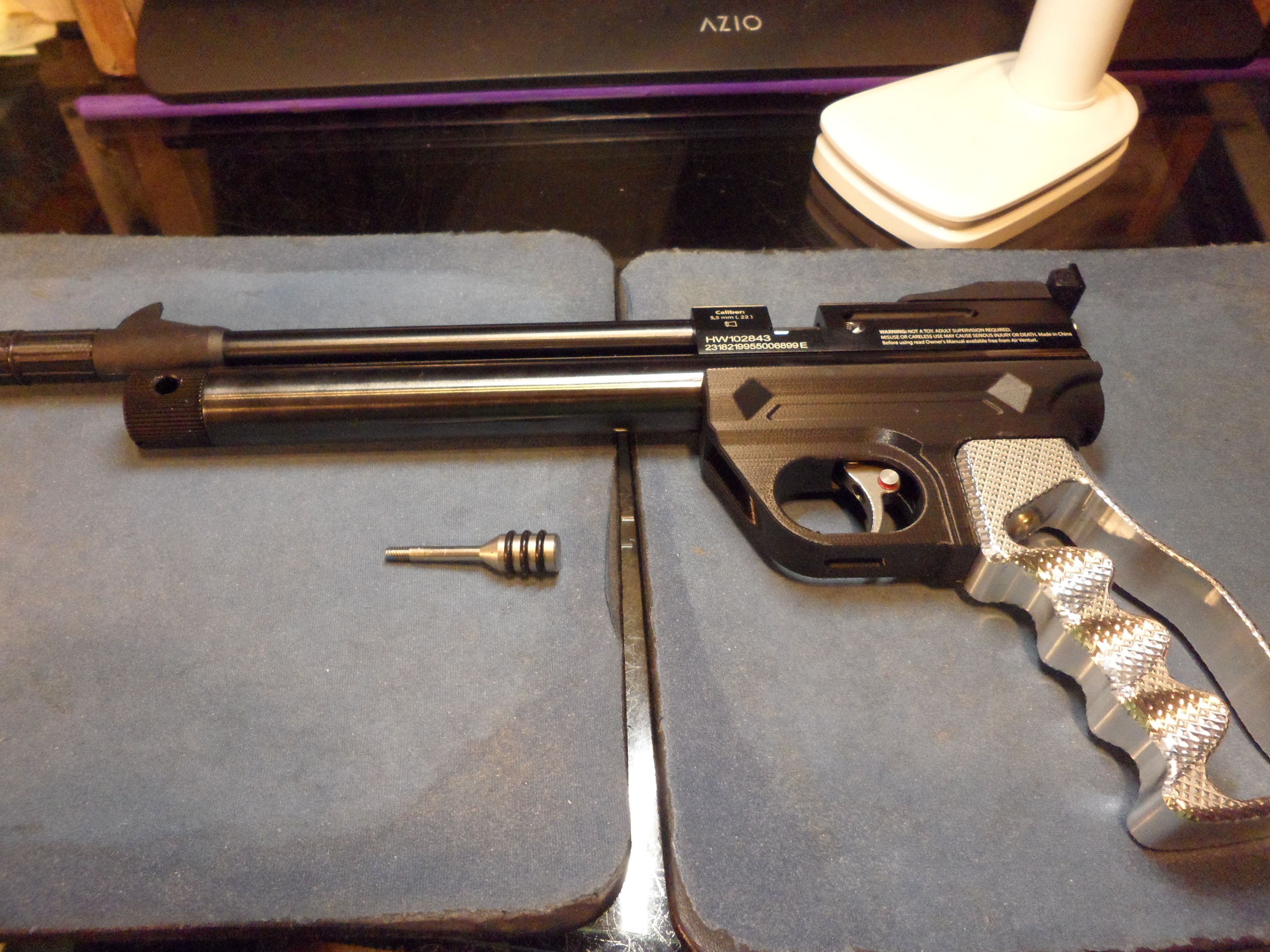

Marflow, I am curious where you obtained the barrel, barrel band and front sight mount for the pistol in the top photo? Globe/peep combos really work for me but I can’t find a front attachment dovetail anywhere.

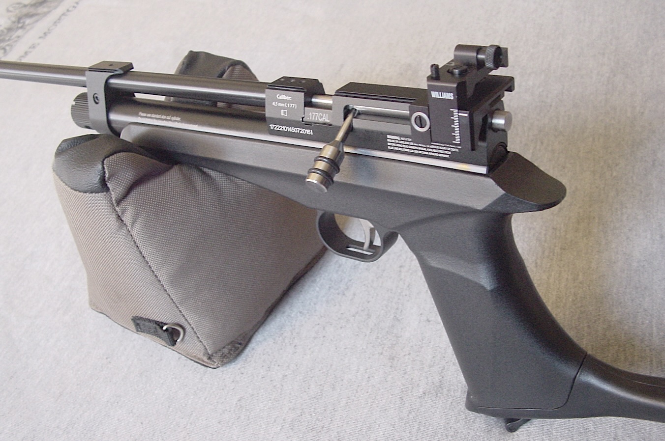

I have two Chaser kits in .177. Accurate, lightweight, and very quiet. Great guns. I set one up with a Williams peep sight. Works well.

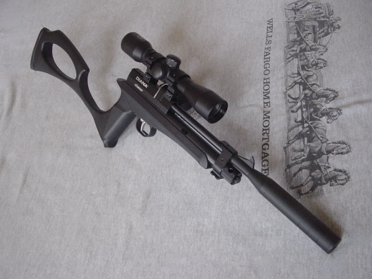

Chaser #2 with the pistol barrel, moderator, rotary mag, and compact 4x RWS scope. A great short range small pest control gun.
North woods, please share where you found the barrel bands. Nice and minimalist.
