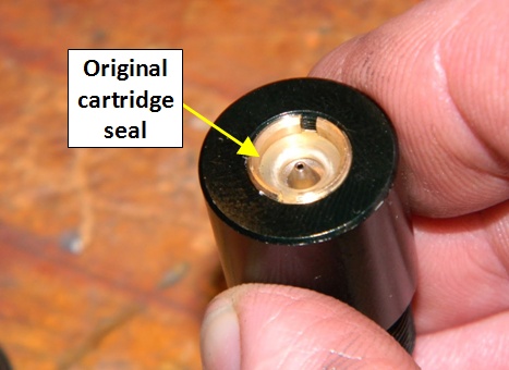

The last step before firing was to charge the gun with CO2. I unscrewed the cap to the cartridge chamber and removed the builtin "wrench" pin from the cap. I oiled a cartridge and inserted it. I replaced the cap and screwed it in until it uncountered the cartridge. I inserted the pin and used it to complete securing the cap.
I have loaded a lot of these cartridges. Some seat quietly and others make a soft hiss as they are punctured. When I twisted this cap there was a loud hiss that would not stop. I tried turning some more (which involved starting a new turn with the pin) but the hiss just got louder. The barrel, the cart and my hand froze.
I removed the now empty cart and inspected the gun's CO2 port through the top of the chamber. Everything looked OK. Then I discovered an inspection port in the side of the CO2 chamber. This allowed me to confirm closeup that there was a good O-ring surrounding the cartridge piercer.
I tried loading another cart, this time using a screwdriver to turn the slotted cap. This time it went flawlessly.
