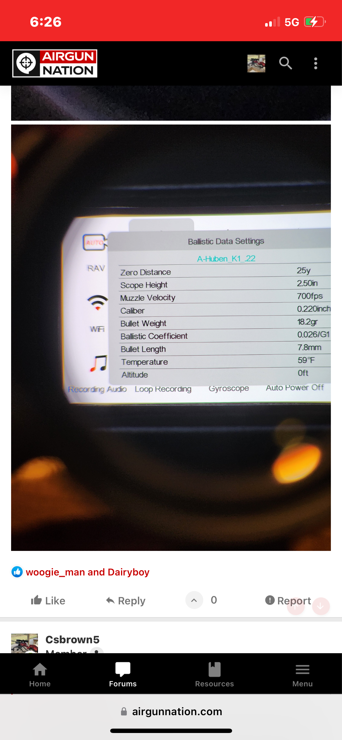

Ok I'm about ready to chuck mine against a tree!!! Trying to get the ballistics program to function. I have everything in the app and have transfered it to the optic. Go into menus and select the correct profile from the list, and see the profile in the upper right corner. Turn on the range finder and get a range, click the button again and get an error of "Balistic Algorithim not activated ".
I go into the Ballistic Options and select the profile again, look through and verify everything is correct......and same thing.
What am I missing guys?!?!?!
Before anyone chucks any against trees always feel free to reach out. I will chat here give you my number etc. First I would like you to delete your DNT app, after that pair your scope to the app via wifi again, tap device to mirror your screen just to confirm it was successfully connected. After that check in scope see if your ballistics are still correct, confirm Ballistic Calculation is selected and try ranging again. IF that didn't work please reach out to me and I will try and sort it put for you. Sorry for the inconvenience
Reactions: woogie_man
Oh I won't chuck it against a tree....just frustrated more than anything. Will delete app and try again
Sending a message. Deleted the DNT app and reloaded everything. Synced back to the scope and still nothing. I am sure it is something I am doing to be honest.
And working!! BRAWLER is the man!
What happened.....if things don't work delete app and start over. Things are working now.
