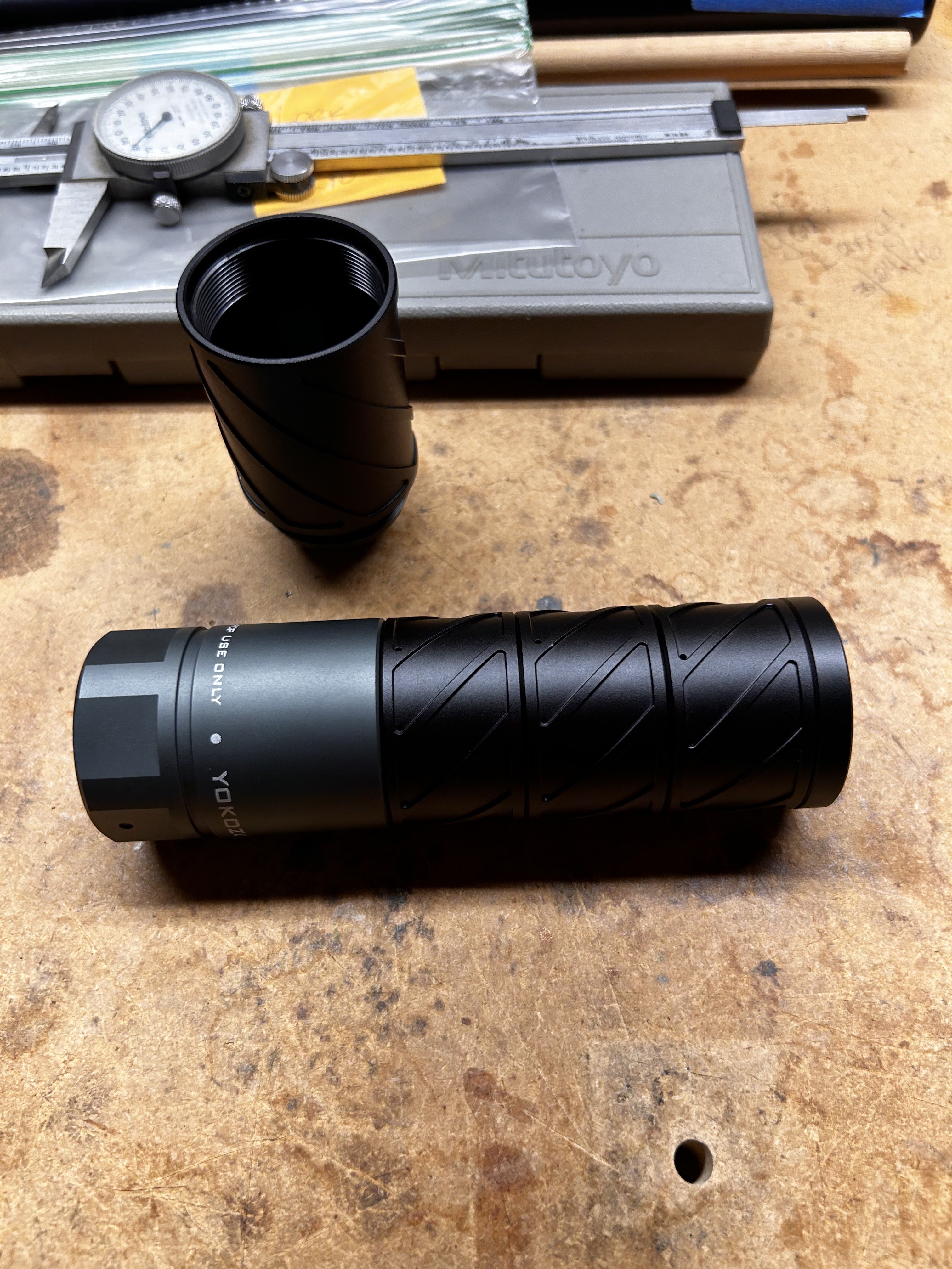

Got this today and excited for tomorrow to see how it compares to my other moderators.177/.22
I got to play with the ryu and Yokozuna. I was impressed with the build quality. I didn’t get to shoot through either of them. I don’t know if I like the quick attach(again I just looked them over). I’m really excited for a review, I have another brand that you can add sections too and it will not pass a roll test( causing clipping)

I just got an FX Hunter Compact in 25 with the Yokozuna. For that gun in its case, the quick release is perfect. The moderator is very quiet but mine has a high pitched ping to it. Currently shooting H&N Baracuda Hunter Extreme 28.24gr at 828fps. Hitting the target is definitely louder than the shot.
Are you talking about the Yokozuna having a ping? If so, try removing the large empty section and just use the 3 smaller ones.
The large section is machined differently than the smaller sections and the base section. the small sections and the base section have o-rings that engage the threads as you begin to tighten the section. The large section is not threaded all the way to the end and thus there is no o-ring contact..just metal to metal.
I took the large empty section off and tested without it on. The "ping" went away. The sound seemed a touch louder (ears only with tinnitus) so I put the large empty section back on; tightened the smaller sections on; and reshot. The ping was no longer noticeable so I will chalk it up to not having the last section tight against the large empty section. I'll put a db meter on and see what the difference is as having it a bit shorter is desirable for hunting! It still won't fit in the case with the one section off, so that will have no impact.
