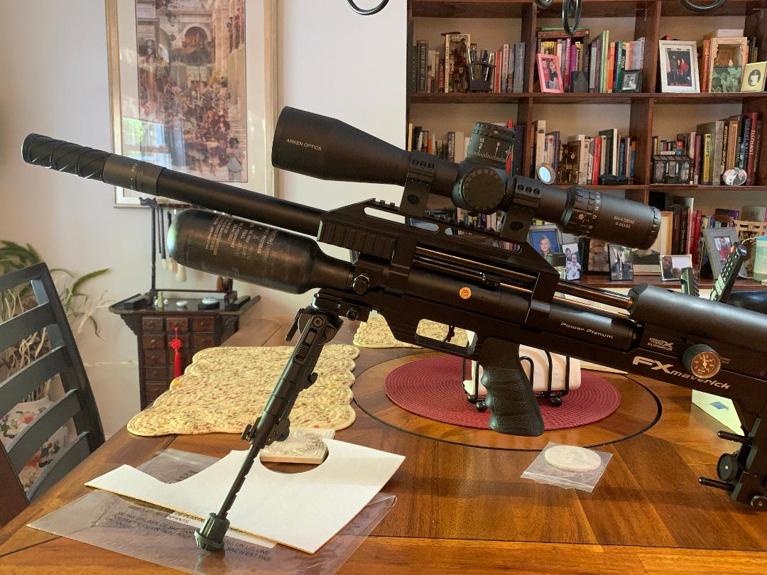

Got my Koyo in .22 yesterday , Its really solid when attached to the gun looks and works really well On my FX Maverick . The maverick Is not a loud gun anyway but the Koyo makes It almost silent POI Is very very consistent . However I tried It on my Hatsan factor Sniper which Is a loud gun , It did make a bit of a difference to the noise level but I wouldn't call It back yard friendly by any means so that was a bit disappointing . If you Intend to use this on multiple guns your going to need the adapter for each of your guns unless you intend to swap the adapter from gun to gun in which case It makes this type on moderator pointless . As of right now I haven't seen any adapters for sale .
