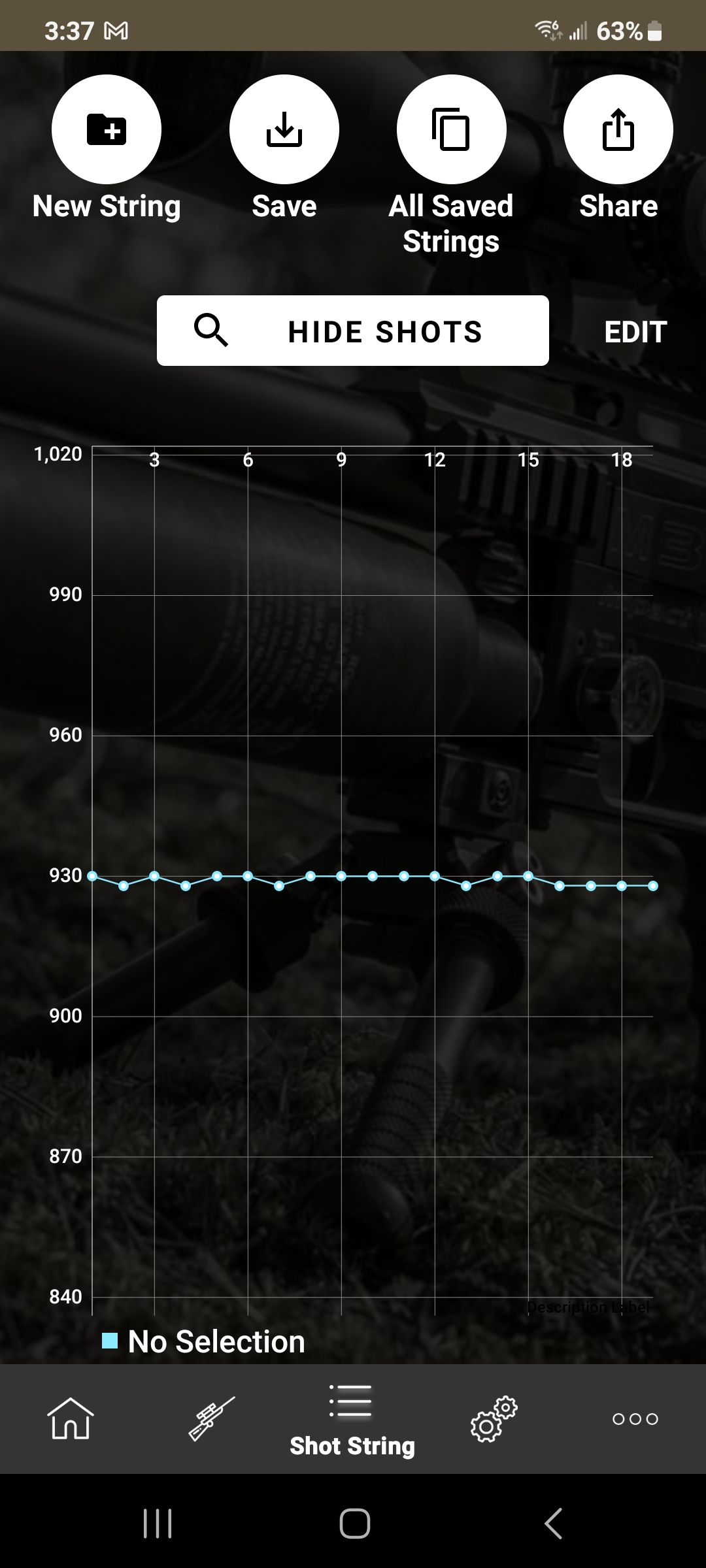

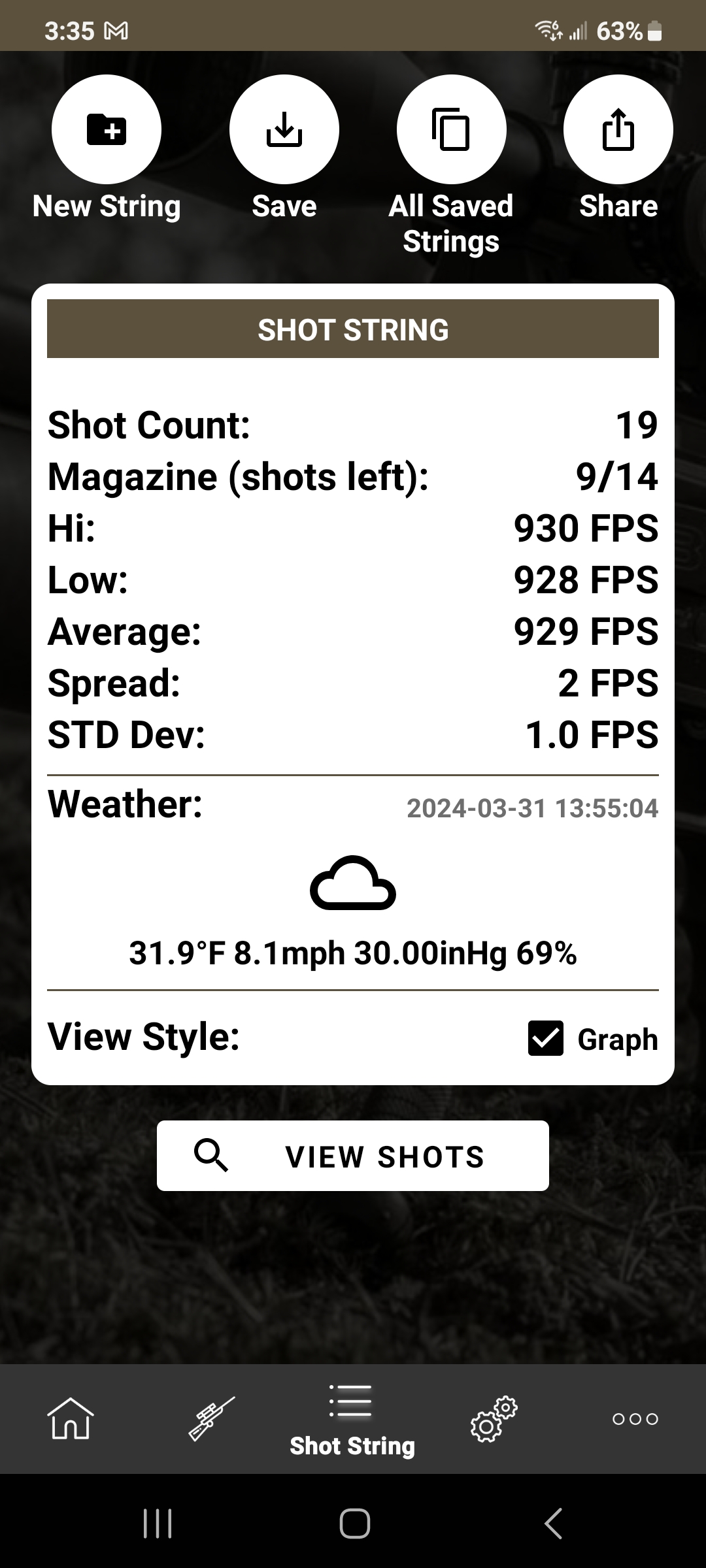

I did a shallow dive into my DRS 22 700 this morning.
I am shooting the H&N 34gr Heavy slugs.
I backed the hammer spring tension out just a bit over 1/3 turn. The best I can tell my reg is set at 135 bar ???

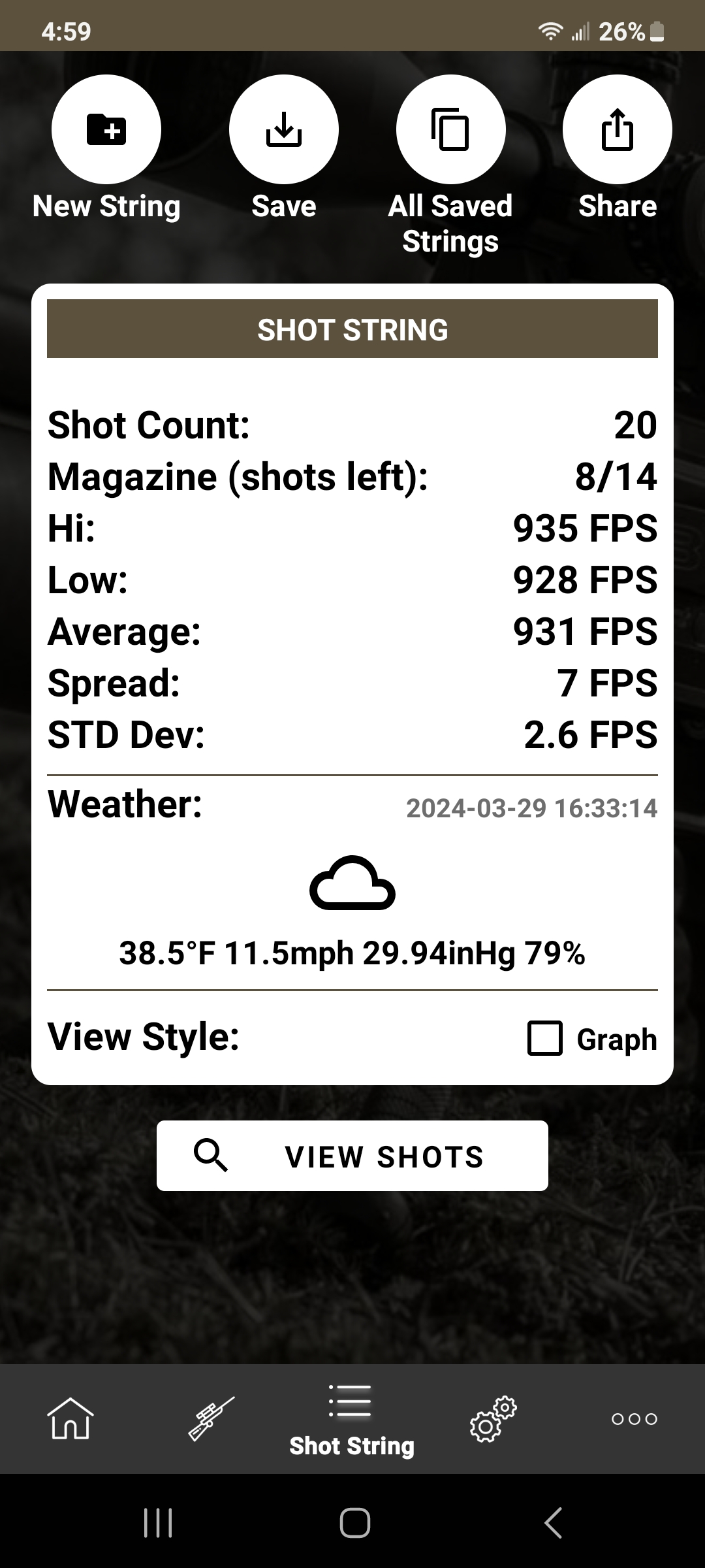

These are the 1st shots from my DRS.
I'm getting about 20 shots, 230 to 150 bar, it's cold here yet.
That's pretty damn impressive string! ES of 7 and SD of 2.6 and another string with ES of 2 and SD of 1???? That's really nuts especially for 1000 bucks!!! Let's see if any of those "game changers" can match that. :ROFLMAO:
