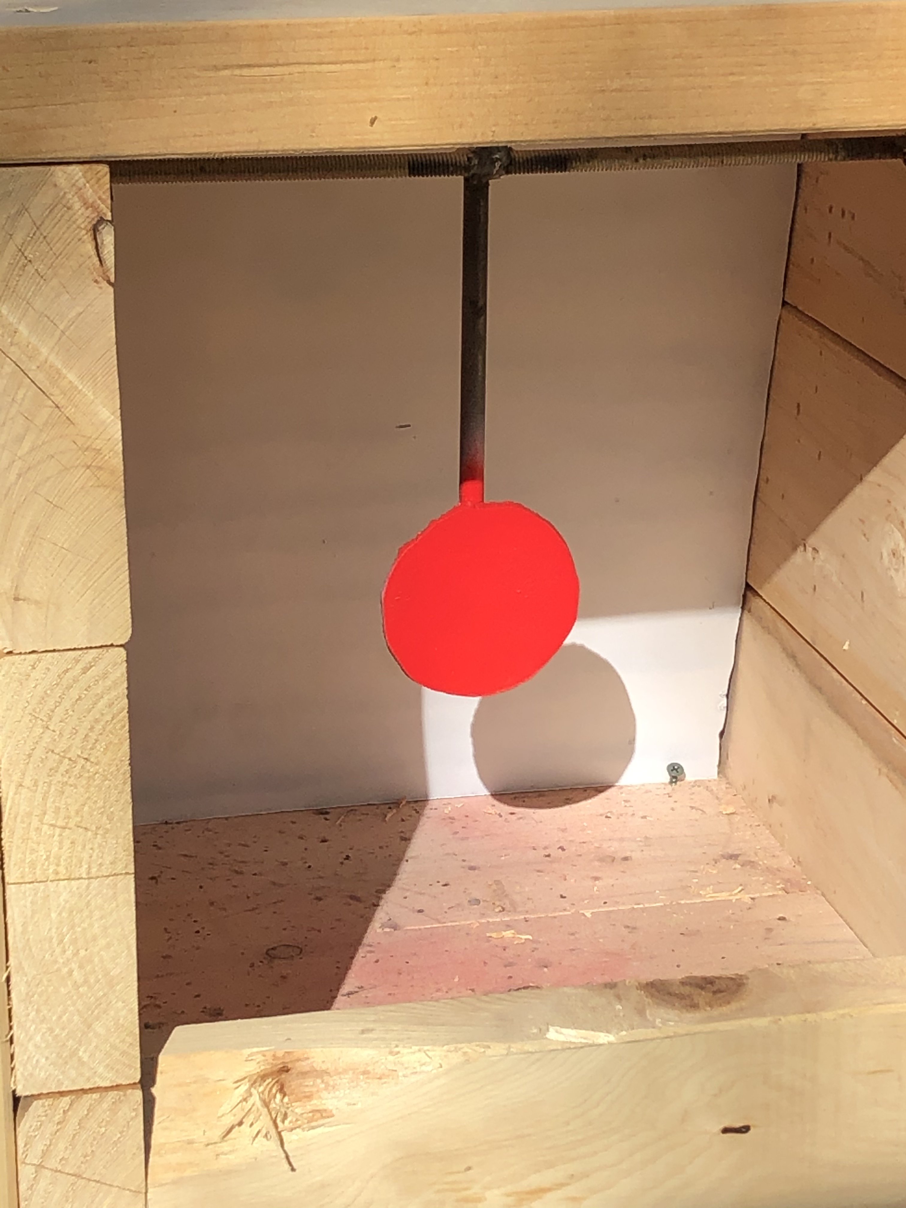

A spinner.
With a spinner the outside of the pellet, if barely contacting it, will move the spinner a tiny bit. This may or may not be noticed by a person spotting. I've been bit by this a few times where points were lost or in a speed event the wiggle of a hit was not acknowledged.
Or I hit the stem holding the spinner which shouldn't be called a hit.
But no strings needed which saves time and effort in a number of ways.
No question a well made spinner is more reliable than a more complicated mechanism.
Often it's easier to see where one misses in the dirt behind the spinner vs not seeing where one missed on a shot up FT target so a sighting correction can be made.

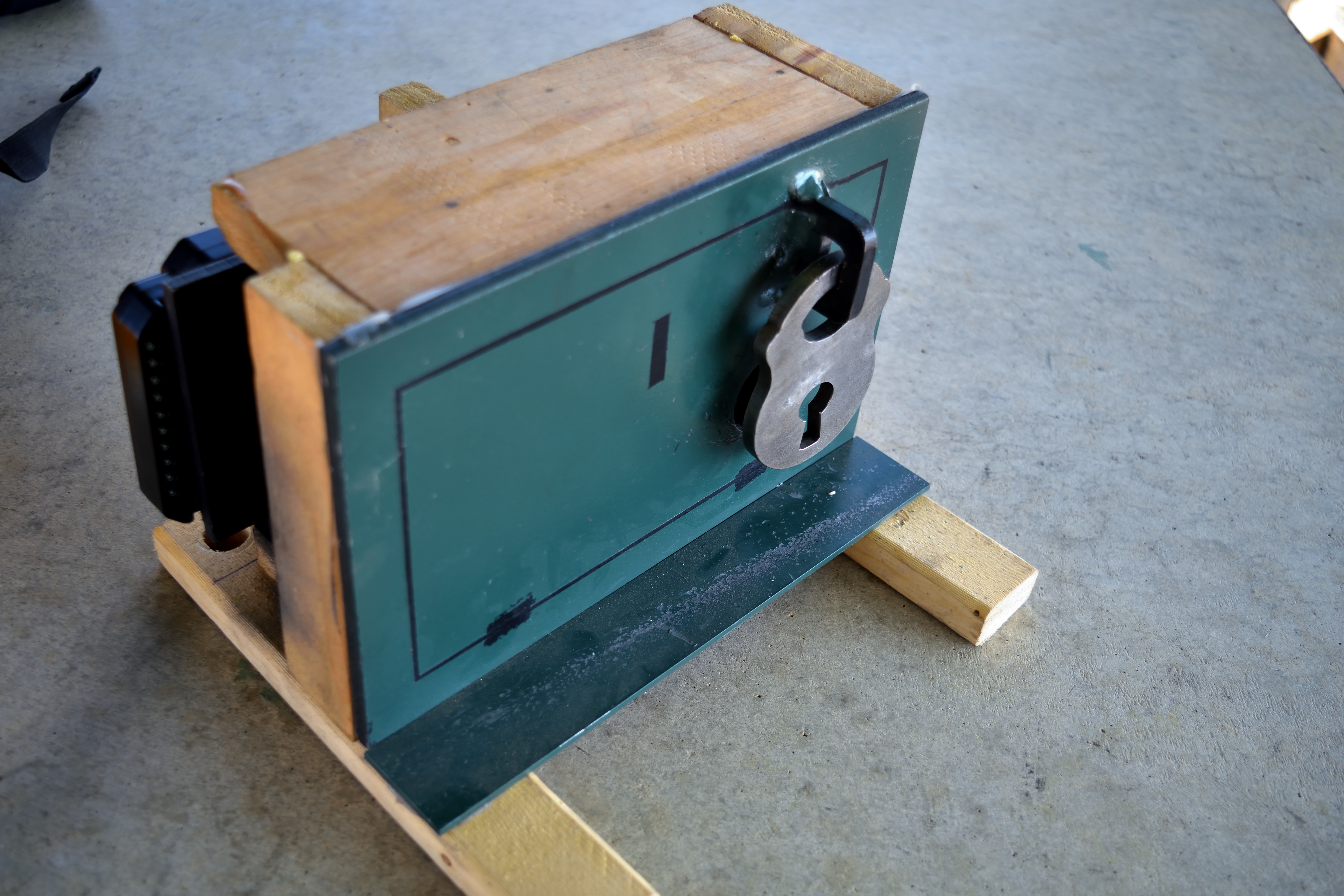

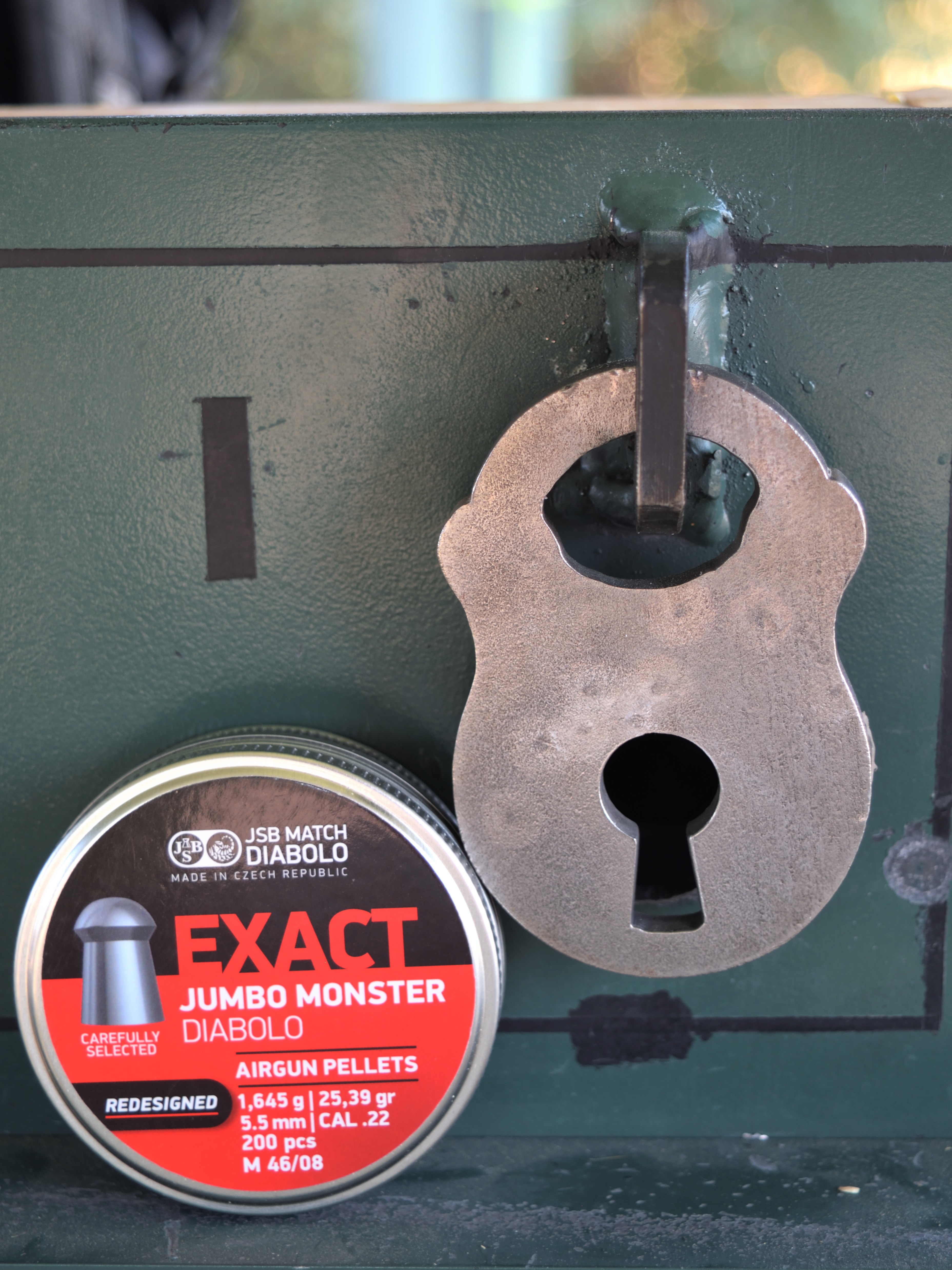

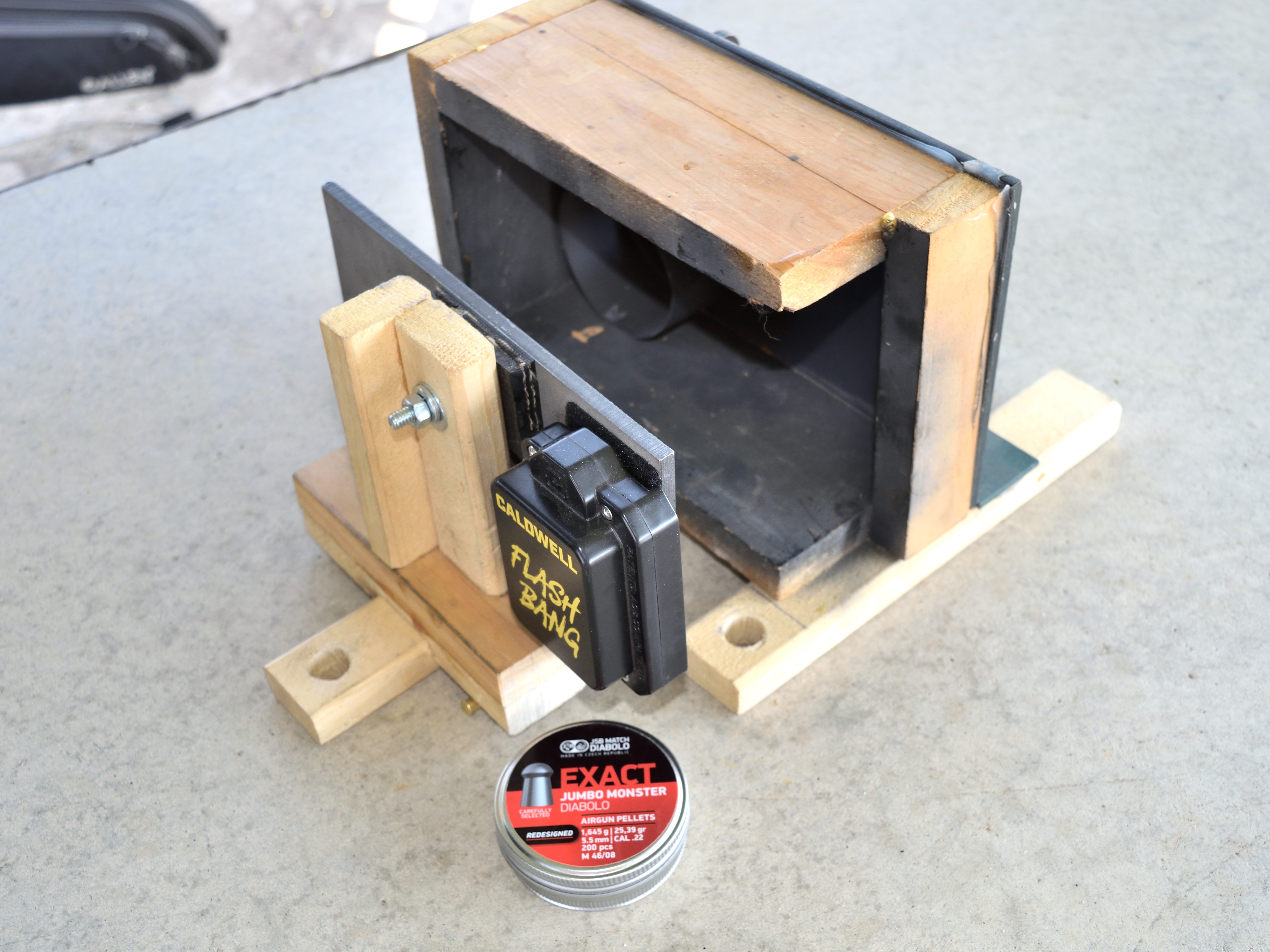

Reading over my post, it sounds like we used our flashing target in an EFT competition. We did not. We used the target in a side match that told the story of a 19th century train robbery. It called for two shots on the strongbox lock, and two more that had to go through the key hole to count for the score. Hits on the lock resulted in flashing lights. Also, we did have one split, which we felt did result in a flashing light. While we did stake down the two wooden frames separately, the wooden pieces were in contact with each other.
We did shoot this target with the rifles we used on the EFT course. They ranged from 40 to 70 foot pounds.
David Read did all our design and fabrication. He used mild steel for the face and the actuator plate. Dave feels that the fun factor was well worth building the target.
The strongbox still has secrets to unlock.
Please see the photos below.
Ron

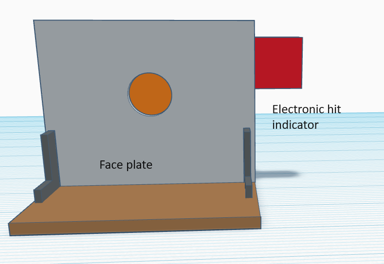

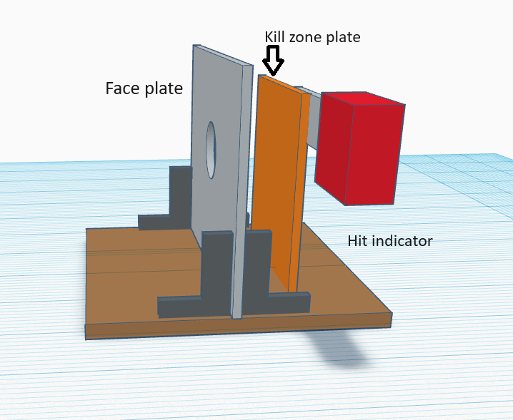

Reading a post from Leo about WFTF in the Olympics gave me an interesting idea. How can we make EFT targets more affordable, more functional and easier to setup? (I realize that's a question, not an idea. Unclinch yourself, the idea is coming.)
Here's the idea. Get rid of the moving parts and strings. Attach a metal plate to a 2x6, perpendicular. Attach an electronic hit indicator to the metal plate. Put a bracket a few inches in front of the metal plate. Slide a face plate into the bracket. Done.
So you would shoot through the kill zone in the face plate to hit the back plate, setting off the hit indicator.
I know what you are thinking: But those hit indicators are millions of dollars! Nope. The Hornady models are 10 buck each. Hell, they were giving them away in goodie bags at SHOT show!
So what problem does this new target solve? It gets rid of the expensive EFT targets that are tricky to set up to fall for 30 fpe to 100 fpe hits. It allows more versatility for face plates and kill zone shapes because the face plate doesn't have to reset and it doesn't matter where you hit the paddle to score a hit. You don't even have to cut out animal shapes for your face plates, just use a square metal plate and paint whatever animal you want. Since the back target is just a piece of metal attached to a 2x6, you can just leave them out in the lanes between shoots. Just pick up the face plates for painting and bring in the hit indicators for charging. You could fit a whole 30 target course in the back of a side by side, since it's just 30 face plates and a bucket of hit indicators. The only reason for a cold line is if a hit indicator went down, which doesn't happen very often based on the PRS matches I've attended. No more strings! And, depending on the steel used, rimfire friendly for you XFT folks.
So 3/16 AR400 steel plates are about $170 for a 2x2 plate. That would make 16 6"x6" target plates, so a little over $10 a target. Another $10 for the hit indicator. Call it $5 for the wood and hardware. So $25 per target plus the face plate. AOA sells a 5 pack of big game silhouettes for $90 that would make great face plates, just cut out the kill zone. SO you could go El Cheapo and be in this for about $60 a target. It's hard to find AAFTA targets for that cheap.
So that's my idea. I'm not even going to try to monetize this because it's so easy and obvious, what would be the point?
Here are some pictures (mostly for Ron). I drew this in Tinkercad and it assigns automatic names to new designs, so this system is now known as the Dazzling Trug. We can just call it the TRUG system for short. In 20 years people will wonder where the name came from, but no one will remember.
View attachment 486284View attachment 486285
If the hit indicator is mounted on the same base as the faceplate it will go off when the faceplate is hit. I mount the paddle on a metal rod and drive it into the ground behind the faceplate with the hit indicator 1 to 2 feet higher than the faceplate.
Hello @scotton
Isolating the “Face Plate” from the “Kill Zone Plate” would not be a problem and would eliminate any false hit.
I think you have a great idea not only for competition shooting but for individual / home shooting (y) (y) (y)

This would also make it easier to paint the targets. It's no fun if you are slotted at the end of the day and can't even see the hole you must hit. In Silouhette, each competitor gets a fresh target at his start. This makes it fair. I could not see my hit or zone, and the first shooter of the day could also see where he missed so he could correct the second shot. The other shooter is just wasting ammo.
