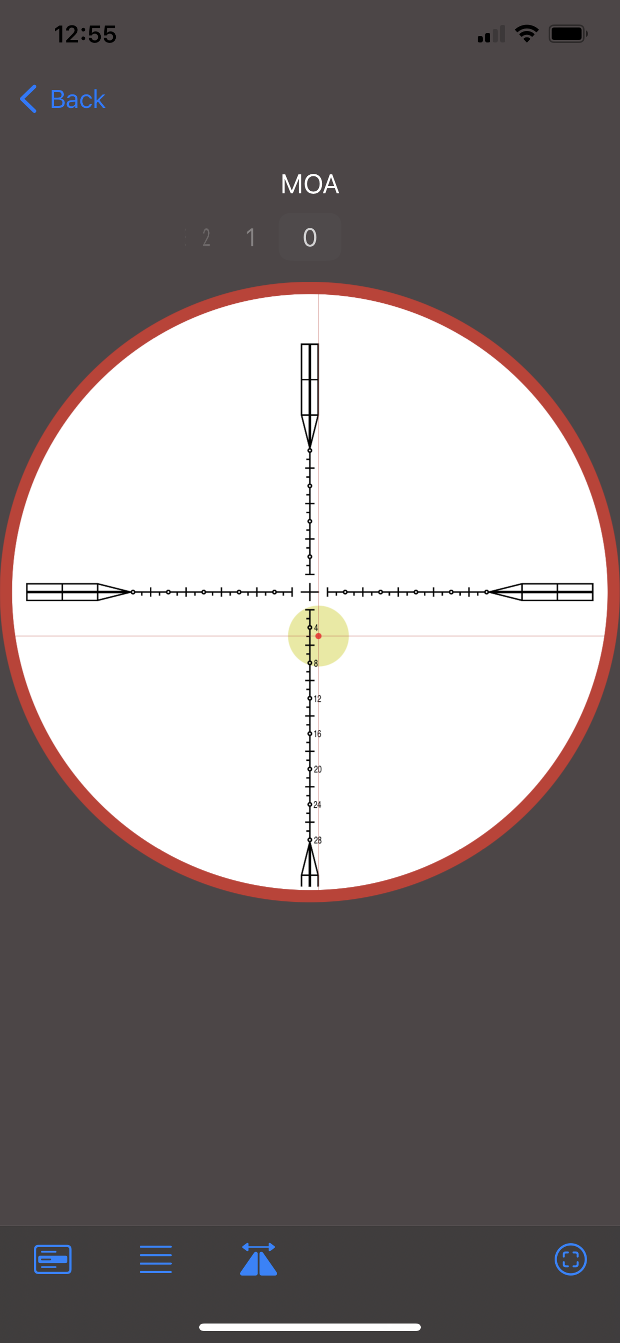

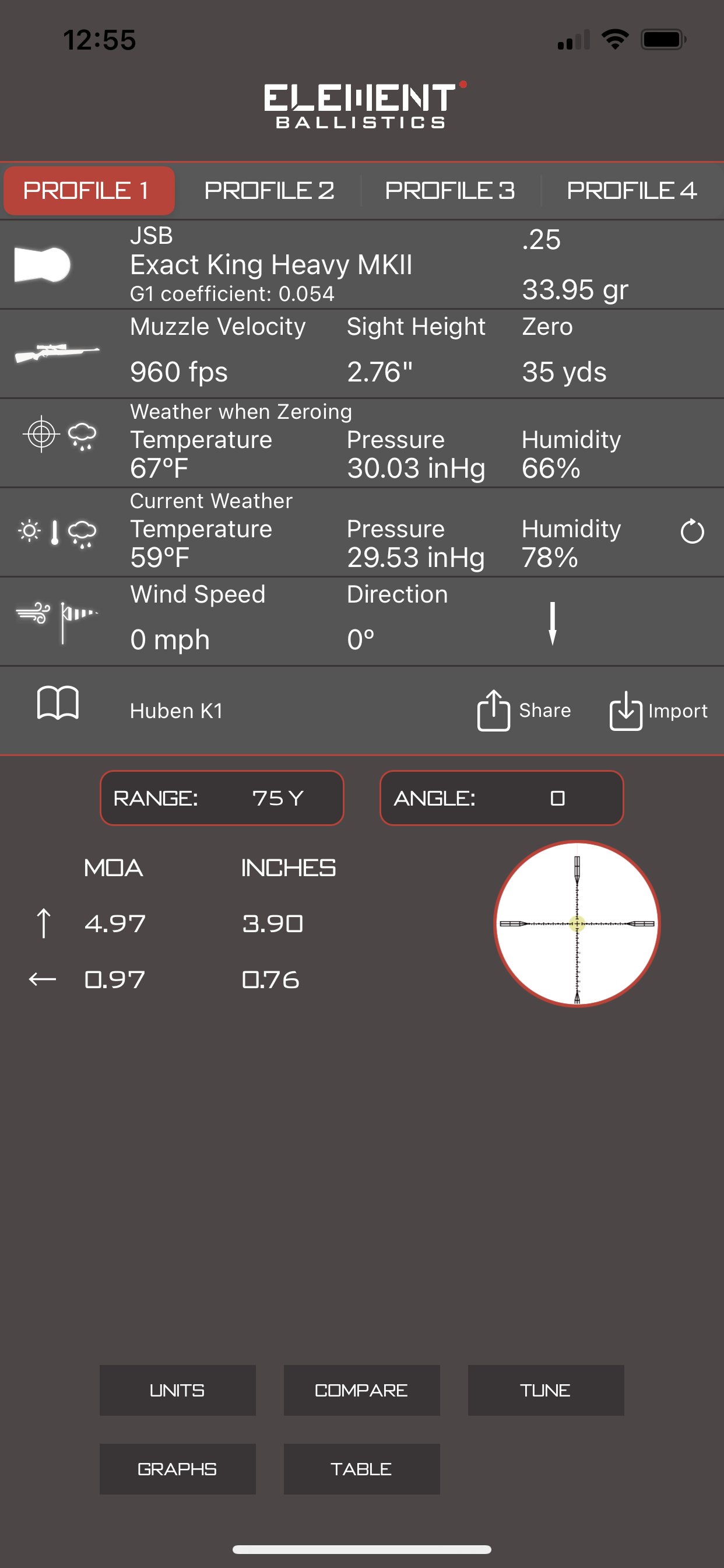

I went into the reticle list and set the retucle to match my scope, "MOA Single Focal Plain" then all those stats were correct.Alittle concerning with my info put in.......View attachment 383515
