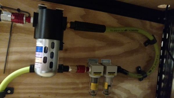

Have the F10. I run the shop compressor into a Wilkerson desiccant filter then through a water/oil separator and 10 micron filter before going into the F10. I guess it works...as i recently opened up my Mrod and Prod to install Hill valves...ran a lint free rag through the tube with no evidence of water or gook. I like the simplicity of the F10....i bought about a year+ before the price drop. The lower price should make it very appealing.
My F10 filter set up...
