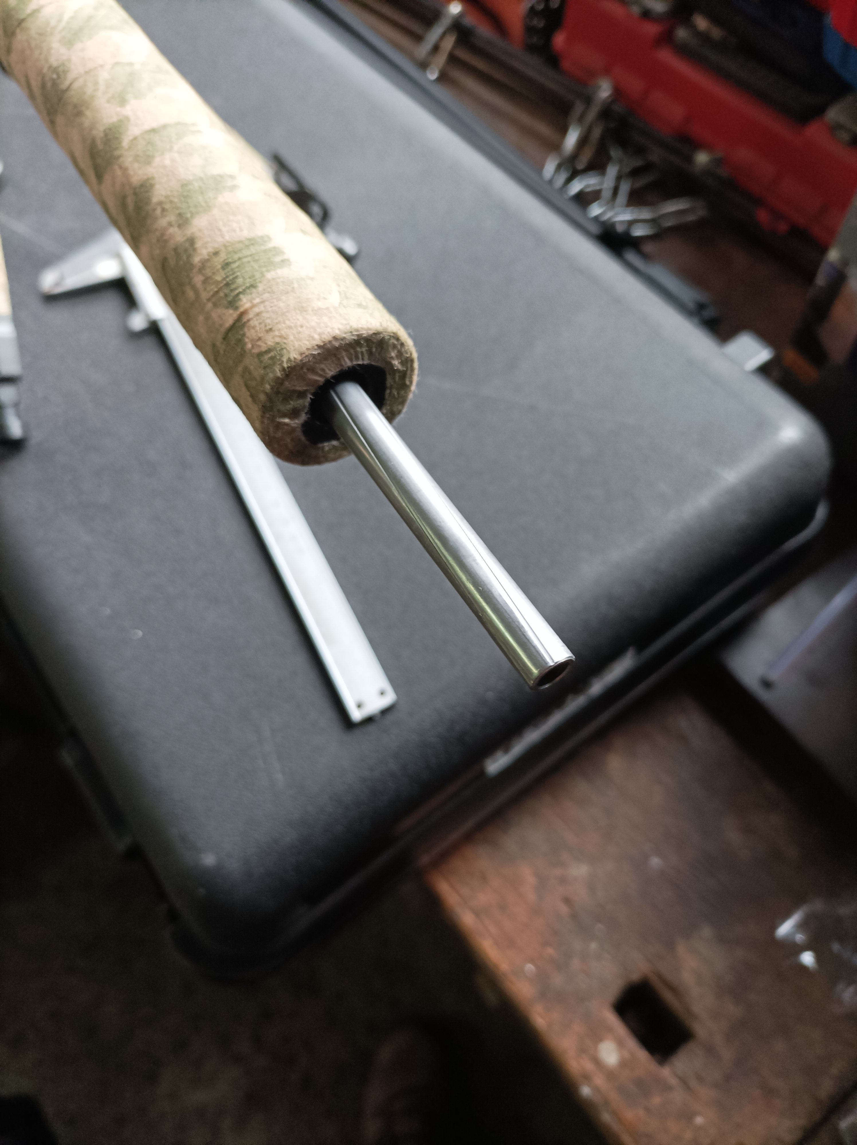

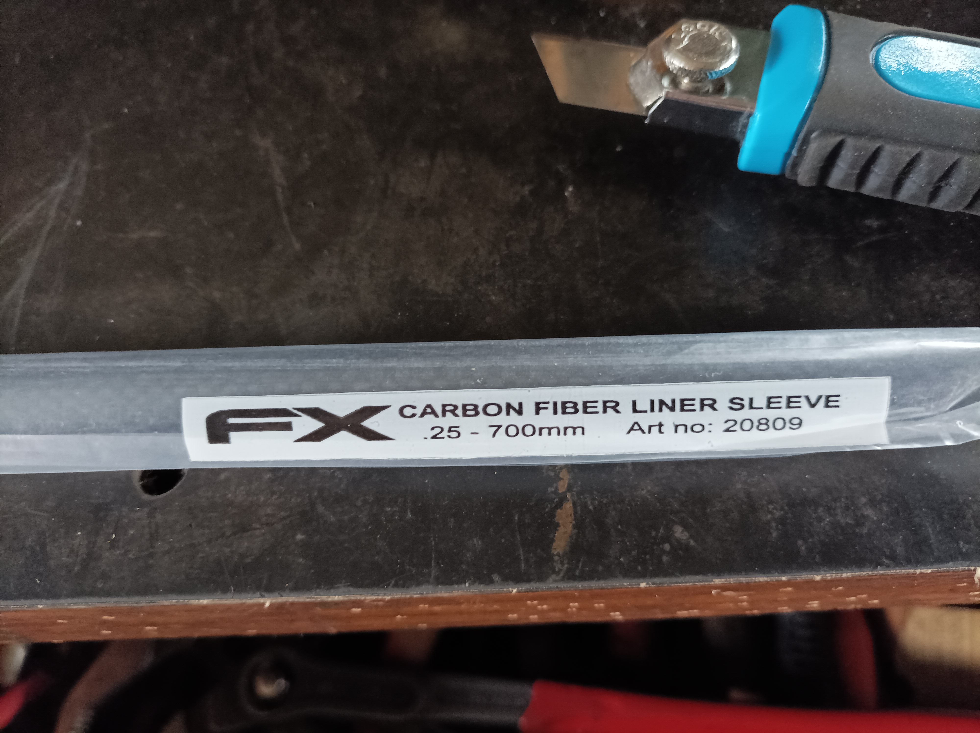

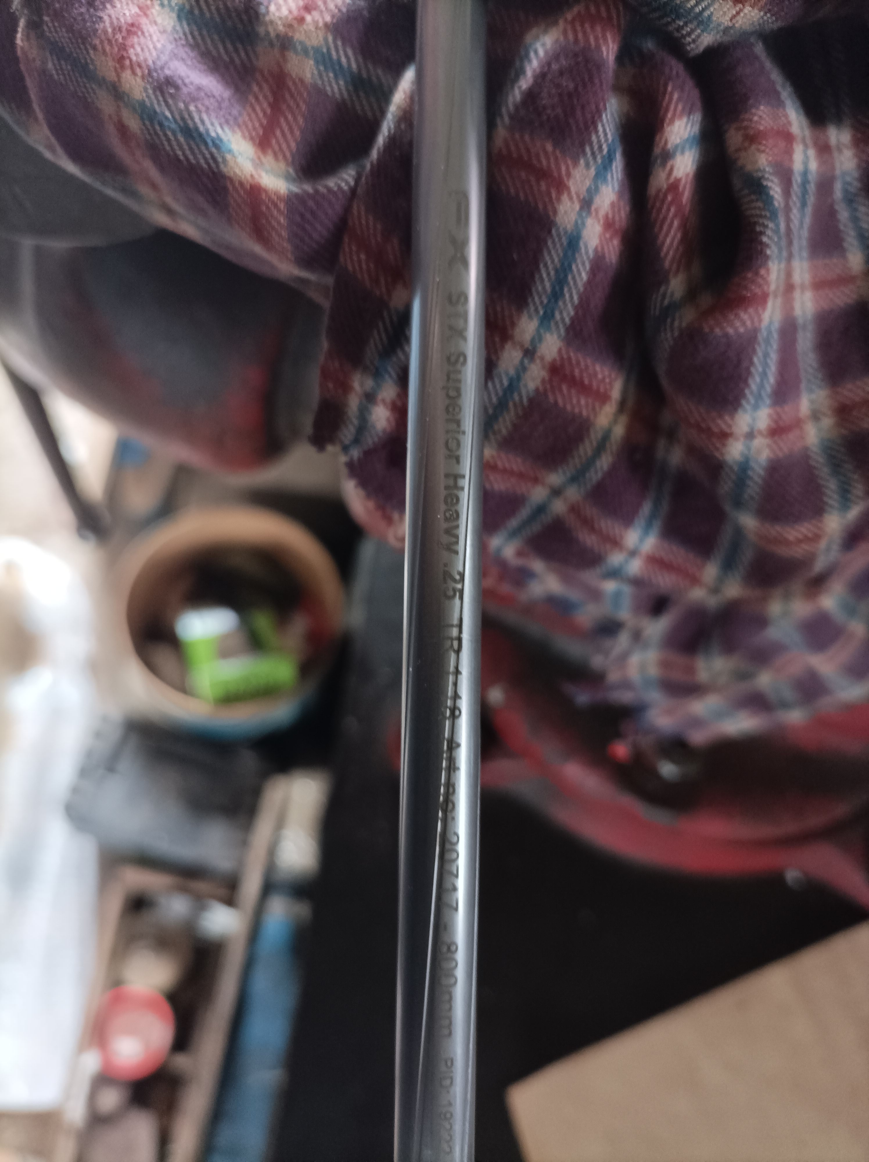

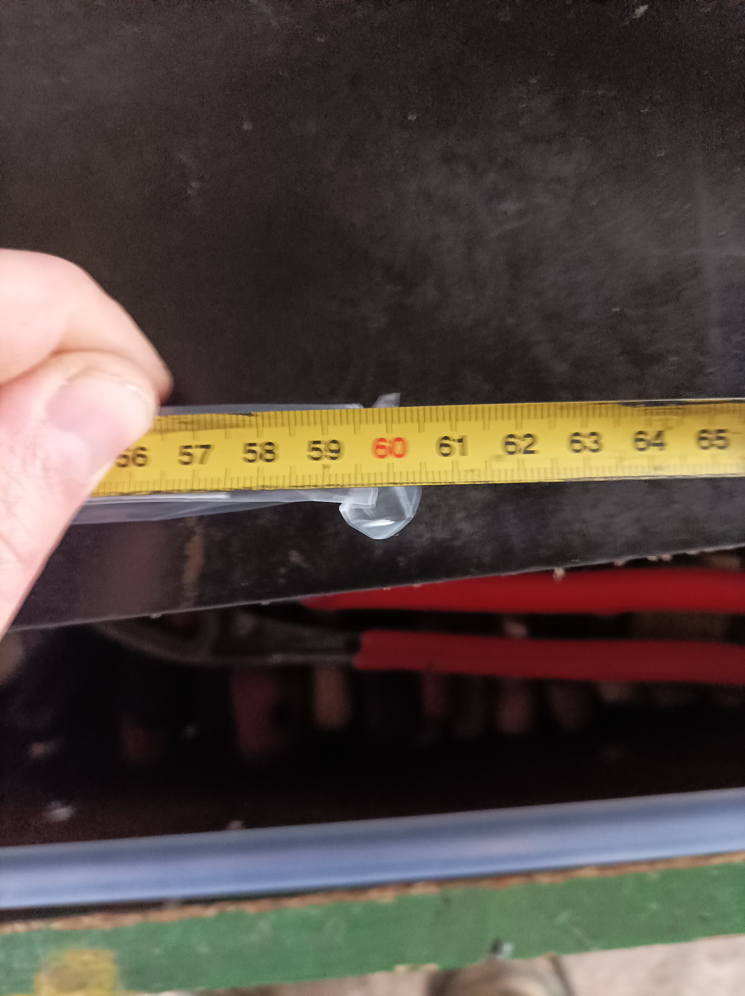

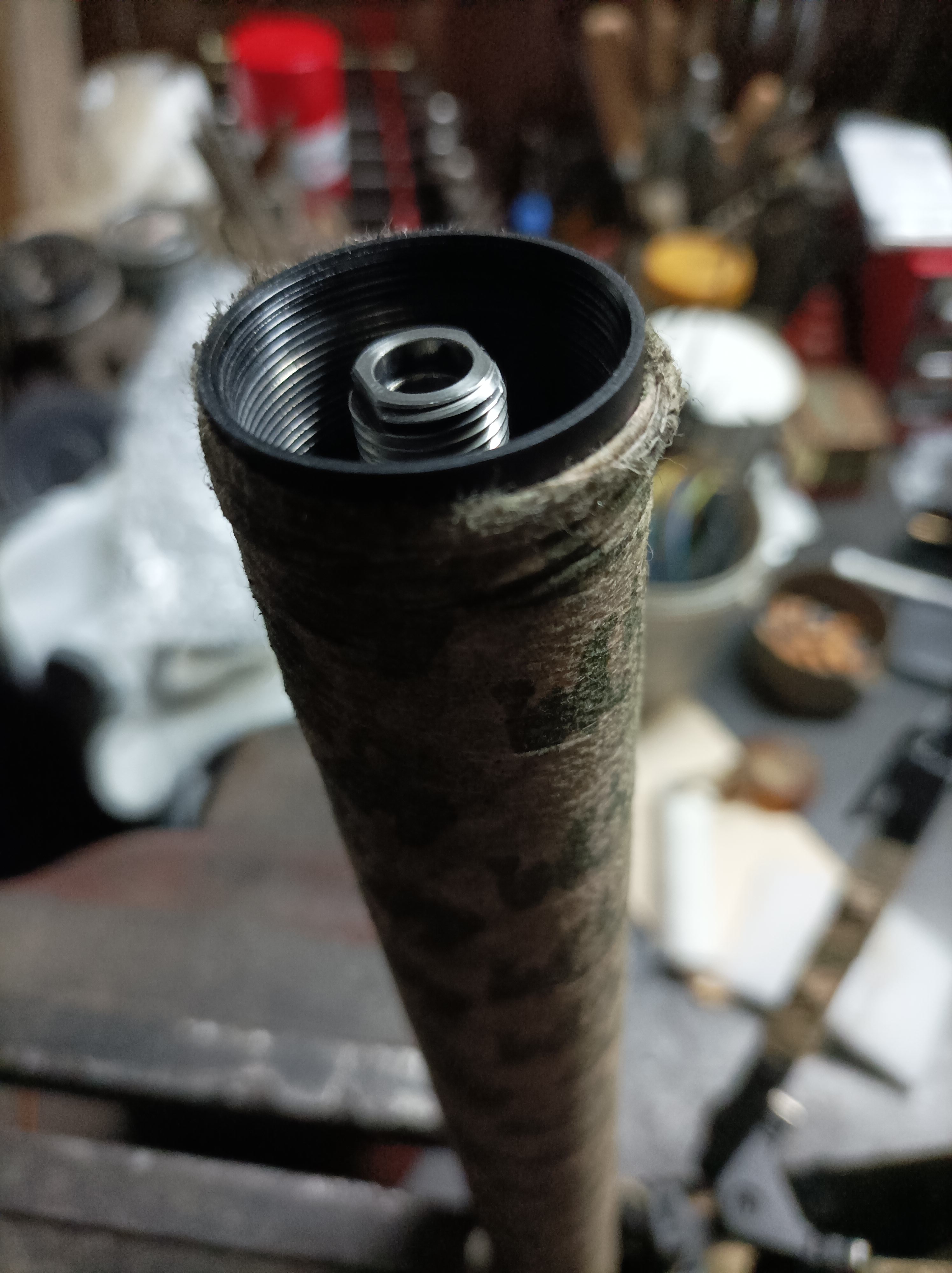

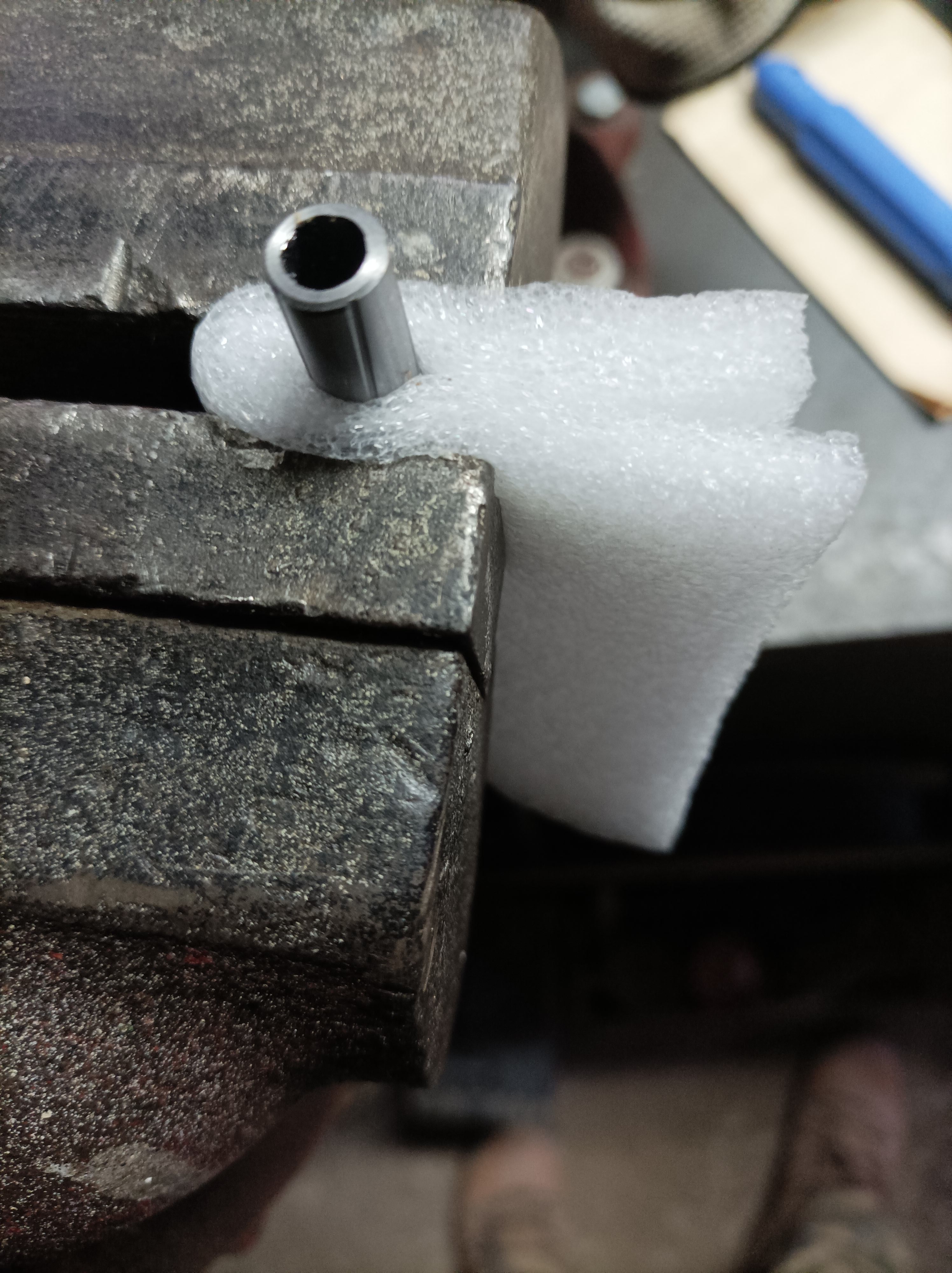

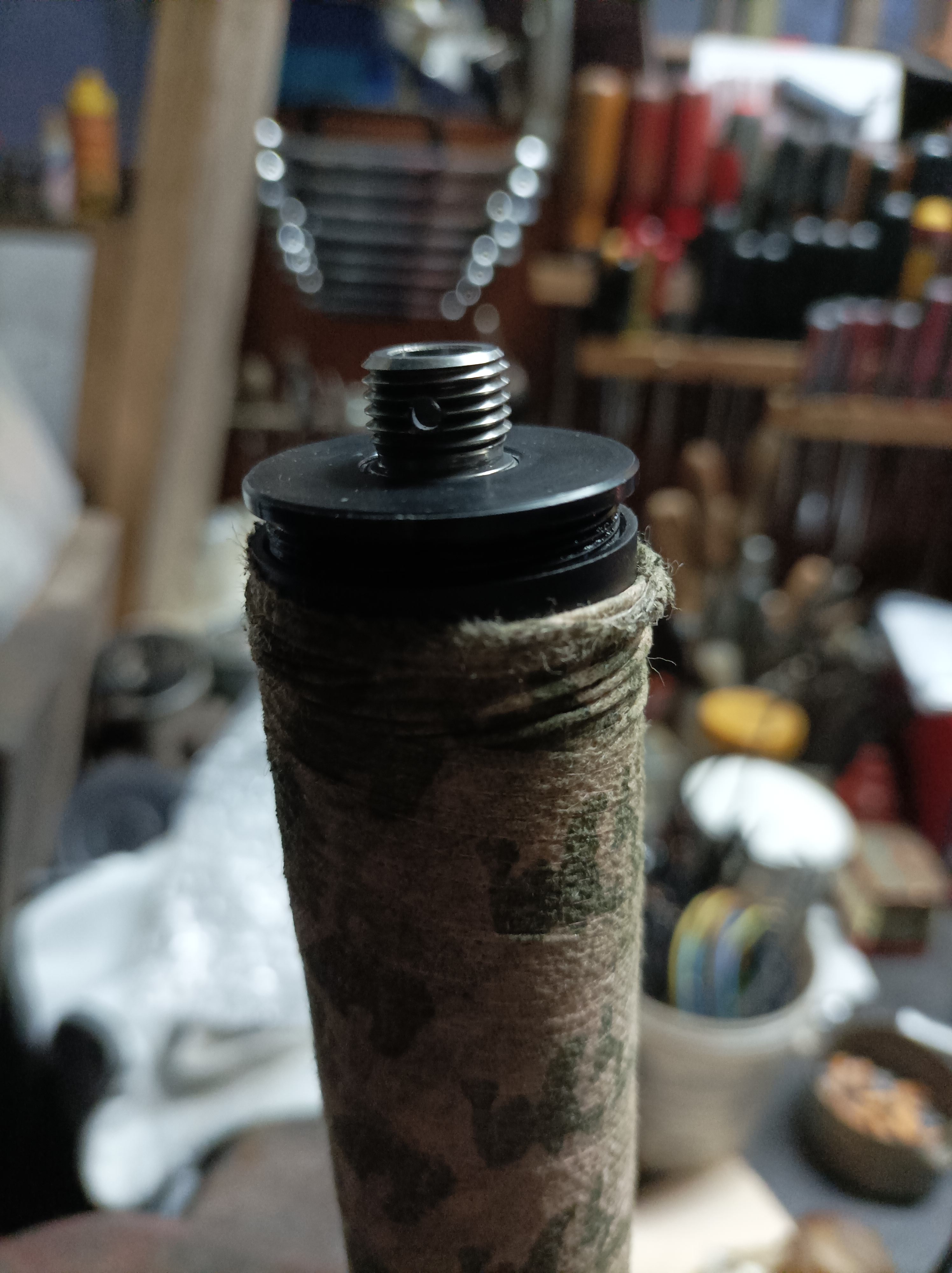

so the liner arrived. first impressions see photo new liner is 1:18 800 mm so no 1:16 therefore disappointing. the second impression regarding the carbon sheath 700, the length is not 700, but only see the photo. so I got to work and invented and measured and created see photo. a test was also done by pulling the slug through the liner, the finding is that the 800 liner has a soft chock that started 75mm from the muzzle. I measured the original liner only 693 mm instead of 700. I shortened the new liner to 720mm, made a recrown and tried to measure the speed again, see the photo, the first part in the photo is the speed with the original liner 1:16 hard chock, the last two speeds shortened 1:18 without chock. I will still make minor adjustments. and especially the accuracy test at 125m IMG_20231124_120639.jpgIMG_20231124_121557.jpgIMG_20231124_121632.jpgIMG_20231124_121736.jpgIMG_20231124_134906.jpgIMG_20231124_151656.jpgIMG_20231124_160440.jpgIMG_20231124_161029.jpgIMG_20231124_161934.jpgIMG_20231124_161958.jpg

so the liner arrived. first impressions see photo new liner is 1:18 800 mm so no 1:16 therefore disappointing. the second impression regarding the carbon sheath 700, the length is not 700, but only see the photo. so I got to work and invented and measured and created see photo. a test was also done by pulling the slug through the liner, the finding is that the 800 liner has a soft chock that started 75mm from the muzzle. I measured the original liner only 693 mm instead of 700. I shortened the new liner to 720mm, made a recrown and tried to measure the speed again, see the photo, the first part in the photo is the speed with the original liner 1:16 hard chock, the last two speeds shortened 1:18 without chock. I will still make minor adjustments. and especially the accuracy test at 125mView attachment 409179View attachment 409181View attachment 409180View attachment 409182View attachment 409178View attachment 409185View attachment 409187View attachment 409183View attachment 409184View attachment 409186
