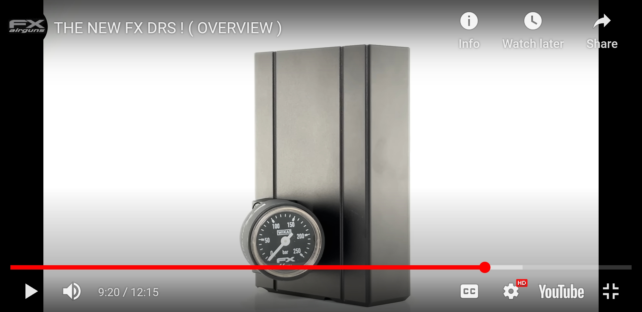

Yep if you look at the schematic drawing of the DRS you will Se that the large plentum has a plug in the bottom. No doubt for a gauge. That way the action can be lifted from the stock with no interference from the gauge. The smaller plentum has a plug in the front so if a gauge is attached to the front it won’t be visible unless the action is removed from the stock. And there will have to be material removed to allow the gauge to be fit in the stock. It’s just one screw to remove the stock so that wouldn’t be so bad as you have to remove the stock to adjust the HS also. I still like my idea of a block added to the front hole on the plentum that incorporates more volume plus has a gauge mounted face downward . That way the stock can be inletted so the gauge is visible and flush with the forearm. It will be interesting to see the difference in volume between the standard plentum and the Pro version. Now what would really be cool if a ball valve could be incorporated to turn between the standard plentum to the additional volume with gauge. Sort of like a high / low power wheel. i know more added cost to the gun but it would be cool.
The video clearly states and shows the option of a buy later reg Gauge on the plenum!
I wonder if you will have to remove the gauge from the plentum to take the action out of the stock to change the reg preasure or hammer spring. That would be a degas and re-gas too. Hopefully the Pro stock has access to the hammer spring.
I can tell you for sure that will be the case. The added width of the gauge looks to be wider than the actual stock. But I would assume removing the plenum from the bottom first would be easier.
Haha i had not thought about that either,,,,,, constantly on the back wheel here in regard to the DRS.
You probably have to do just that, though with the big plenum you can probably slide enough up and out of the stock to reach the REG and HS adjusters.

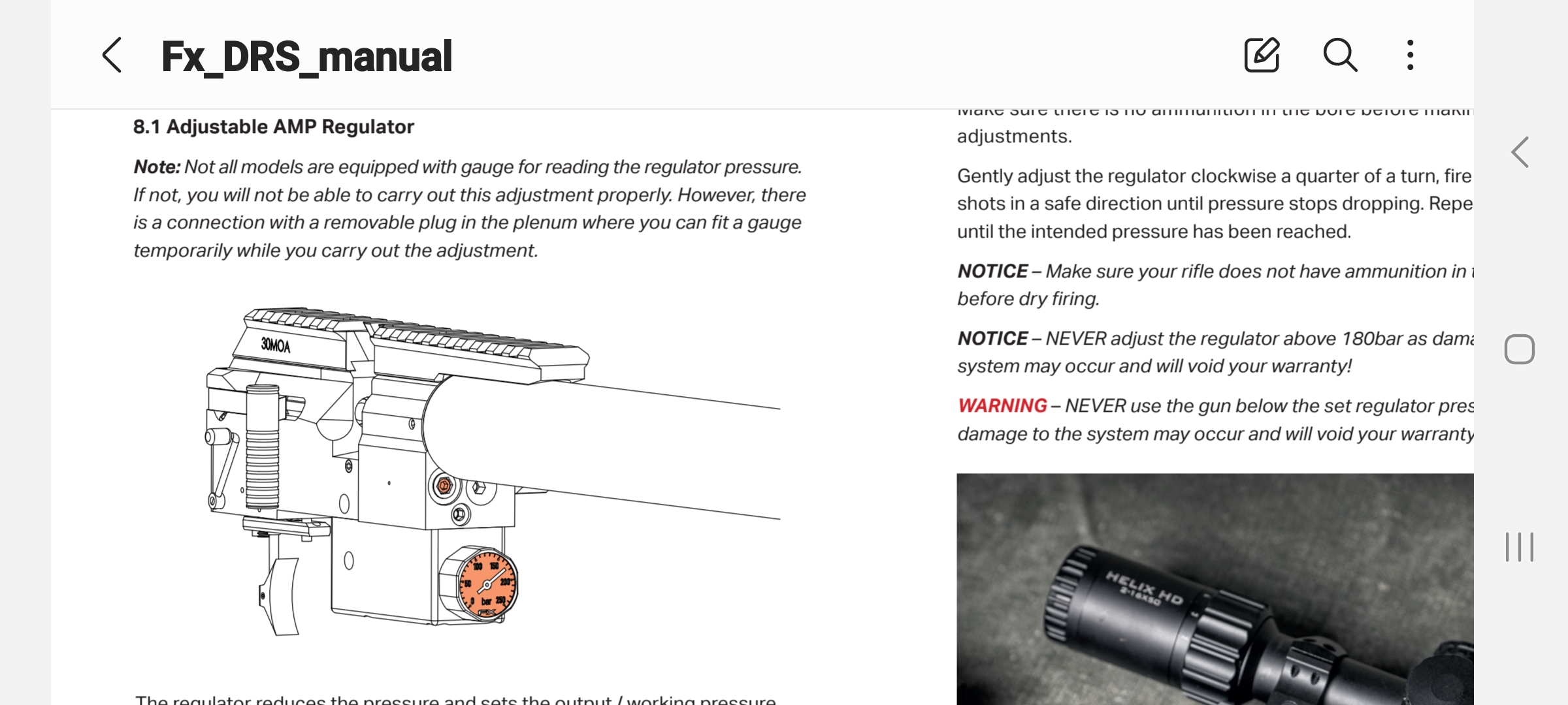

These instructions leave a lot unanswered instructions. Such as how to degas the system to install a gauge on the plentum Or,change to another size plentum? For the newbie I would think that this should be included. Yes there will be UT videos but why not have them in the instruction manual? After all first thing the manual says is to determine what the regulator and hammer spring settings are. That means you got to know how to degas the plentum to install a gauge and don’t you need to degas the tank first? Nothing stated in the owners manual Except do not disassemble this rifle. Piss poor manual FX.
