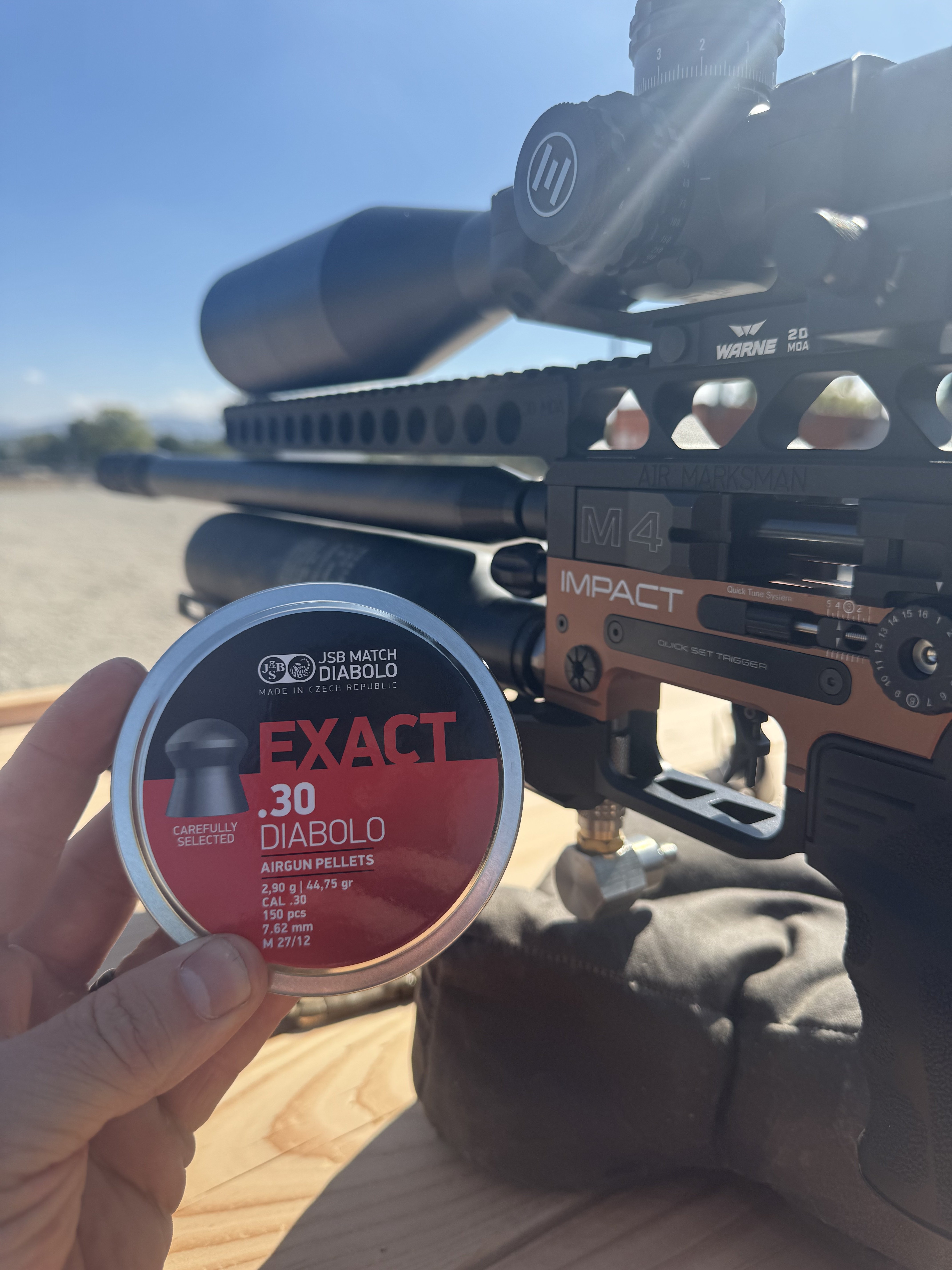

Just got my new FX impact M4 and started shooting for the first time…. Had some questions you guys might be able to answer
Gun specs
FX M4 700 .30
JSB diabolo exact .30 44.75gr
Questions:
1. When the gun is uncocked I can barely turn the fine adjustment screw up or down it is crazy stiff and takes all the effort I can to move it…. The macro adjustment moves fine and the setting it around 4 and still hard to move the micro
2. I notice shoot g the .30 pellets that they shoot pretty consistent around 900-905 but if I wait about 30-60 seconds in between shots the FPS hits down to like 880-890
3. What do you guys prefer to zero your scope at right now it’s at 35 but not sure if that is good or not
4. What FPS do you shoot .30 pellets at usually

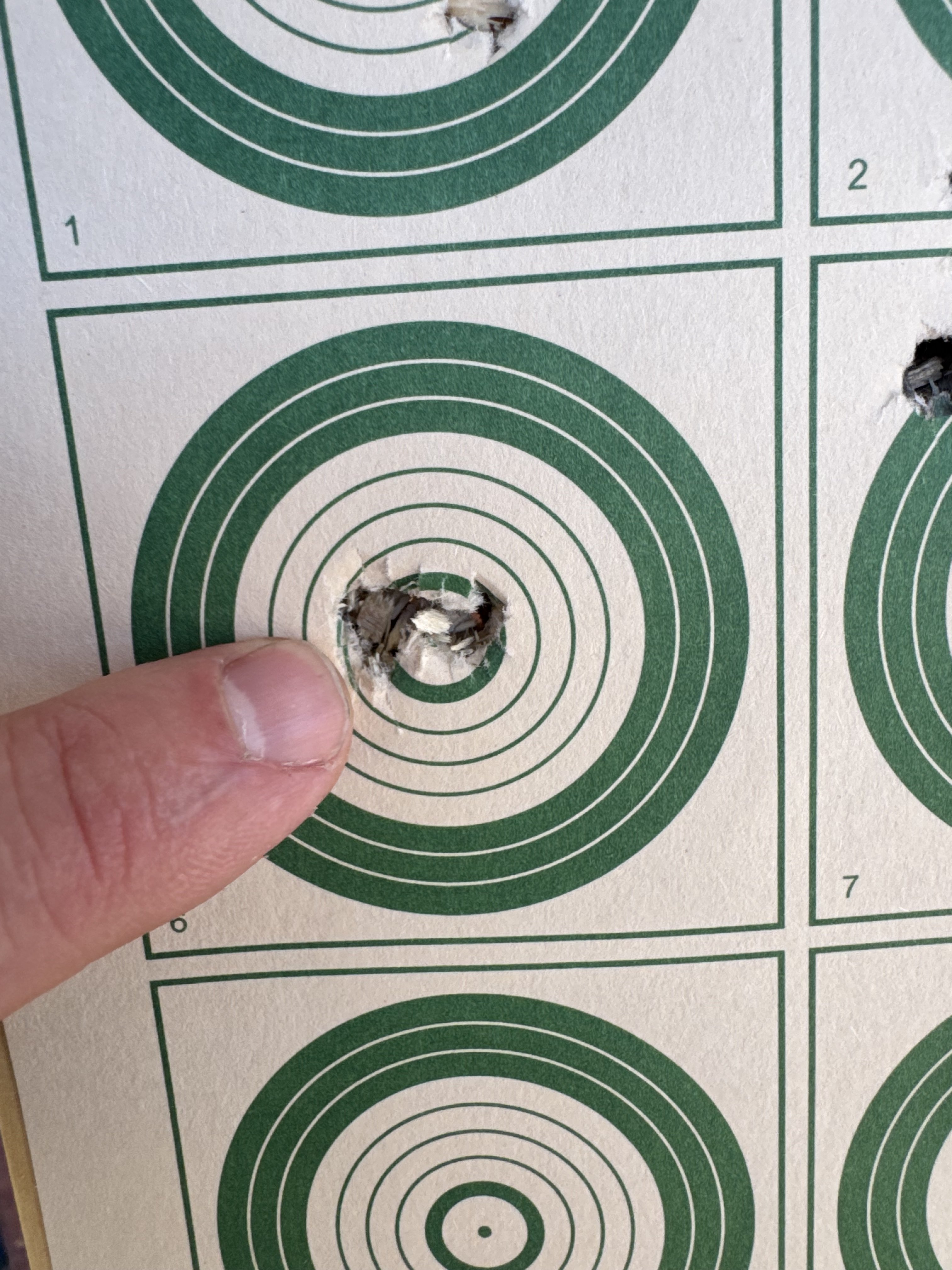

This is the 35 meter group after some tuning
You can only adjust the gun when it's not cock. If it's hard it needs break in. As for lower shots, that is normal for the impact. Mine will get about 20-30 fps slower till it goes back to normal. I own the .25 cal and I shoot it around 930 fps. With pellets anything from 880 to 950 should be good. You do not need to go 1000 fps cause you see youtubers doing it. I zero my gun 50 yards.
Sounds like the reg is taking time to refresh such that a quick follow up shot is at a lower pressure. It should break in but your tune needs to be a bit more resistant to that effect. A digital gauge would give you a sense of the refresh time. Clicking up on the micro should reduce the difference in speed by getting the hammer nearer to the plateau where pressure change is less influential.

the Micro wheel is quite stiff when it's brand new, mine was like that as well, note down where the stock setting is at, then use your thumb to push it all the way up (max at 4.5 before it get real stiff), then all the way back down, roll it a few times, going to take some time to break in, if you want to speed up the process you could use a tooth pick to apply tiny bit of lithium grease on the thread that the micro wheel was riding on.
Same goes for your velocity shift, brand new gun take some time for the valve, hammer spring and reg to break in and stabilize.
Zeroing the scope is really depending on what is the max distance you most often shoot at, usually half of it is a good middle ground. Personally, i used mine in close quarter backyard pesting and plinking. example: absolutely make no sense for me to zero it for 40 yard or even 30 yard when the gun would spend 99% of the time shooting at 20 yard.
