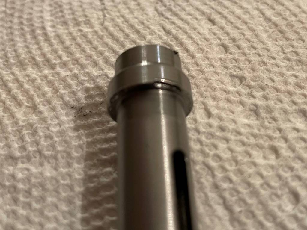

Last night I put different scope mounts on and realigned the scope. I also removed the power adjuster wheel and pulled out the spring seat cup and measured how far out the cup point grub screw was for a reference. It was at 4.6 mm. Then I removed the screw that presses the plastic/nylon piece against the cup point grub screw to keep it from freely turning. I applied a drop of blue Loctite to that screw and reinstalled and tightened it. I did this as a prevention because of hearing about that screw coming loose then allowing the cup point grub screw to move freely while shooting and changing the velocity.
With these changes I set up the chronograph and went back to shooting at 25 yards so I could zero the scope again. My velocities where all over the place. 650 fps to 871 fps and everything in between shooting the JSB 50.15 grain pellet. I then took the power wheel adjuster off again and remove the spring seat cup to check it. The cup point grub screw was still at 4.6mm so it had not moved. Everything seemed Okay so I put it all back together and tried it again and got the same results. Since I had not done so yet I then went through the process of checking both regulators. The first regulator is set to a strong 150 bar and the second regulator is set 110-115ish bar. Not a lot of resolution on that gauge. But in either case I thought this should be Okay to start or at least be giving me far better results than I’m currently seeing.
